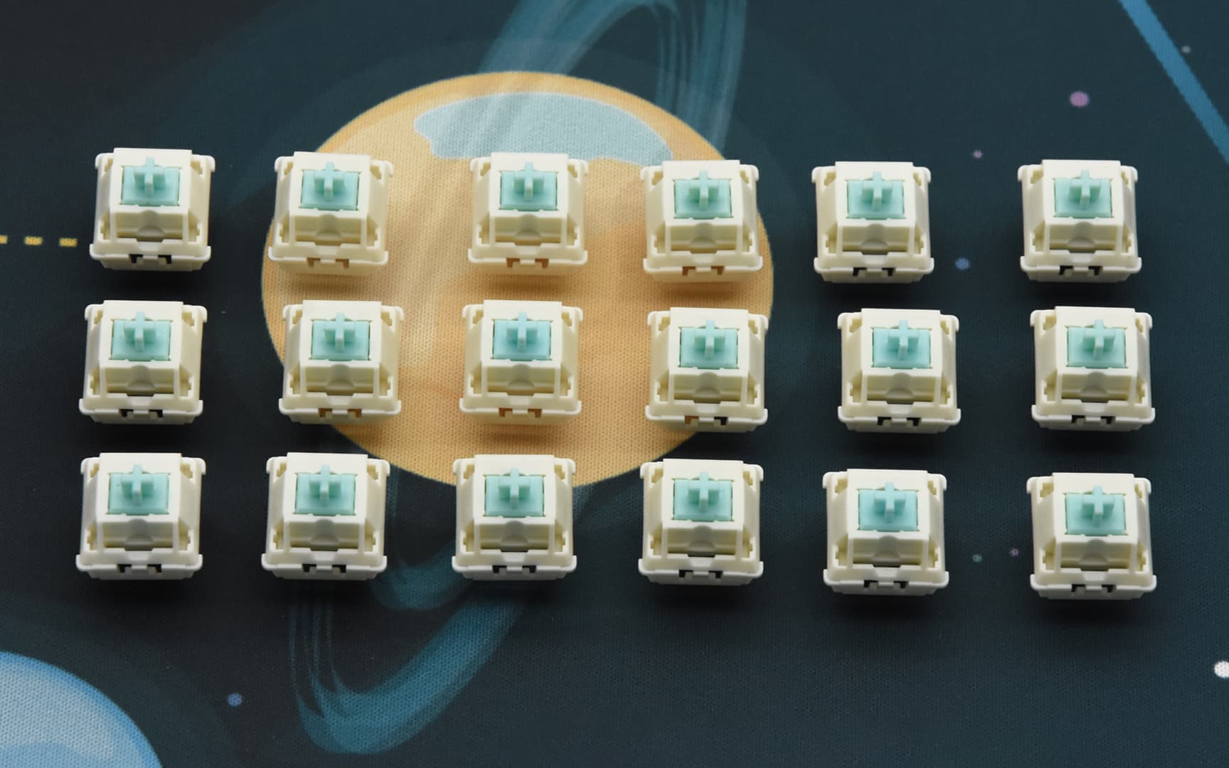

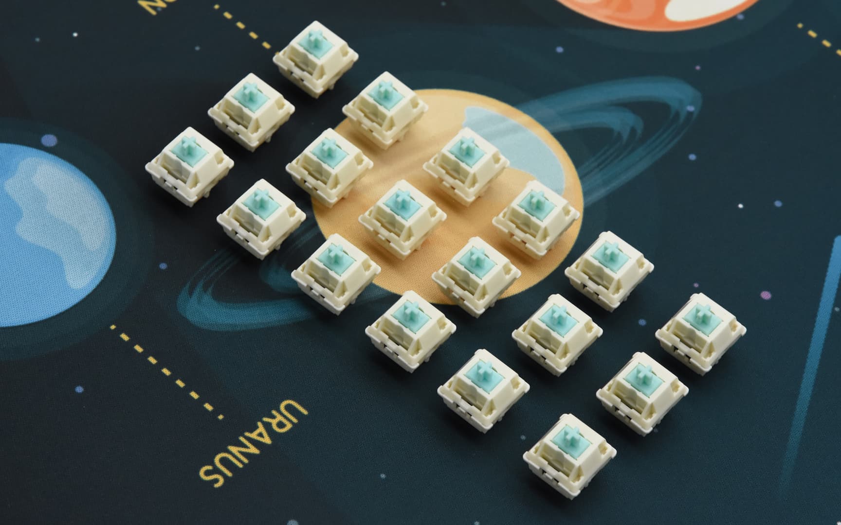

Switch type: Linear
Manufacturer: BSUN/YOK
Stem material: Modified LY
Top and Bottom Housings: POK
Operating Force: 45g
Bottom-out Force: 52g
Pre-travel: 1.6mm
Total Travel: 3.5mm
Factory Lubed: 205 and 105 mix on housing sliders. Dry film lube on the sliders of the stem and on the spring.

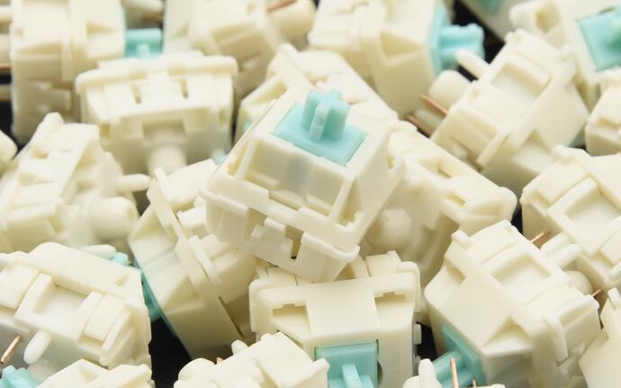

Why is the X Switch Unique?
What is so unique about the X switch is its choice of materials. I believe none of you have tried a switch that uses POK as both the top and bottom housing materials. The POK material is uncommon as it just has been introduced to the market by BSUN and JWK. The POK material’s full name is polyketone. Its coefficient of friction is 0.04 which is only higher than LY (0.03) making it the top 2 smoothest material used to make switches. It is also super durable as its wear resistance is 14 times stronger than POM. Its shock resistance is 2.3 times better than Nylon and 1.4 times better than POM. I don’t want to bore you with the statistics, so in conclusion, the POK material makes the switch smooth, clacky, and durable.
The LY stem is fairly new but not uncommon. In recent months, we see LY material being used frequently on JWK switches. LY is known for its smoothness and the high-pitched sound signature that it creates. The most well-known switch with an LY stem is probably the SOTC switch which I believe some of you have already tried. However, the LY material used to manufacture the X Switch is modified to make it even more smooth than the usual version. The design idea behind the choice of materials is to make the switch as smooth as possible, and I will leave it to you to decide if that has been achieved.
The combination of the POK and LY materials is supposed to make the X switch one of the smoothest switches. The precise factory lube application from BSUN ensures that you can use it directly after purchase.
