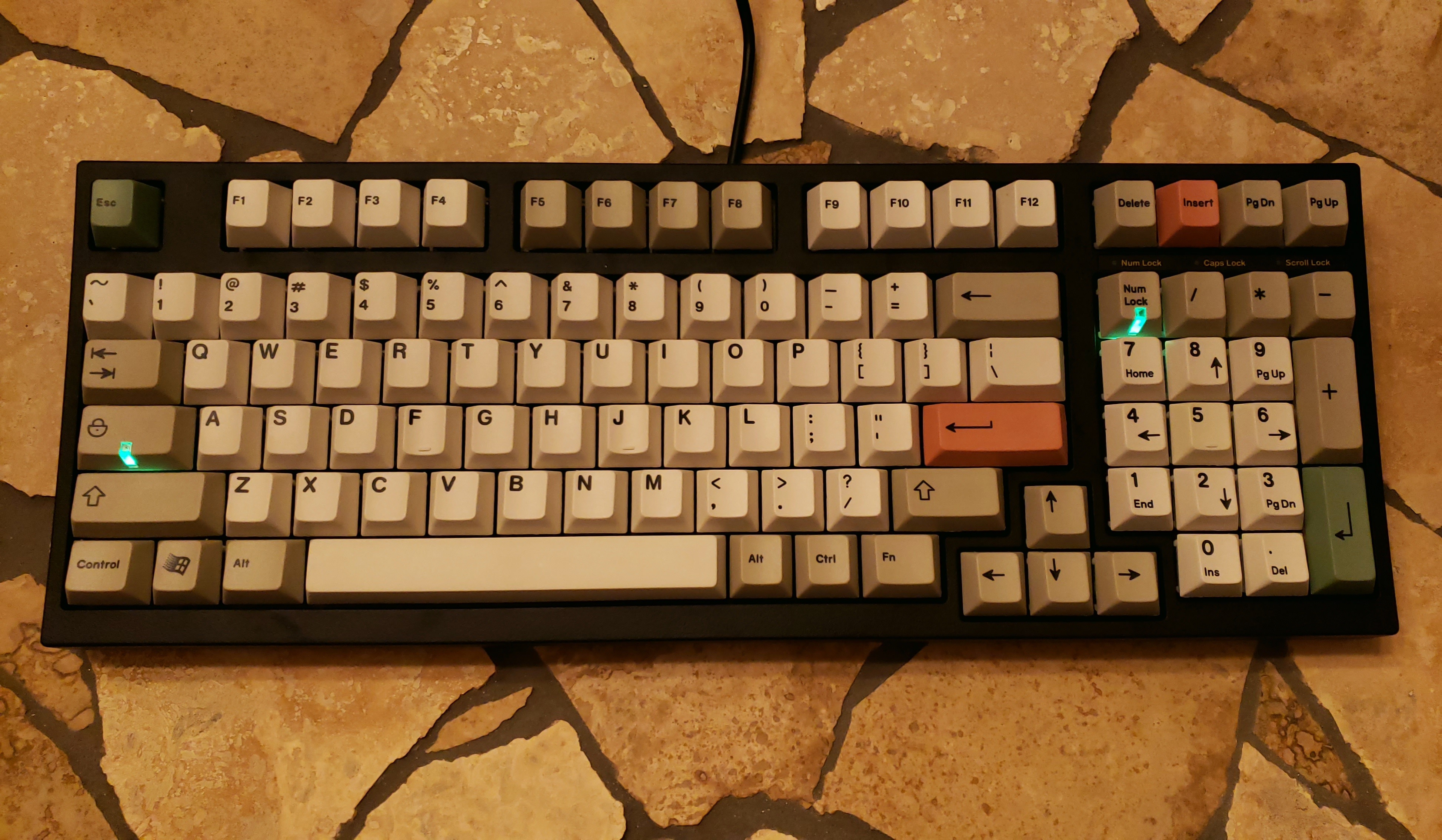

I have a hasu installed on mine: it is the exact same footprint as the stock controller.
Epbt 9009, Invyr housings with T1 stems, mkultra foam, and i even epoxied the already fabulous leopold stabs to the plate for that extra refined feel on the stabilized keys. She is ready for her Heavy-9 case!
did you solder on those green leds?
Yes I did. The FC980M PCB (without any alterations) accepts in-switch LEDs for lock keys. I simply desolder the status bar LEDs and solder in in-switch LEDs.

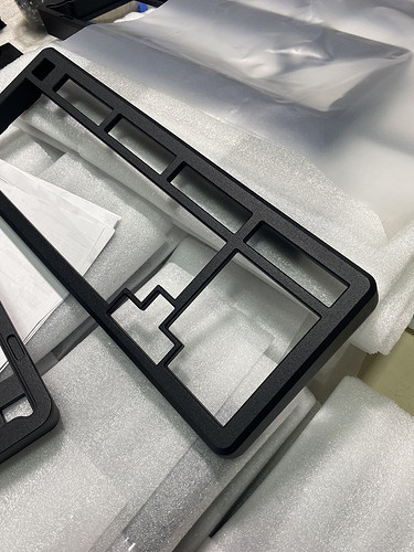

I had to switch the Black Wrinkle finishes to Enigma Black at the last minute to get best finish uniformity, and we’re getting all GB units ready to ship, so I’ve yanked all inventory for now. I may have a few spares after everything has shipped. If so, I’ll put them back into inventory; they would be Enigma Black. But I’ll need to shoot new photos to more accurately represent the finish. FWIW, Enigma Black and Royal Wrinkle look identical from a few feet away. They’re the same level of gloss (i.e., very matte) and color. The patterning of the texture is just slightly different on close inspection.
Backstory: though the sample appeared fine with Royal Wrinkle, the factory was having trouble getting fully uniform patterning of the wrinkle across the parts. The last time I had an issue like this with this shop, getting the parts stripped and refinished added like eight months to the production time (admittedly, some of that COVID-related delays), so I decided better to switch to a more proven/reliable texture like Enigma that would be done in one day rather than to make people wait an indeterminate additional multi-month amount of time while the factory experiments and debugs the issue. If you were affected by texture change, you would have gotten an email from me asking how you’d like to proceed, and (of course) being given the option to choose a refund instead. Most people have replied now and said that they’re cool with the change.
In short, though @arcticarc, I should have a black one available for you if you’re OK with the Enigma finish. (You can just email me.) It looks like the below—basically just a black version of K2.
