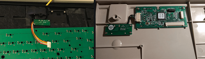

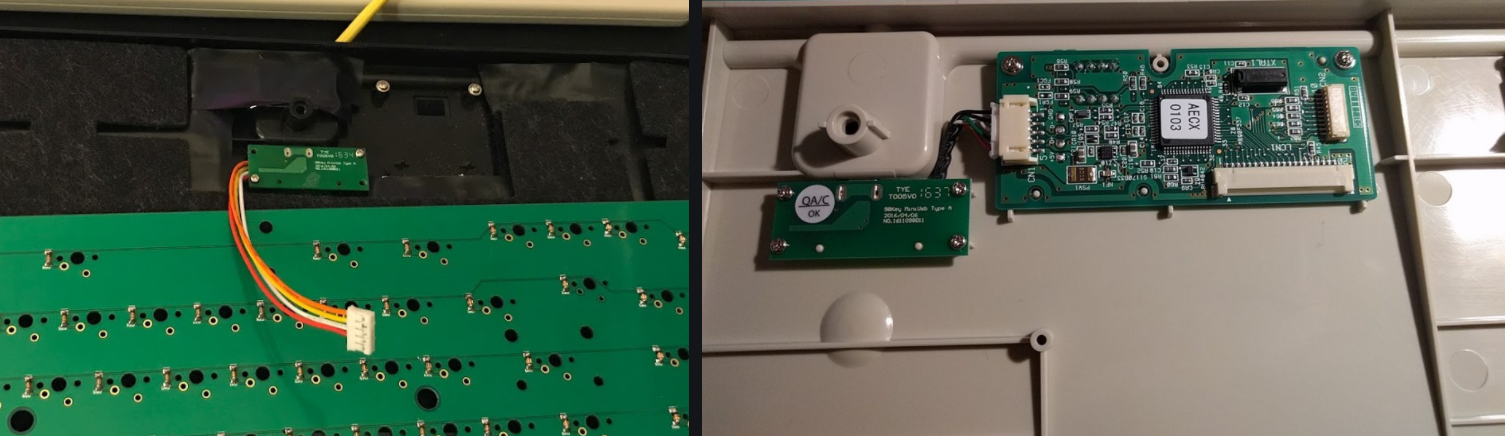

And we’re fairly sure the 980M will not fit in this case? I know that 660m/660c are quite different but, looking at pictures online of plate and daughterboard placement, 980m and 980c are quite similar.
(980c is on right)

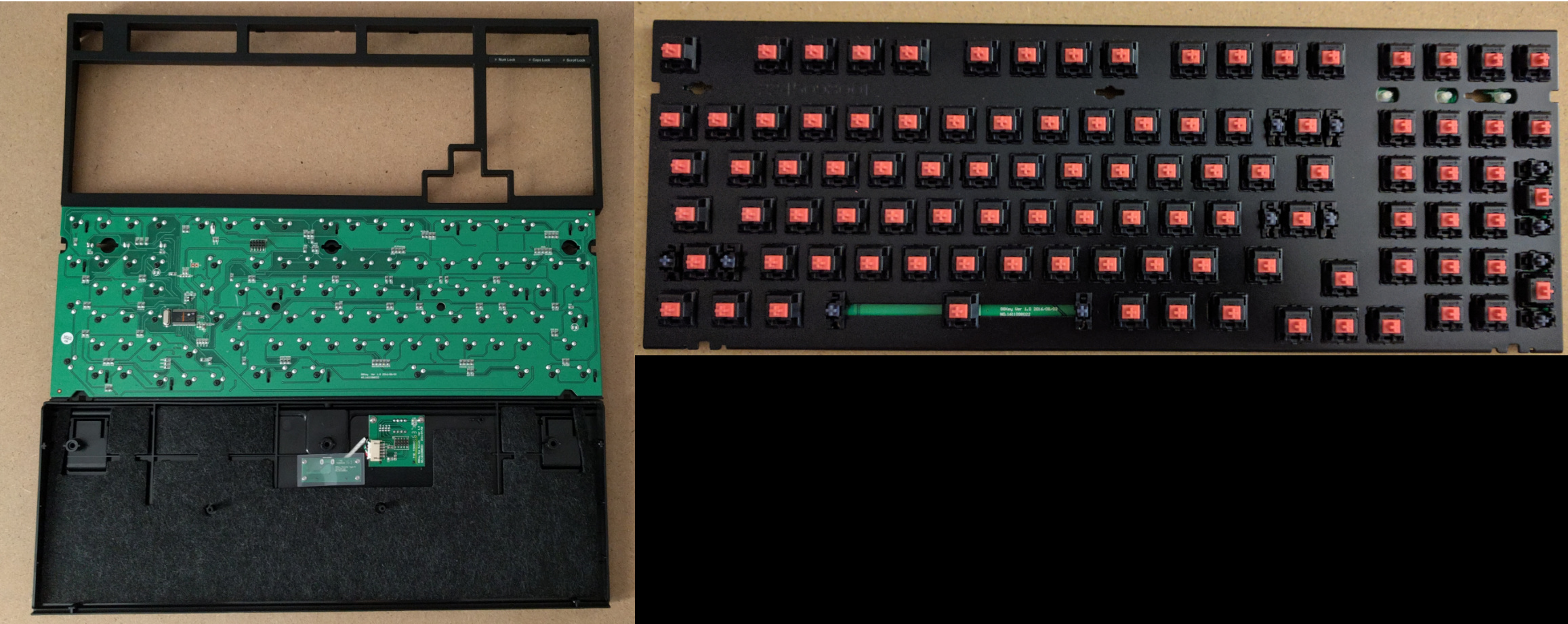

@jhambone9190 Re the FC980M, let me closer into this. Anybody have any better pictures of the switch plate on an FC980M? If it looks plausible, I’m happy to order an FC980M to test, but I assumed from having done with the the FC660M that it would be a dead end. Maybe this one is a different situation.

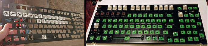

@norbauer Would be nice for some pictures actually for the purpose of verifying the outer dimensions of the plates are the same. In the interim, this pic is about the best i could find online of the plates.
Curious to hear what you think but it looks promising to me…

to increase the suspense, I found a couple more pictures of fc980m internals off geekhack. The exterior proportions of the plates look the same between 980c and 980m. I guess we will see soon enough.
Assuming the plates are interchangeable and the gods shine upon us, then the question will be if there is enough clearance for that weird socket board to plug into the PCB. If not then maybe a custom ribbon cable using crimped JST 2.0 and a little creativity may work.
Correct. Another deal breaker would be if those LED sit flush or below the plate or if they sit slightly proud (can’t tell from the photos). If the latter, it would be a deal-breaker, unless folks don’t mind de-soldering the LEDs.
