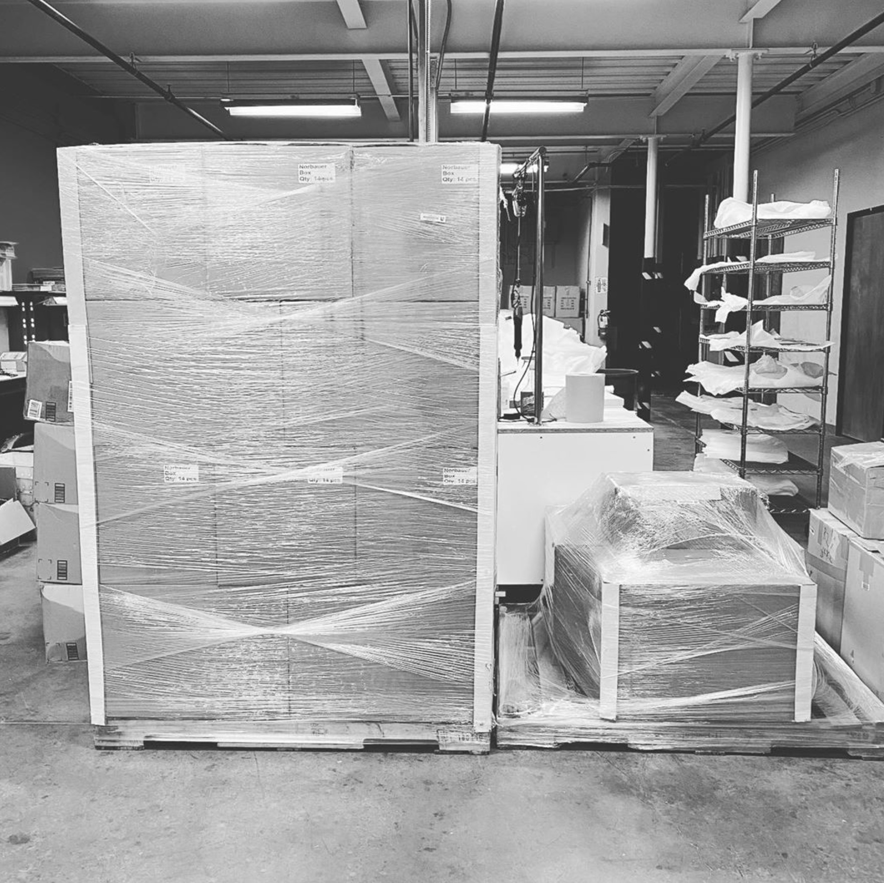

The packaging is done and has arrived, along with the breakout PCBs and hardware.
