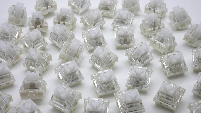

It was only a few reviews ago that I had mentioned I wanted to get ahold of the Geonworks Strike HE switches, and these rare, niche filling clicky Hall Effect style switches finally made it here. This is your deep dive review on these switches and perhaps some of the subtle things that set them apart from click bar switches you’ve tried before…

Much like the Glorious Raptor HE clicky switches that predate them, these too come across as a ‘filling out of options’ for their respective vendors rather than being novel or flagship designs for their switch lineups.
As a clicky guy, this is fine by me. If economies of scale end up meaning that higher-end PCBs mostly transition to being HE/TMR, then at least I will have switch options. Sensing technology just needs to be reliable and cost effective. I’d set them once to get the actuation point close to the click event, and move on with my day. Not that it will be too terribly difficult to hunt down Box Whites on future eBay and spring swap them, LOL (thanks, 8bitdo!)
Kailh Box Jades and Navies are fun switches, sure, but they also are incredibly aggressive in both how they sound and feel and I couldn’t imagine people typing on them regularly for any length of time as a result of such.
That hurts, Goat. That really hurts. :rofl:
Look, not all of us have muscles on our fingers!
I long ago gave up the hope of being able to type on heavy switches like that regularly, and combined with the fact that everything these days tends to be lighter and softer than the prime era of Kailh’s click bar clickies, I forget that there are still users out there who love so much. I do completely understand the love for them with respect to their sound though; There’s truly nothing that sounds like a Kailh Box Jade or Box Navy to this day.
You mentioned the wobble is consistent across the batch, with a little more E/W movement. Is it noticeable under keycaps during off-center presses? How would you describe the click-bar sound compared with a Box Jade or Navy in a built board?
Has anyone checked how consistently the magnetic signal changes through the travel? How does rapid trigger responsiveness compare in practice with conventional optical and other magnetic switches on comparable boards?
