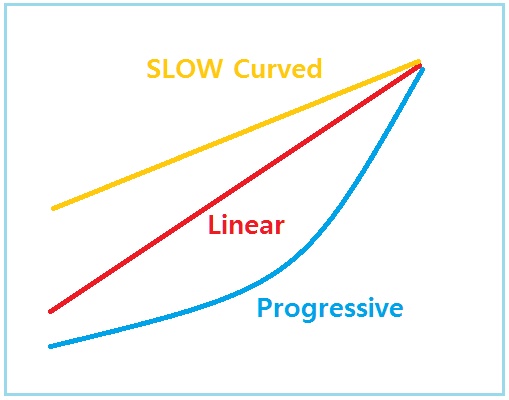

Makes sense to me - and it also reminds me of this …representation of a force curve graph about SPRiT “slow curve” springs:
The TTC gold pink linear on my tester is very light, but does also manage to feel pretty snappy - I wonder if that might be a result of a similarly “pre-loaded” spring.
From what I can glean from this, this will be a much heavier feeling switch.
The graph Deadeye posted for slow-curved…just make the origin point of the line higher up closer to the end force.
I don’t personally think I would be a fan of such a slight difference in forces in my travel. :man_shrugging:

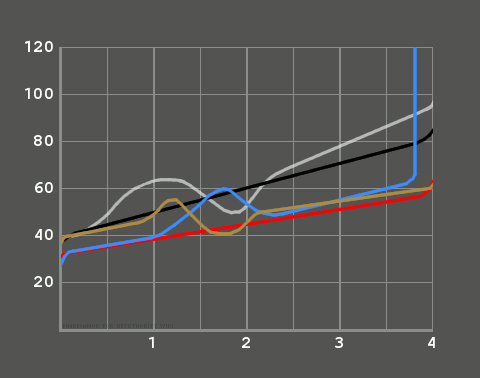

This suggests lower angle of force curve slope. This hobby is full of surprises so I’m not going to second-guess how that feels in use except to say it’d be counter-intuitive if that felt heavier than sharper slope.
By lower angle of force curve slope, I mean like the difference between MX Red and MX Black in this force curves of Cherry MX switches. Gray line is I think MX Clear.
cherry-force-curves
I just compared the feel of Tealios V2 against NK Dry Yellow and Cream (forgot I spring swapped Creams). Unless I’m imagining things, amount of force needed to press Tealios doesn’t seem to rise as fast as the other two.
