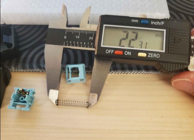

In that case you might try something like these KTTs, which are supposed to have 4mm travel. They aren’t as soft as Outemus but still have a good bit of cushion.

Oh hell yes!! I could try putting Halo stems and my TX Short 80/85g springs in the KTT Matcha Tactile housings… if my Holy Panda X Clears with 78g SPRiT springs in them sell on eBay, then I could turn that money toward this. Would it be worth it though? How much of a difference does the housing make?
Housing can make a lot of difference, and in at least three ways:
The leaf interacting with the stem produces tactility, so this can change how a stem feels
Housing material and the depth of the tube can affect sound, feel, and travel
For silents, some switches have dampening in the housings while others have it on the stem; IIRC, KTTs have it on the stem, so using Halo stems in a silent KTT housing would make for a “normal” non-silent switch

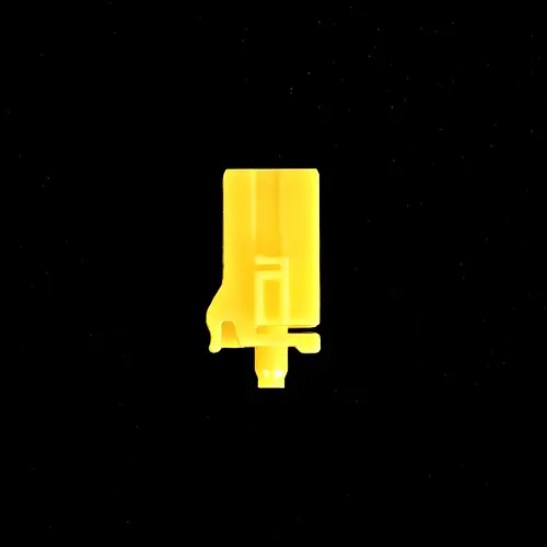

Sounds like Geon x Haimu Silent Yellows might be the play.
Slider has dampening “legs” cut into them making them silent but not mushy.
Ooooh um holy shit these look really good. Ill buy them as soon as I have money. Thank you!
