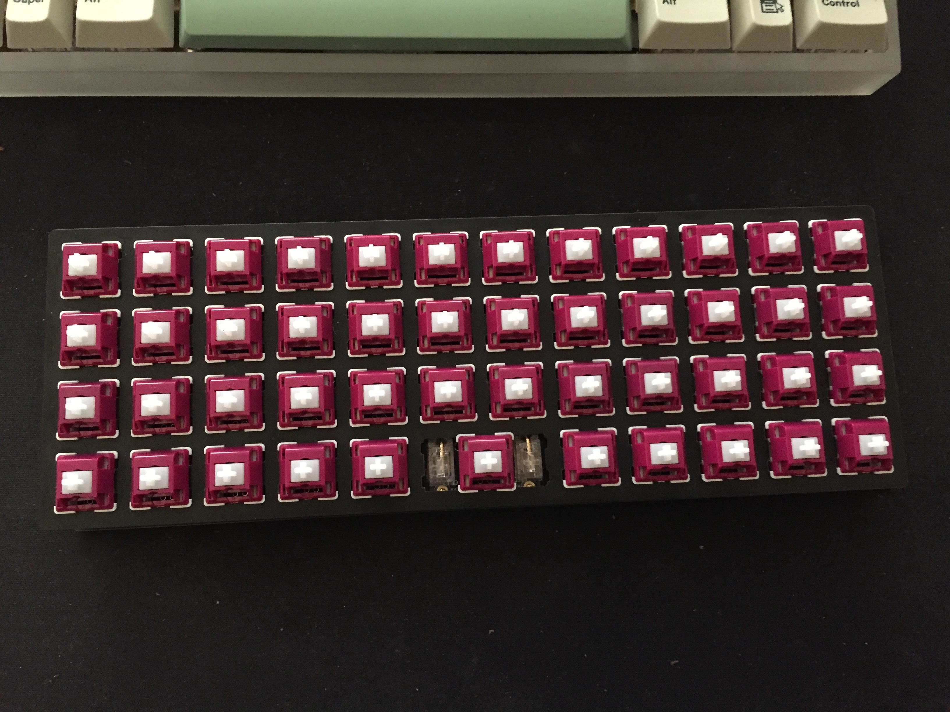

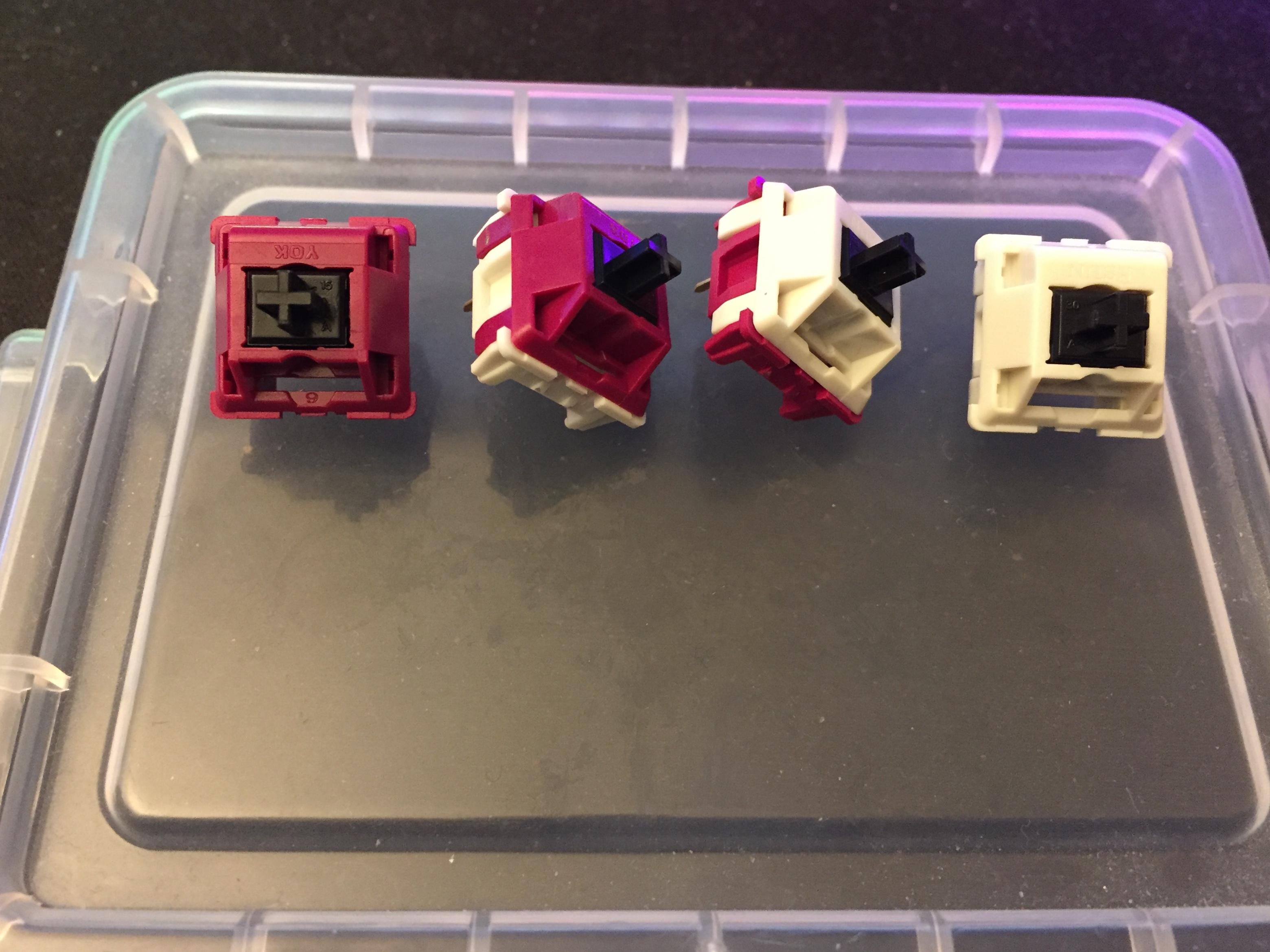

Do the GSUS sound deeper to you? They sound a bit deeper here to me. I just finished swapping and lubing my halos into Yok housing. I like them a lot

Those look pretty good

That looks awesome!
cool look, my dude. I don’t have any GSUS switches or I’d do the same.
That does look very cool. Almost a shame to put keycaps on.
Surprising thing is it feels even better than it looks. Lubed with TriboSys 3203 and every empty space in the case and between plate and case filled will Sorbathane, like it’s poured in.
Only problem is I’m not sure how I’m going to use this keyboard if my eyes rollback on every keystroke.
My Holy YOKs are being used and I love these things so far… next up, i’m giving them the full treatment: 3204, poly films, and new springs, baby!
Good luck with the films! I couldn’t get it into the plate with the films hahaha
More power to you, I hope they help… however… I am not sure films will benefit the YOKs since the YOK tops already fit so tightly on the bottoms, I will be surprised if films make any difference. Let us know!
