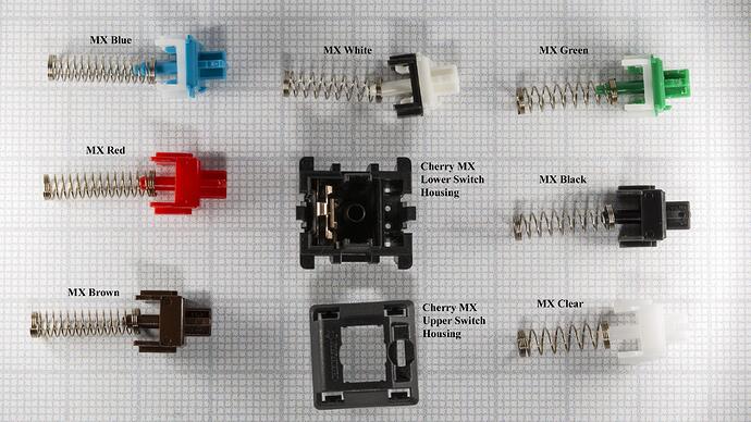

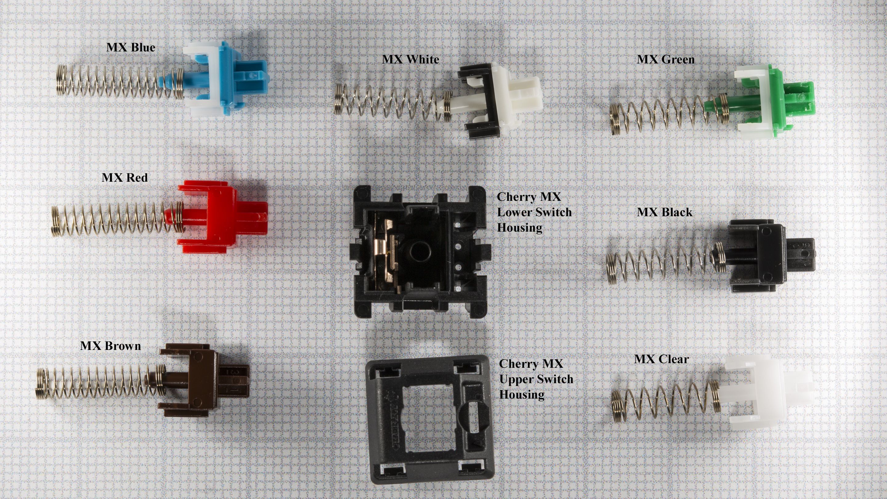

The thing that makes the Cherry MX Clear have a “progressive” force curve is that its spring is short and stiff. You can see it is the shortest of Cherry’s springs:
There’s no need for any nonlinearity: it’s just Hooke’s law. The overall steepness of the force curve comes from the stiffness of the spring; Clears have a stiff spring so their curve is steep, i.e. the bottom out force is a lot more than the activation force. The initial force to start pressing the key comes from how much the spring is compressed (preloaded) inside the switch. If the spring is not compressed at all the initial force would be zero, says Hooke. Preloading the spring moves the whole force curve higher, so greater force throughout the travel. Clears have short springs, so relatively little preload, and lower starting force.
