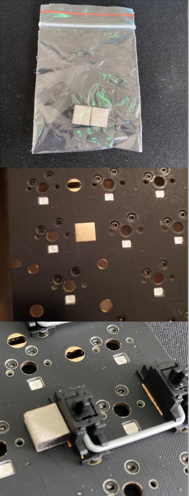

Did you install the two static pads that come with the board? I didn’t as I didn’t see my place for them, I’d say most people don’t use them either though… board can’t be this unreliable, surely there would be more of a fuss about it?!? I see they have brought t out a v3 now though… I think I will contact the seller but I bought it ages ago and only installed it recently…
I’m not sure what you’re referring to. I don’t think I’ve received any static pads.

From the kbd fans discord FAQ:
“Confused about what those little silver squares that came with your pcb are?
Those squares are grounding pads. You need to stick them onto the squares on the pcb to help prevent your pcb from shorting”
I can’t imagine this is the issue though… I thought there should be some metal contact areas where they should stick but I didn’t see any so I didn’t stick them on… maybe I should try them in case static is the problem…
