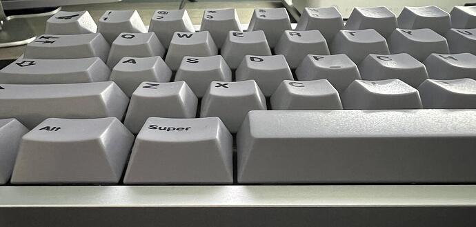

Trying to do a 60% build with cannon caps and wuque stabalizers. both the 7u and 6.25 space bars stick in a similar way as the video linked by OP.
I tried a GMK spacebar and a IFK spacebar and both worked fine immediately. Should we just return these cannon caps or is there something that can be done? if the stabs are basically not screwed in, the cannon caps 6.25 bar works OKAY but I don’t feel great about that.
I had this same issue with their Black on Grey set. I noticed their spacebars are a bit taller than others, which made some keyboard shortcuts a tad cumbersome as the side of my fingers would end up colliding with the edge of the spacebar. I ended up ditching my intended Tsangan build for ANSI which only worked out because the 6.25 had slightly better tolerances, slightly.
It might be just how they do spacebars, they might not work outside certain conditions. Ugh.
