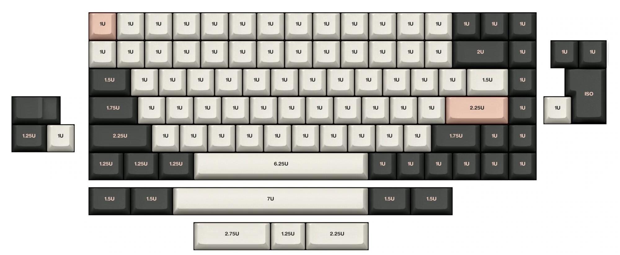

I would recommend buying directly from kbdfans. Is there something this layout doesn’t cover or were you trying to make a specific plate material?
KBDfans plate supported layouts.

I already have a 75 pcb that would fit in the kbd75 case but it has an uncommon key layout that kbdfans doesn’t support on their plates, but thanks for the suggestion
