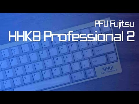

Unsilenced Topre switches sound quite nice on the integrated ABS plate. Probably mutes things a bit. I’d go for unsilenced if you want to experiment something new.
Only downside is that if you decide to silence them you’ll lose some travel distance as non silenced sliders don’t have their height adapted for silencing rings.
Here’s a soundtest of my old Pro 2 unsilenced and lubed with 3204.
That’s it! That’s the HHKB sound I love.
Awesome, thank you for sharing!
