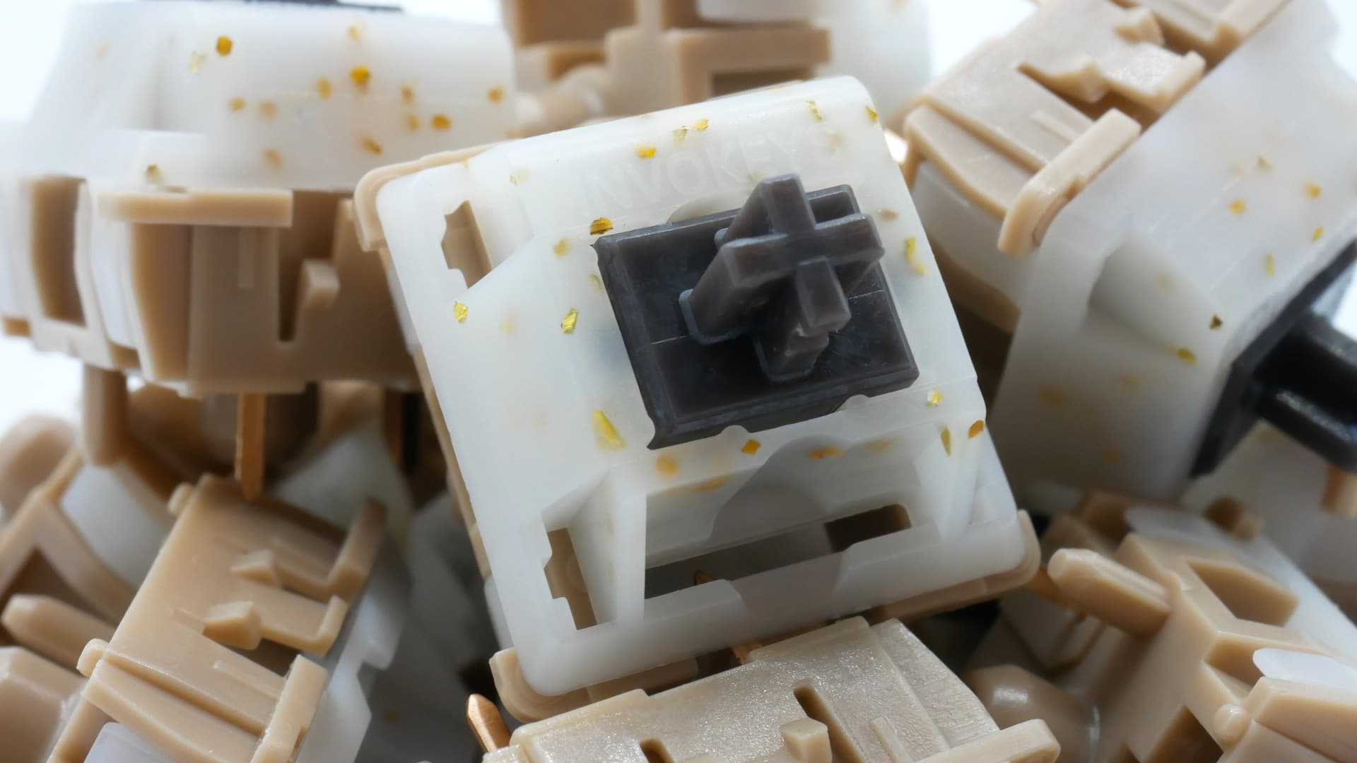

Hey all,
Ever since I was lucky enough to get to debut these switches in my Chicago meetup panel titled ‘The Untold Stories of Unsold Switches’ I knew for a fact that I wanted to write a full length review for them. Well, that time has come! This week I take a deep dive not only into the Invokeys Hojicha Reserve switches, but also the deep development and prototyping process that brought these gold flake embedded switches to us today… :eyes:

I bought 6 packs of them (108 total) and just played around with them in the hand for now, but initial impressions are positive. Its quite smooth out the hand but I also think that they have more of a heavier lubed feel as Theremingoat notes, and this causes it to have a bump where I can’t feel the downslope quite as distinctly for the snap feel. There isn’t a lot of lube but they lube all the important contact points on the stem, and the rails have a thin coat. I tried using a dry brush to distribute existing lube which improved the distinctiveness of the bump, and a light 3203 coat improved this further.
I’m planning on swapping the springs out with 18mm 60g ones but out of the box I think these are perfectly reasonable to use stock.
