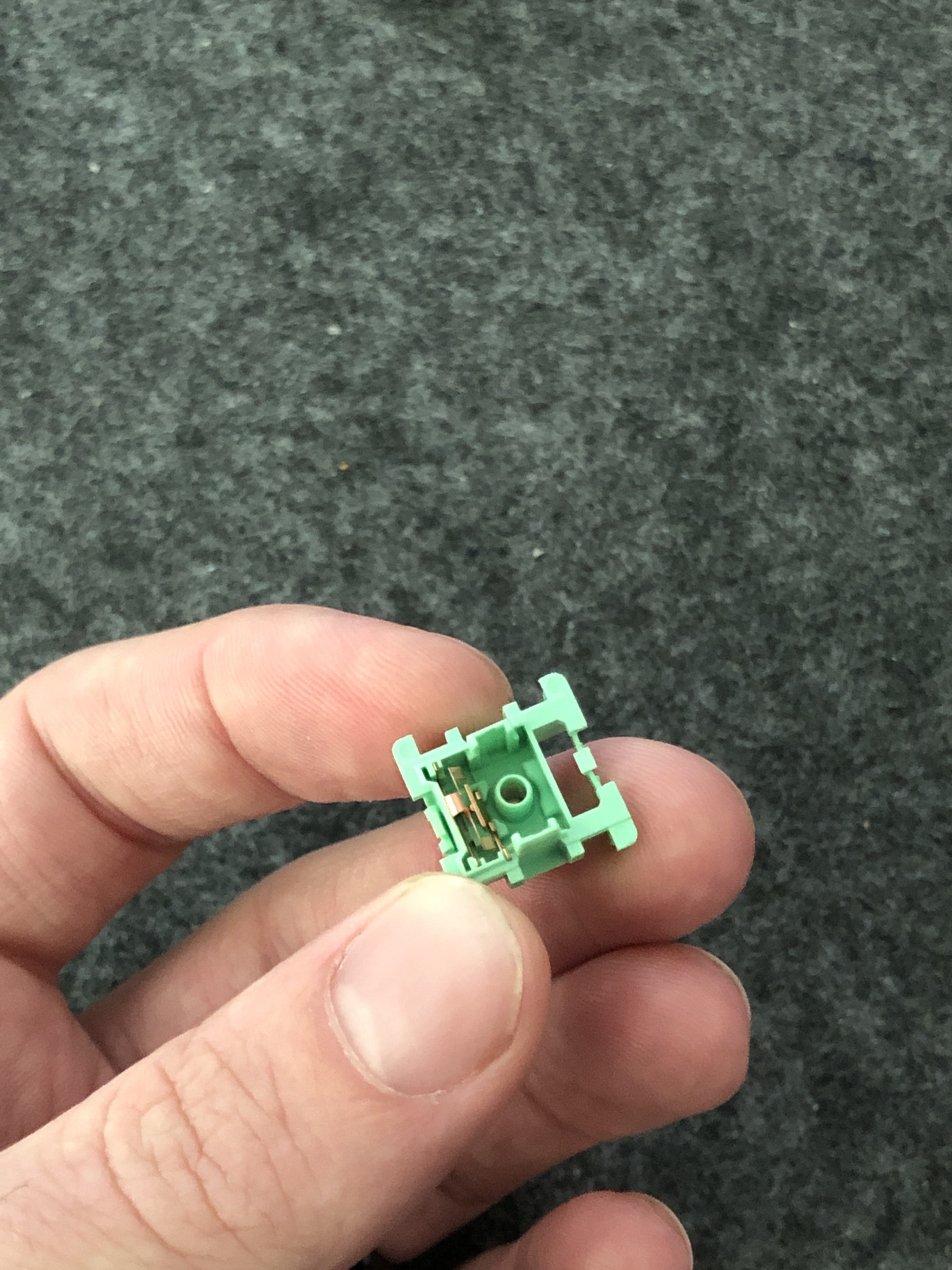

I think must of us agree that the Holy Panda bottom-our sound is quite soothing, but the bottom-out feel is quite jarring. I’ve heard of people clipping the stem to overcome this but that it could cause inconsistencies across switches. After accidentally drilling through a switch housing bottom while modding sky switches I thought, why not try this on a Holy Panda switch?

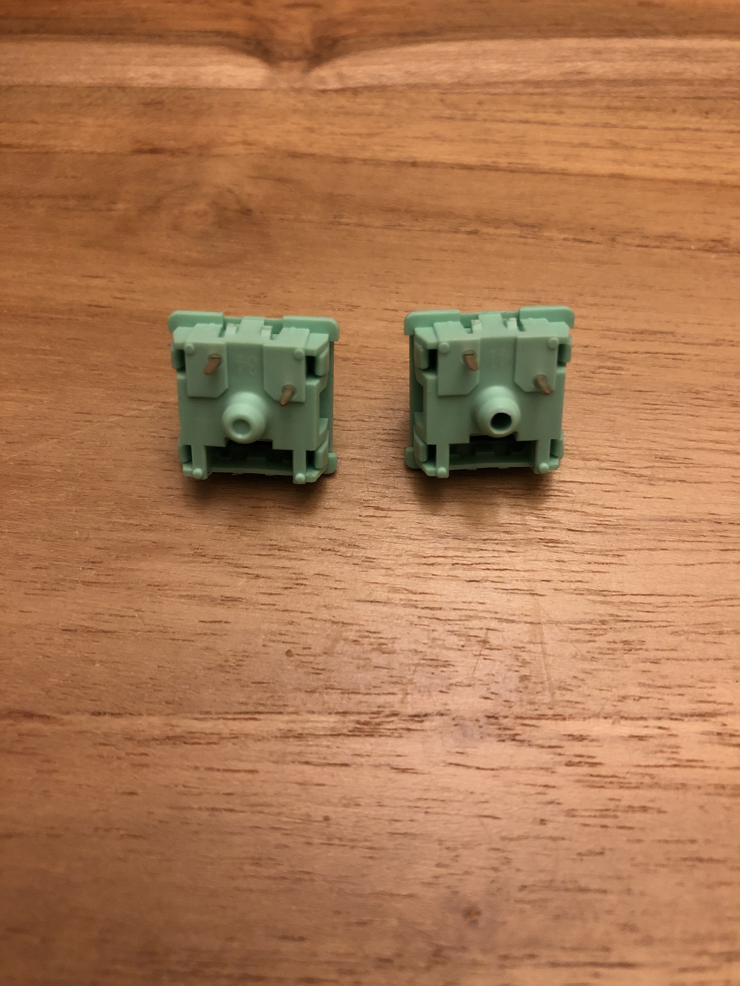

By drilling through the bottom housing you eliminate any inconsistencies with clipping the stem and you no longer have a harsh bottom-out. The switch feels a LOT better in my opinion even if you do lose some of the bottom-out sound.

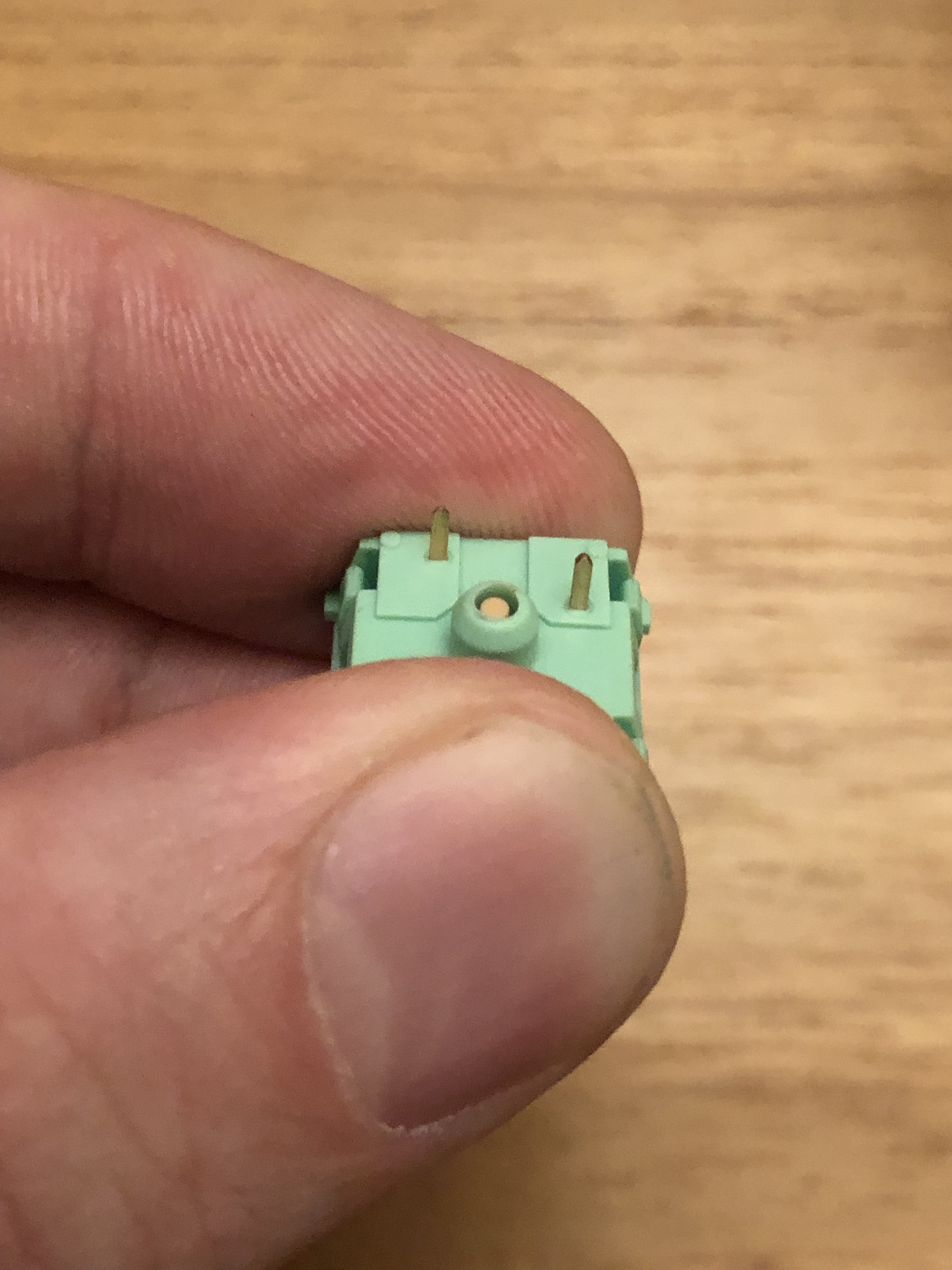

I drilled from inside the bottom housing to the outside. Just held it in my one hand and drilled with the other. The bit was slightly smaller than the stem mount. I’ll get those details to once I determine if this is a safe mod.
