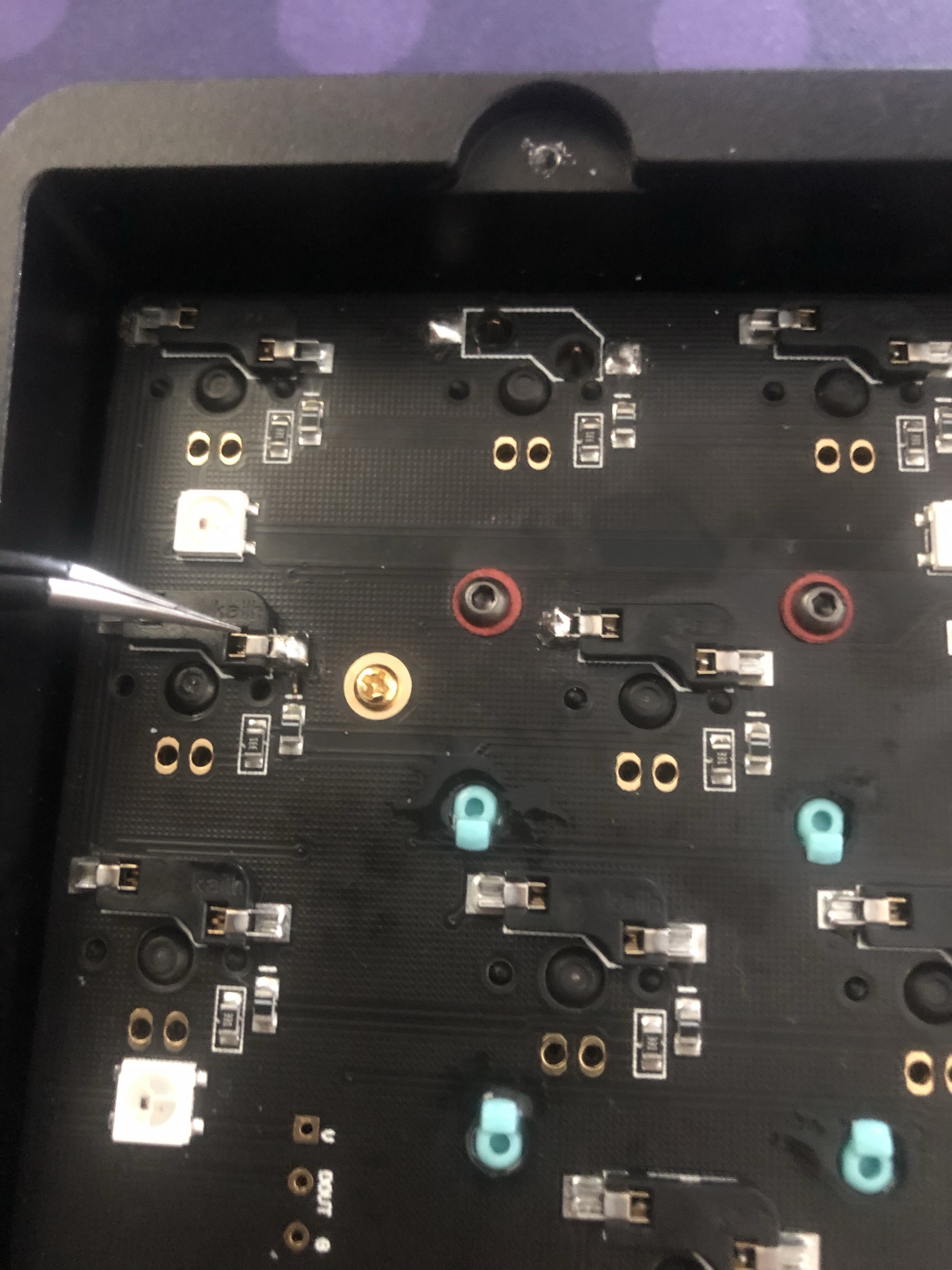

Hot Swap Pad torn off, I want to bridge it but don‘t know how
Hey there, I managed to tear off the hot swap pad and I want to bridge it but I don‘t really know how and where. There was a connection to the diode, can I just solder in a little wire to that?
Thank you guys in advance!

Probably. Your image link is a 404
Oh, I‘m sorry. Let‘s try that again.
bridge from that hotswap arm to the diode below it. Not sure which side, you can test easily with some tweezers. Use a small wire, or heck… it looks like you could run a solid wire if it lines up good enough. Something like the leg of an led if you have one on hand?
Source: I had to do this with 2 switches on my M60-A :slight_smile:
Thank you :slight_smile: I‘ll try that tomorrow and keep you updated!
Had to to try it immediatly and it worked :slight_smile: Thank you a lot!
good to hear!
