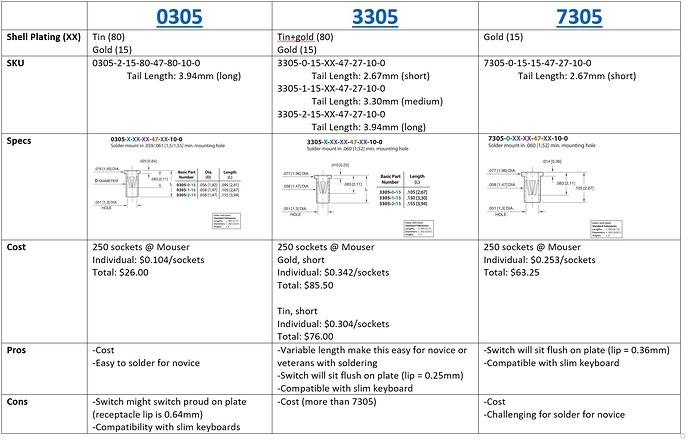

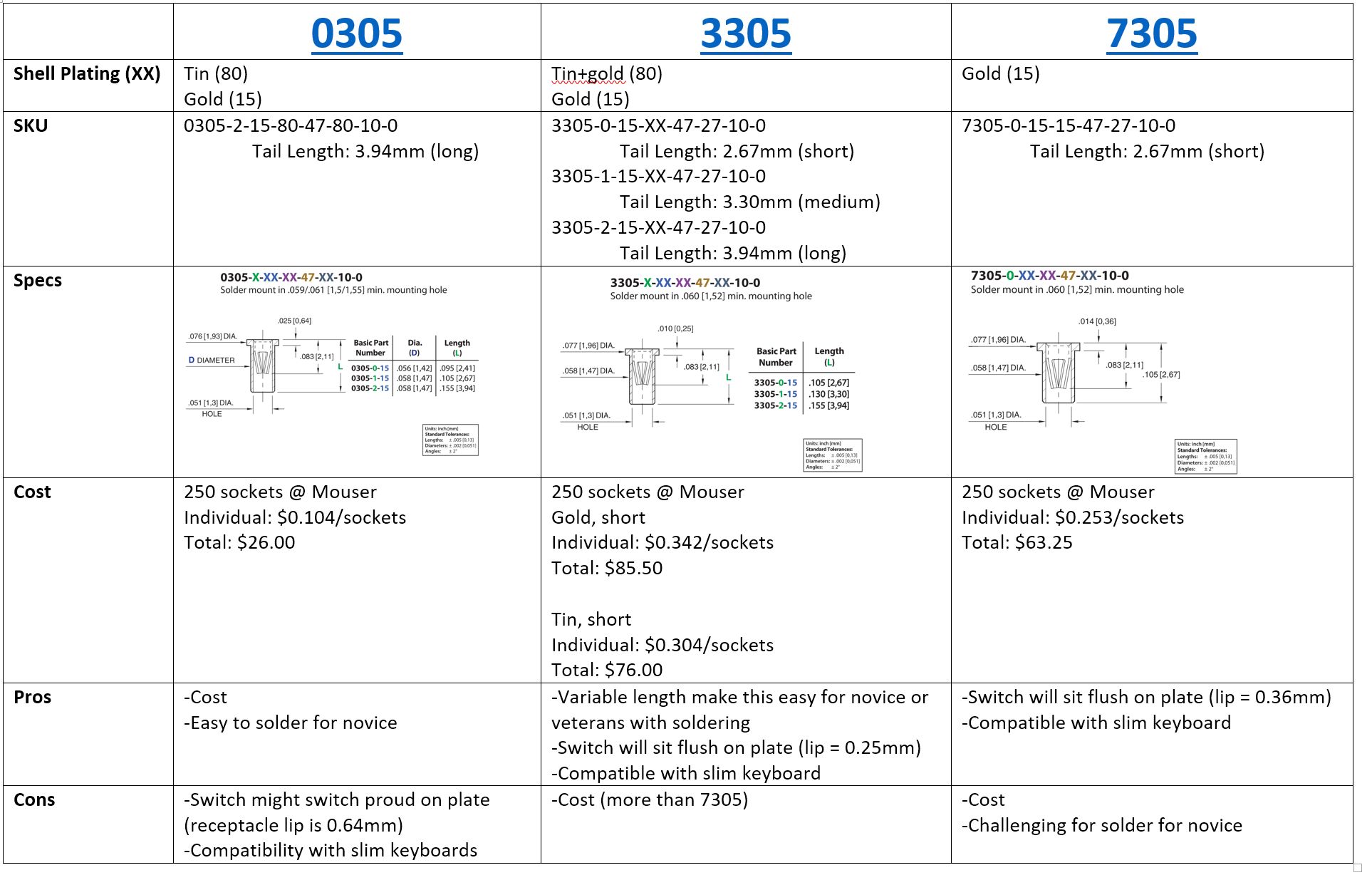

I put together this chart a while back for mill max. Imma just leave this here for the new folks.
Another good resource has been Mill Max hotswap sockets 0305 vs 7305 vs Holtite
