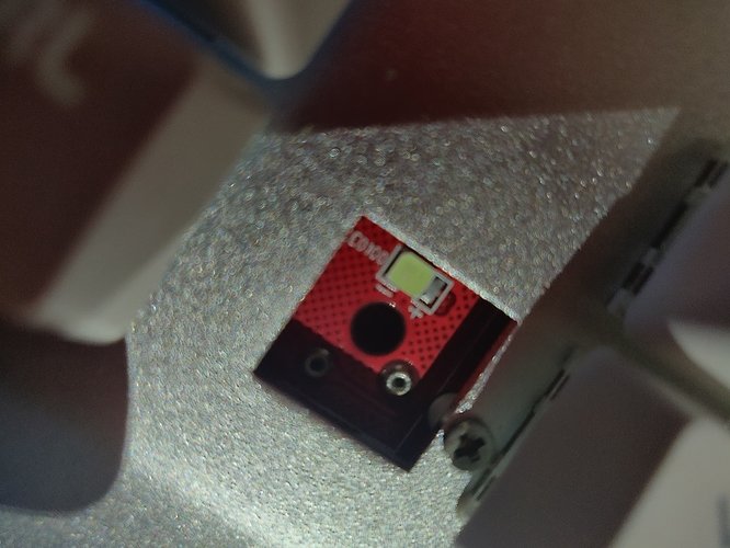

Sadly it turns out that my “CIY” board only takes cherry style outemu switches, and I didn’t feel like filing down the pins of 104 switches till they fit the socket… Was looking for outemu alternatives, but I realized that maybe I could buy the parts I need and make my own switches. I’d really appreciate it if someone could guide me through this venture, since it seems like a bit of daunting task.

Housing/bottoms that fit my “CIY” sockets, maybe outemu sky housing? Not sure how the housing will affect the feel of the switch…
