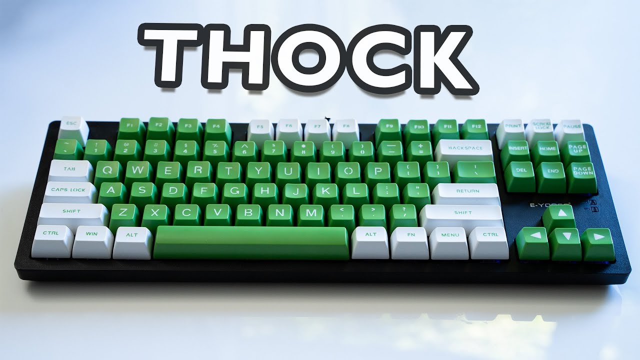

This video is probably the best crash-course on THAWCK at the moment:
Beyond that, I’ve got some general bits of guidance about chasing the t-word starting from zero - plenty of stuff from the video above is down there if you just want a bulleted list (links are YouTube videos if you want to dig deeper into granular topics):
  • Generally “thock” means deeper sound compared to the baseline of standard linears like the “reds” that probably came with that keyboard
  • Specifically it’s an onomatopoeia that describes the sound of collapsing capacitive rubber dome keyboards like these, but has since come to describe deeper keeb sounds in general
  • One of the cheapest and most effective mods to push just about any given mechanical keyboard in the direction of that sound is the tape mod - essentially putting a layer of masking tape on the back-side of the PCB
  • Generally, plastic cases are easier to get the t-sound from (this is good for our purposes here), and so are cases with lots of room in them (this isn’t)
  • Filling empty space with sound-deadening materials like polyfill or foam can especially curb high-frequency sounds, helping the keyboard sound deeper overall
  • You can get a deeper sound with tall keycaps like SA, MT3, MG, and other high profiles, but those tend to be a little more expensive
  • Lubing the existing switches can deepen the sound,
  • as can replacing them with any number of popular pre-lubed ones including but not limited to Oil Kings, Ink Blacks, North Poles, and Black Sesames - these are all switches of a familiar style to the generic Reds that keyboard usually ships with, but will all have a comparatively deeper sound, all other things being equal. Deep sounding switches do tend to cost more, too - but you can get some 205g0 grease and a brush for pretty cheap - biggest cost is patience, there.
  • Alternatively, dampened switches tend to have deeper sounds, closer to those that “thock” originally came about to describe - switches like these aren’t as loud and feel more soft compared to what the i87 has now, but they sound and feel more like capacitive dome switches (that themselves aren’t available for that particular keyboard)
There’s some other stuff one can do to chase thock like using a POM or PC plate, but none of it would apply to the keeb you’re working with. Feel free to hit me with any specific questions you might have now, or that may come up later. Cheers!
