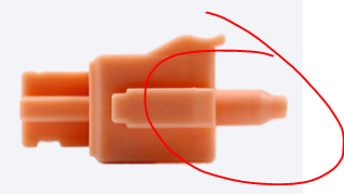

The biggest shortcut to a poppier spacebar, even when quietly pressed is to use extended pole switches. I personally put a Kailh stem cherry switch in most of my boards’ spacebars.
You mean these?
@sorocario I second this advice! If you lightly hit your spacebar the extended pole should still make contact with the bottom housing & give you a poppy sound from it. Also if you get some thick, ABS or PBT caps from a well known manufacturer they’ll give a better sound profile than the caps you are currently using also.
