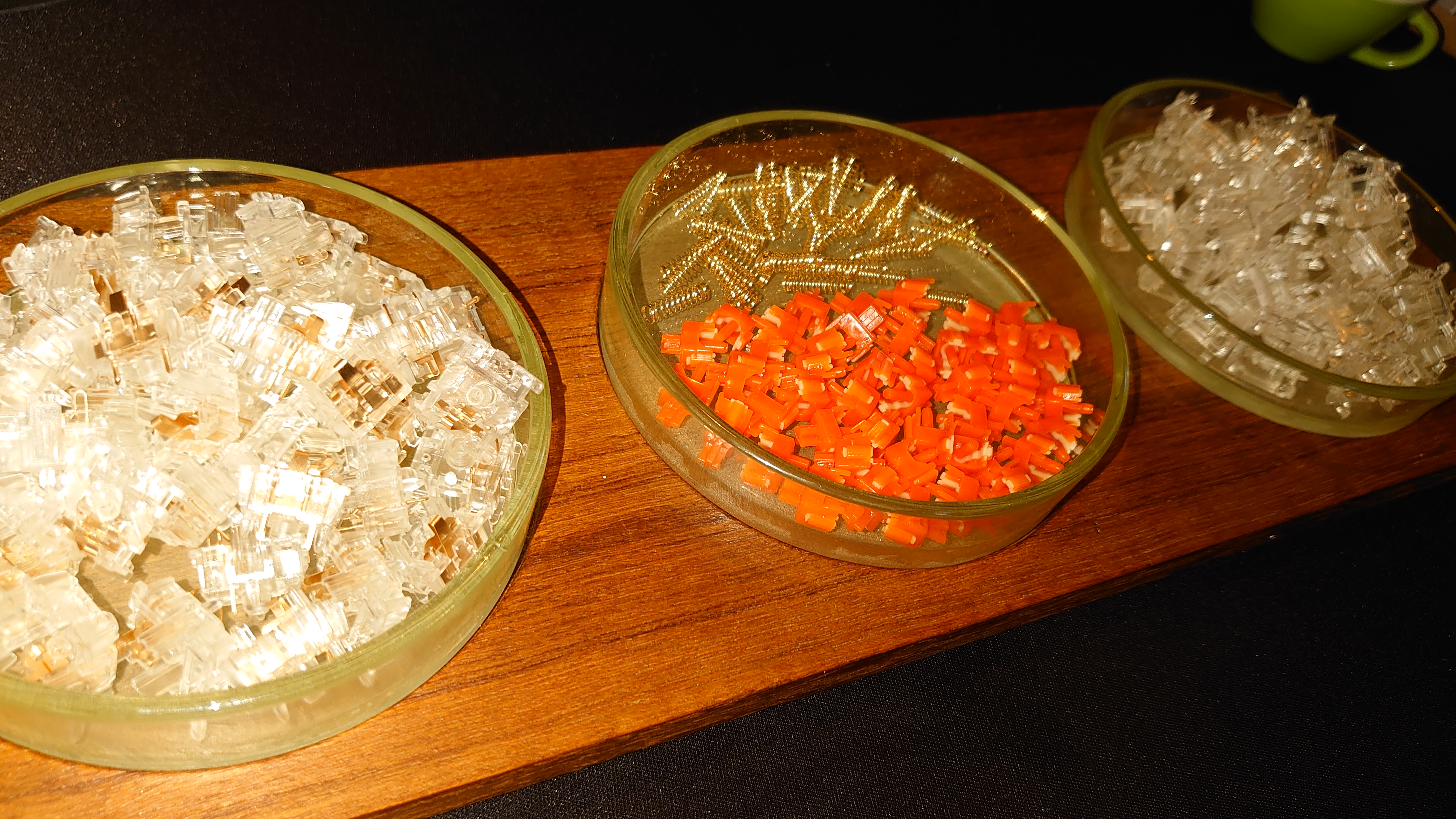

Soooo, I’m going to relube 50 Helios and I want to remove the old lube completely.
My plan ATM is to just open them up and put in a jar of isopropanol and give it a shake, thoughts on that?

Speaking from personal knowledge, based on facts as far as I know, I think you should be aware that prolonged exposure to isopropanol especially of the plastic parts can cause crazing or stiffening depending on the plastic.
I think it’s better to grease up those elbows and clean the housing with a Q-tip and a rag with alcohol and the stems and springs by tossing them around in a jar of the alcohol.
The stems are a solid piece of plastic so the phenomenon wouldn’t appear if you left them in the alcohol for even 30 mins or much longer than that, which you don’t really need to do.
The housing however can be pretty thin at some places, plus the prongs of the top housing which hold the bottom housing aren’t something you want to get stiffened.

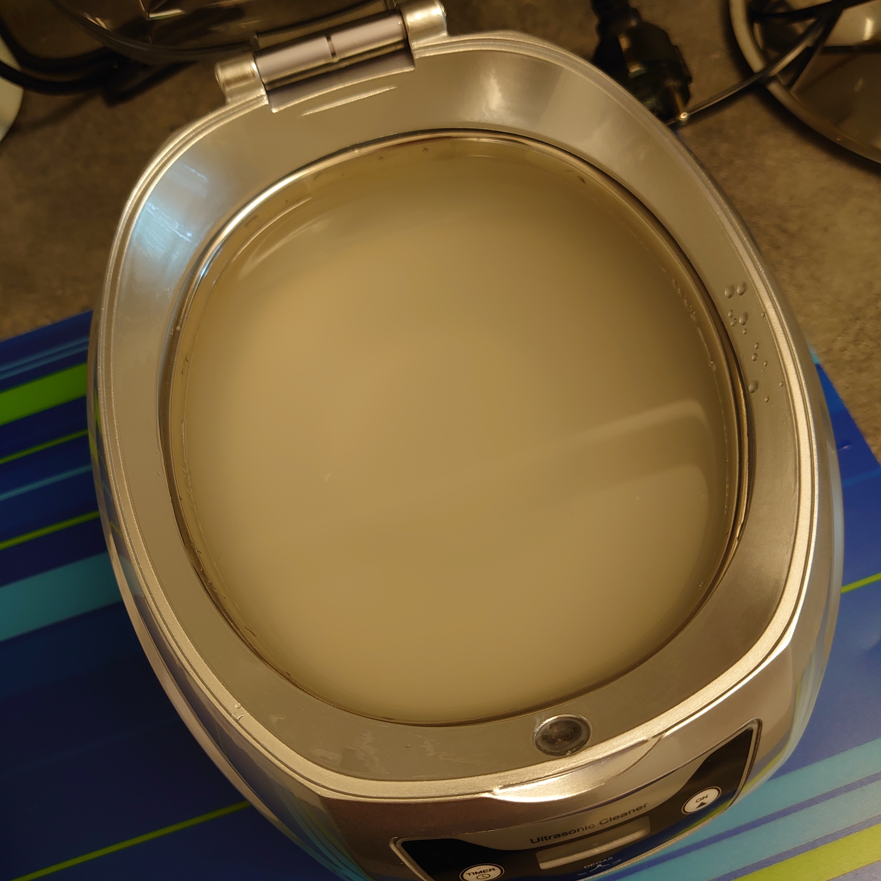

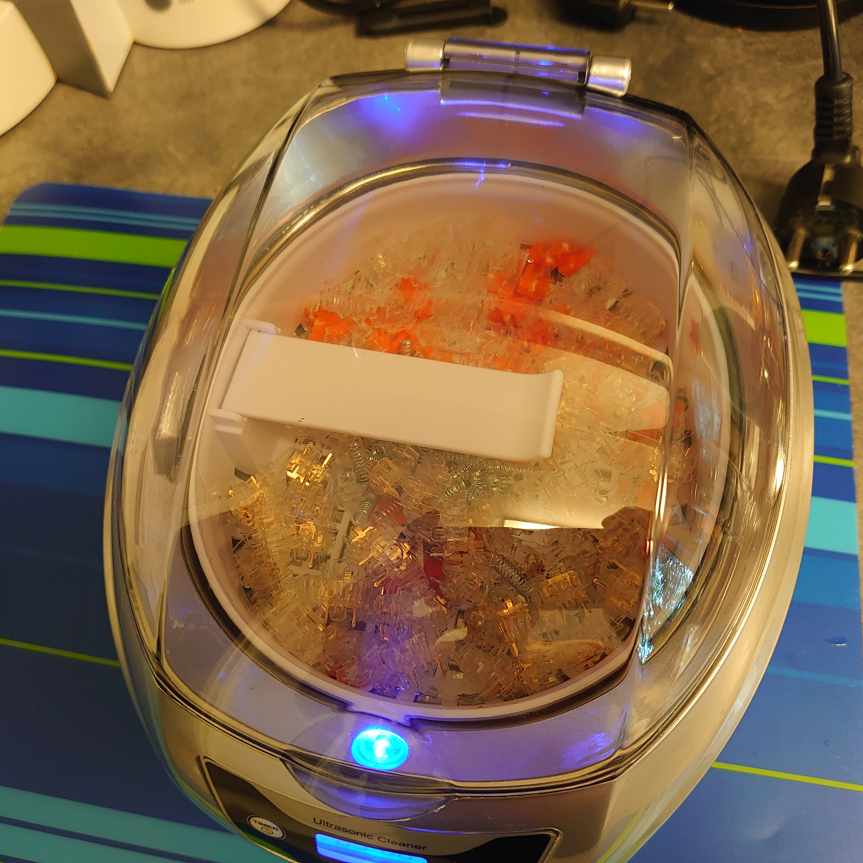

Probably a good job for a ultrasonic cleaner and some mild dish soap.
Hmm, there is a ultrasonic cleaner on sale for ~50$@ the hardware store here in town.
Waiting…
Well after 6min springs were clean but I could feel the lube on the stems still so I started another run.
But it definitely cleaned something out.
Hmm, I don’t know. I’m not impressed with the ultrasound cleaner. U really need to dry them afterwards to. (that’s why I wanted to use isopropanol)
One concerning thing is that a couple of leaf fell out, I don’t know if it was due to drying or the ultrasound tho…
