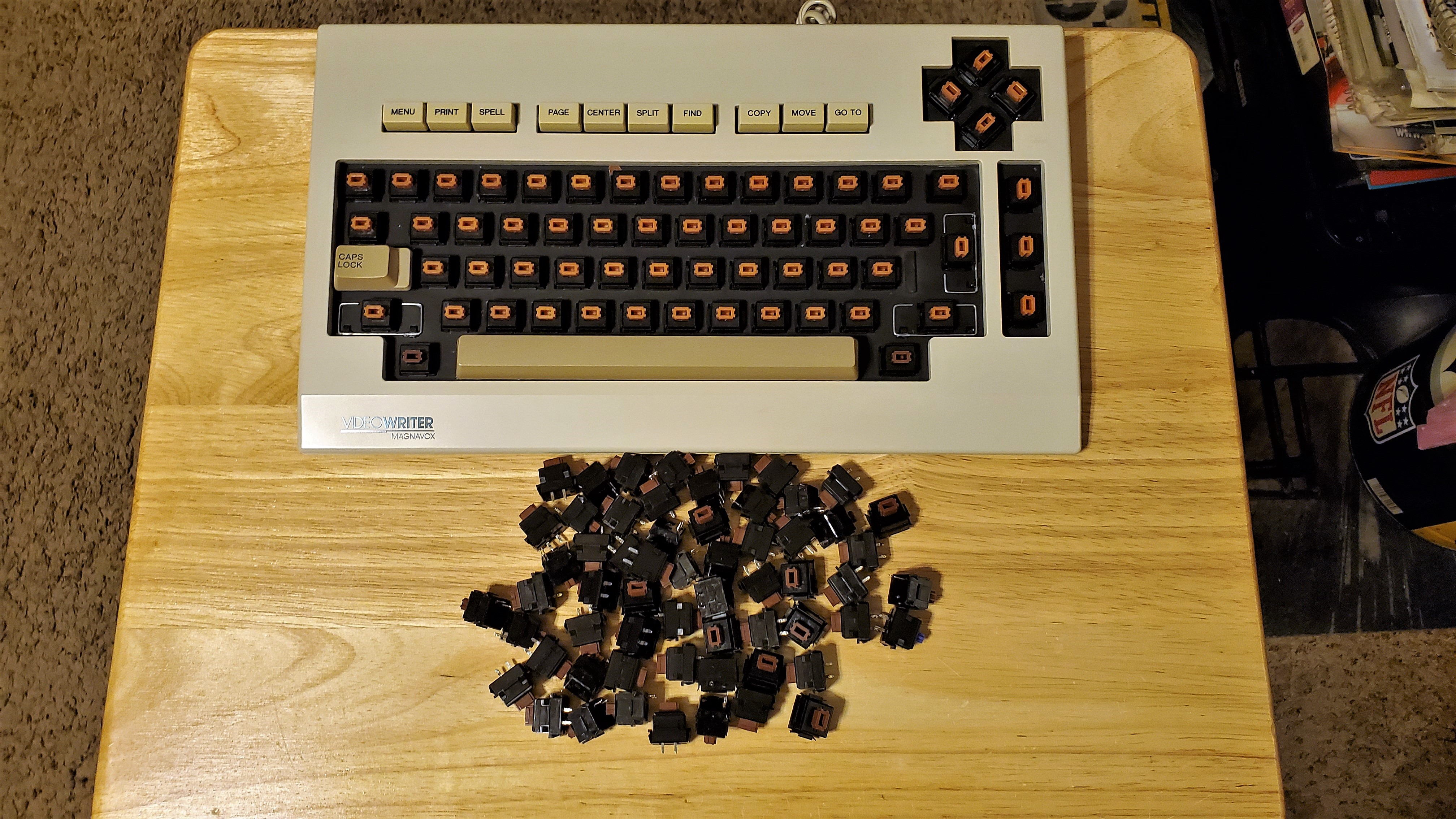

Awhile back I finally found & bought a Magnavox Videowriter to get my hands on some ALPS SKCM brown switches. Once I got the board I became very hesitant about harvesting the switches out of it as I did want to keep the Videowriter functional for a future USB conversion. I had originally planned to desolder the browns out of it & replace them with some loose SKCM orange switches I have, but I felt there had to be a better way to go about that than desoldering. Then it hit me, SKCM brown & oranges were made early enough that they both should have the thicker housings & long switch plates, so in theory I should be able to swap the parts between the two. I tried it with a few loose switches I had & sure enough SKCM oranges use the same thick housings & tall switch plates. Which results in no noticeable change to feel or sound when swapped between the two!
So I ended up just swapping the top housings, sliders, springs, & tactile leaves from the browns into the bottom housings with switch plates from the loose SKCM oranges I had & was able to get my ALPS64 build with SKCM browns done without having to possibly sacrifice the Videowriter!

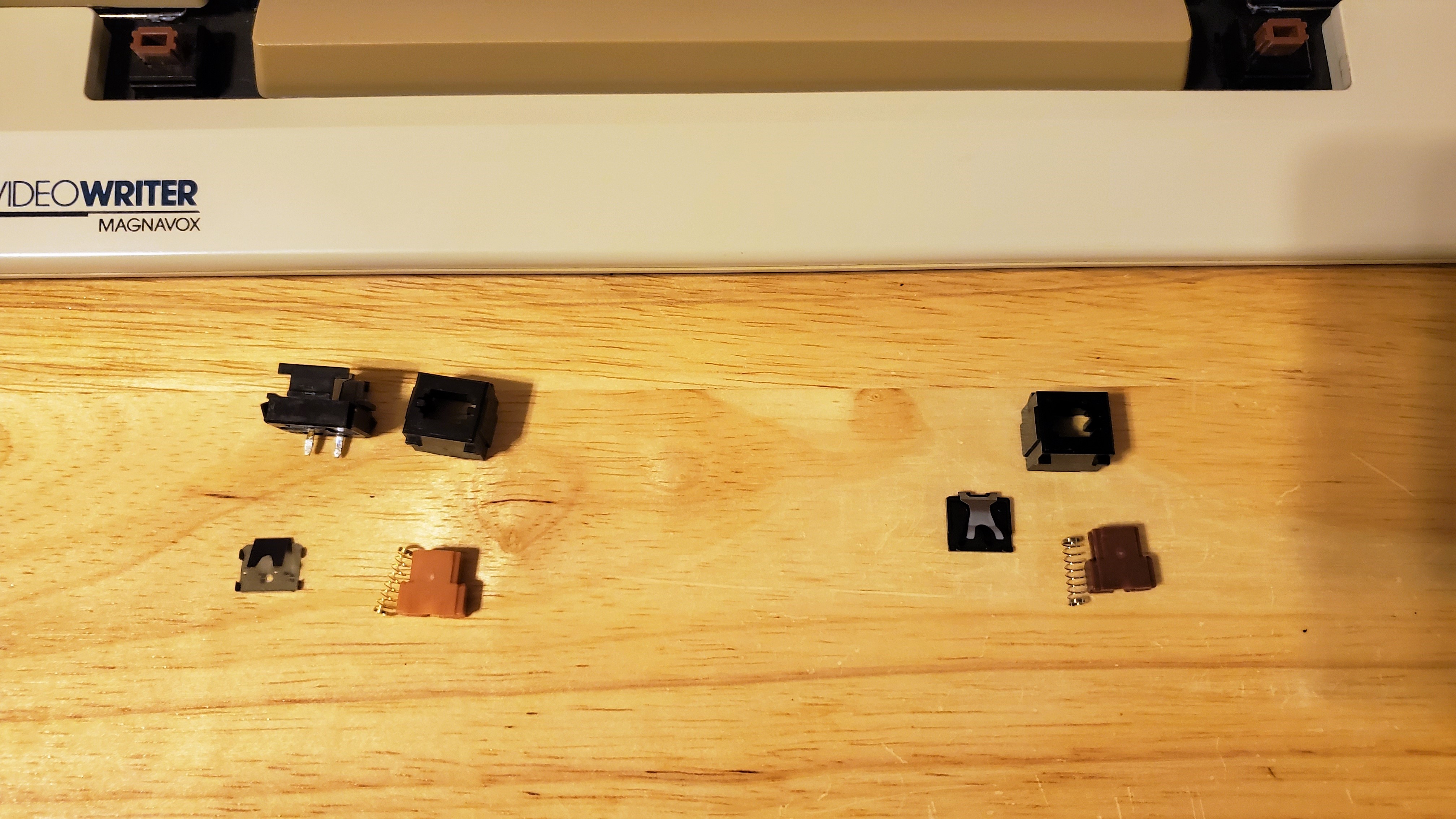

Comparing the parts

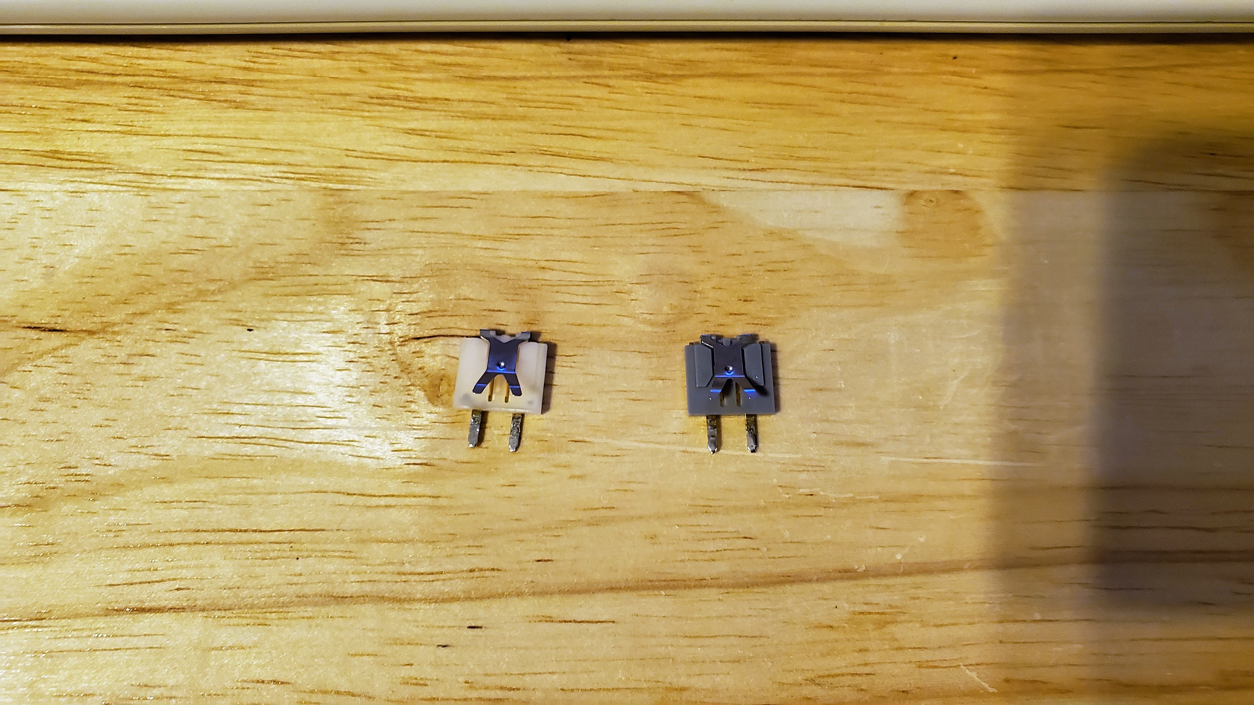

White tall switch plate from SKCM oranges, grey tall switch plate from SKCM browns. The white & grey ones can be found in SKCM oranges, AFIK browns use the grey ones exclusively. Feel & sound wise I find no difference between the two.
Getting the process of swapping started
All swapped out, I didn’t need the switches from the bottom row so I left them as browns

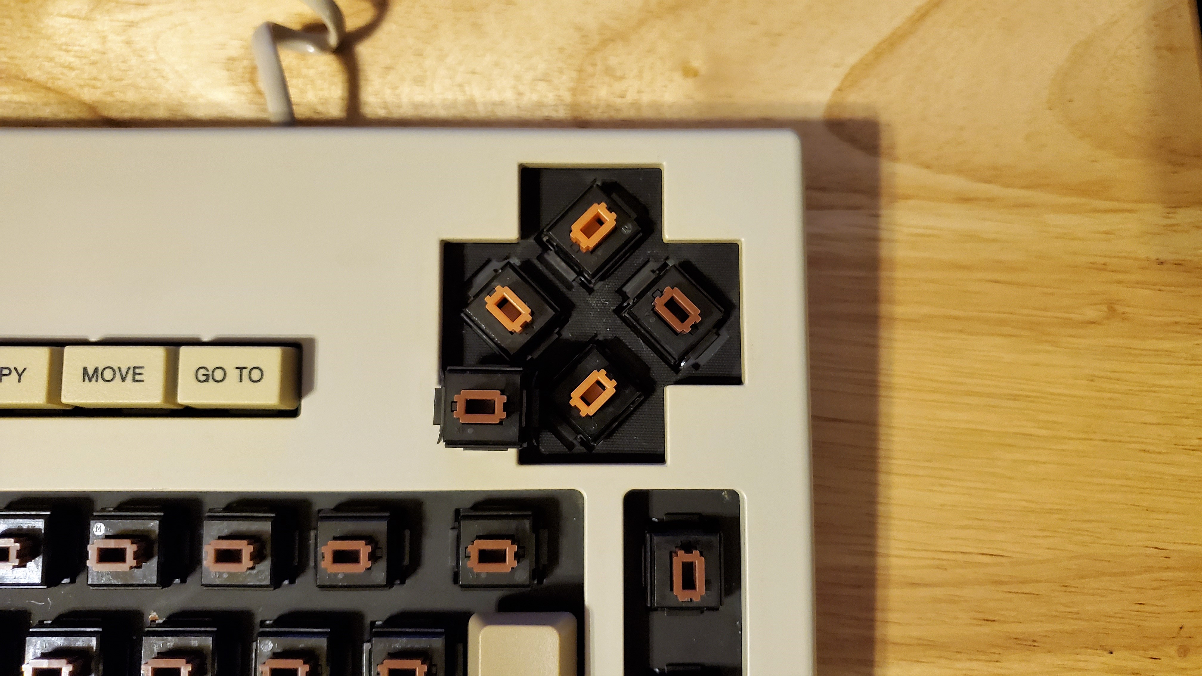

The finished ALPS64 build
