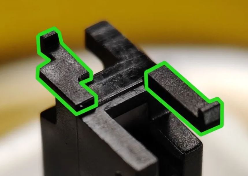

Then as far as clipping goes, if your stab sliders have 4 legs instead of two. You want to clip off the legs highlighted in the pic below. The ones that have the little teeth at the ends. You need to get the whole of the highlighted areas if you need to clip them.

Thanks for posting the diagram!
