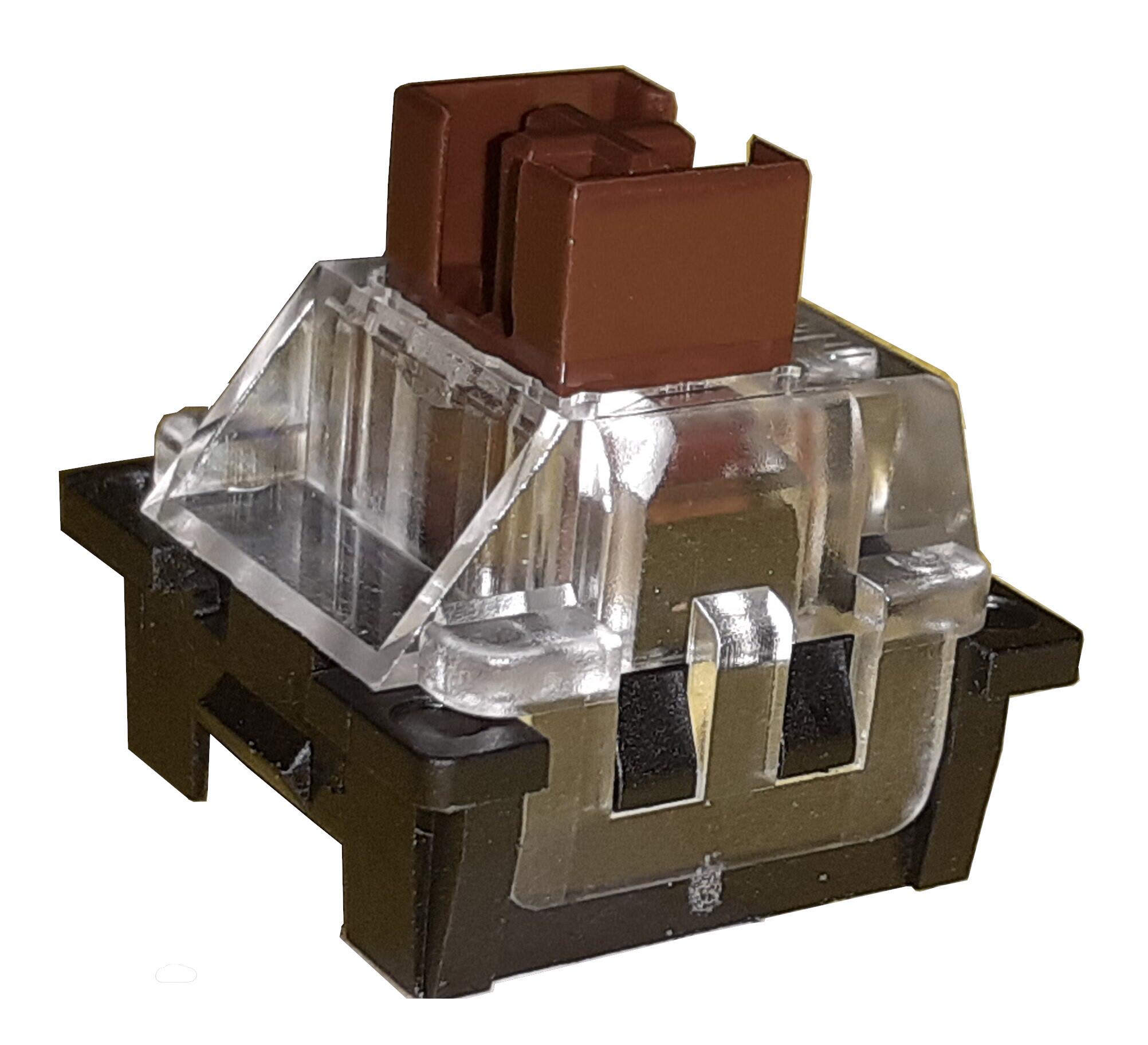

How to open Truly Ergonomic Cleave switches?
The term for that top is “wing latch”
It’s easier to open than traditional switches without a special tool, but it’s not really fast. Essentially you stick something very thin under either wing and pry up at the same time. The top should come up from the force of the spring.

Looks like a kailh like switch, most switch openers open both cherry and kailh like switches like said @pixelpusher .
