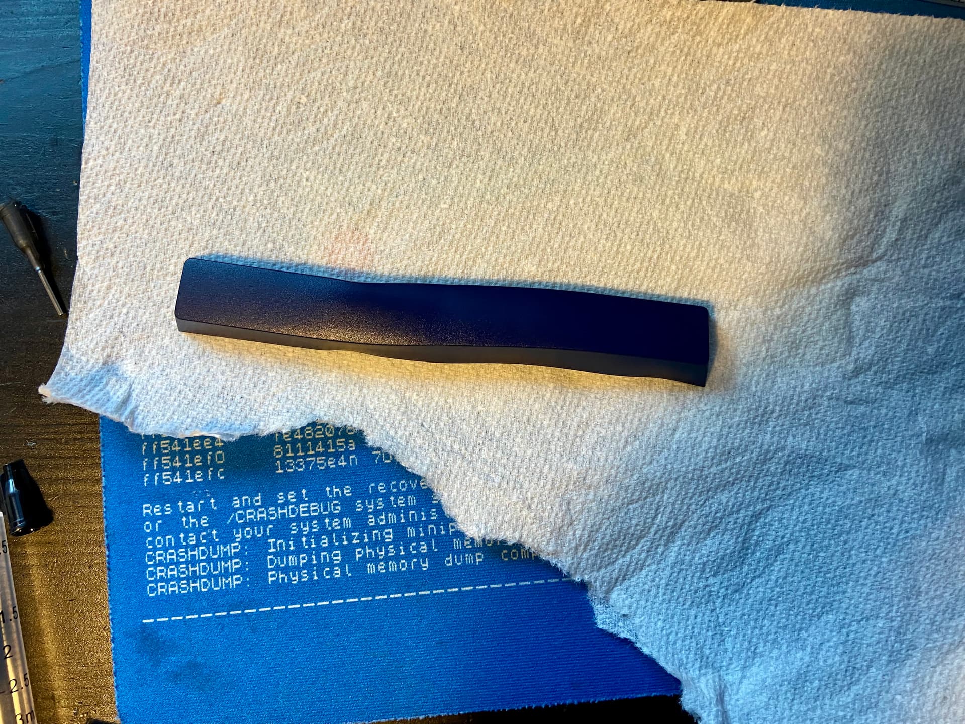

I just tried to fix a gmk 6.25 the other day with a heat gun. Had tried really hot water before and it didn’t work. Unfortunately the heat gun warped it more… I mean getting the bar hot enough to reshape inevitably makes the warping worse at first. It took quite a bit of time, but it’s useable now… though one bit looks melty. And I melted my backspace by accident lmao.
It was a rough afternoon.
Can relate
Nearly cried. No joke. Thankfully mechmarket pulled my sorry butt out of here
Edit: This is the previous spacebar. I did not screw up again.

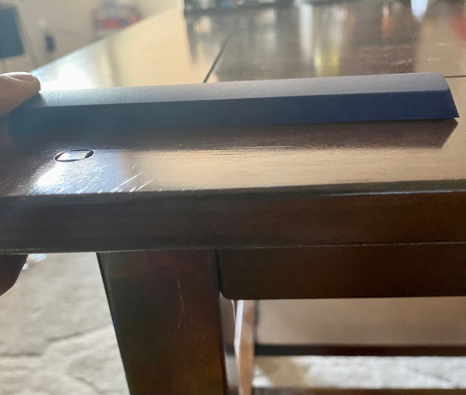

I’ve had good luck with correcting bent space bars with a hair dryer. I just get it relatively hot and start pressing it down on a flat surface.
