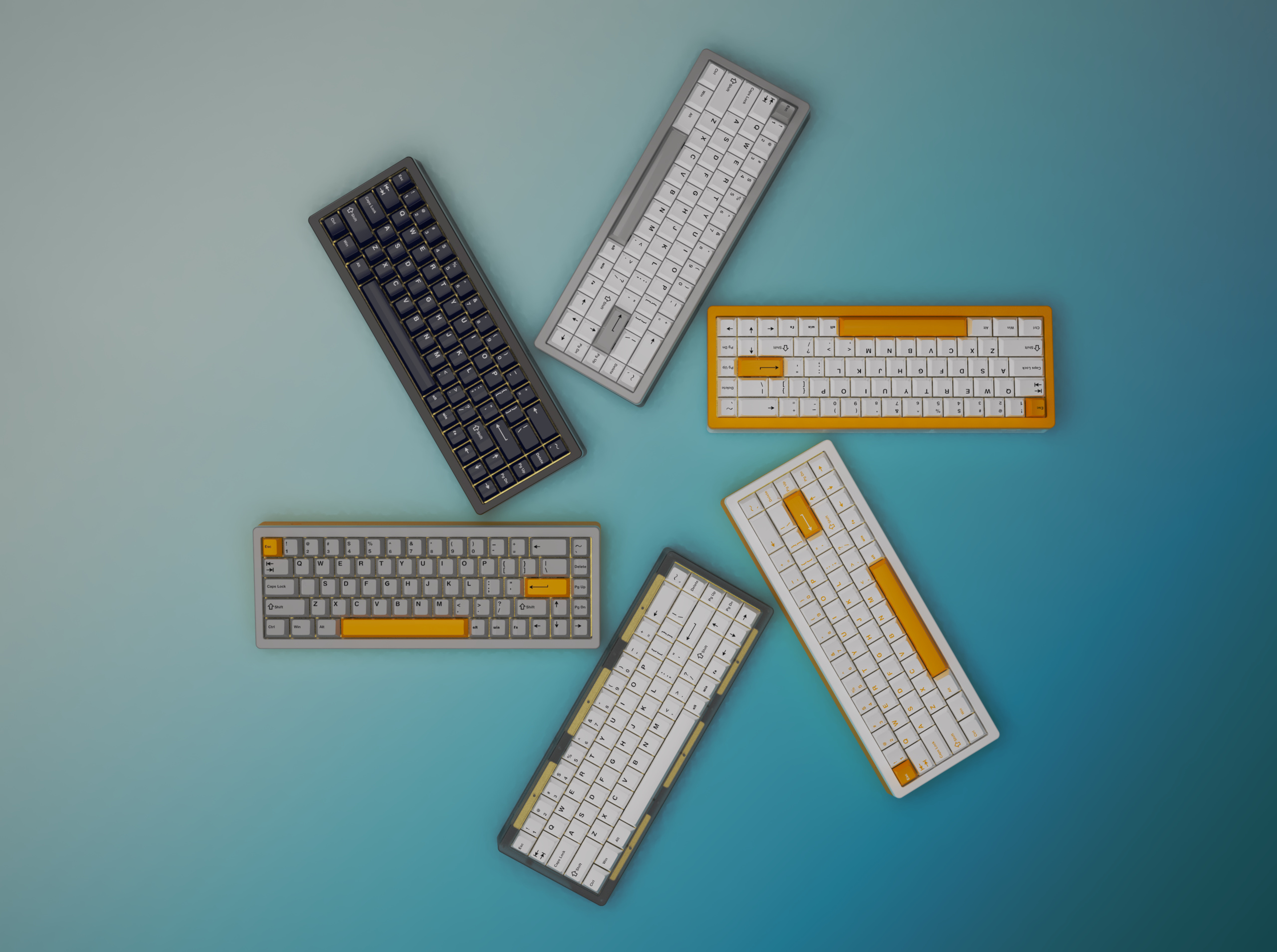

1 The specs.
-Typing Angle: 6.5 °
-Materials: 6063 Aluminum & Polycarbonates & Brass
-Case options:
o Aluminum: anodized black, anodized grey, E-white, E-yellow.
o PC: black frosted & white frosted
-Weight options:
-Plate options
o brass (brushed)
o Gold plated FR4
-Plate mounting system: gasket sandwich
-PCB:
o Niz original factory electrostatic capacitive PCB components
o 1.5mm black gold plated FR4, type-C daughterboard, QMK/VIA support (MX version only)
