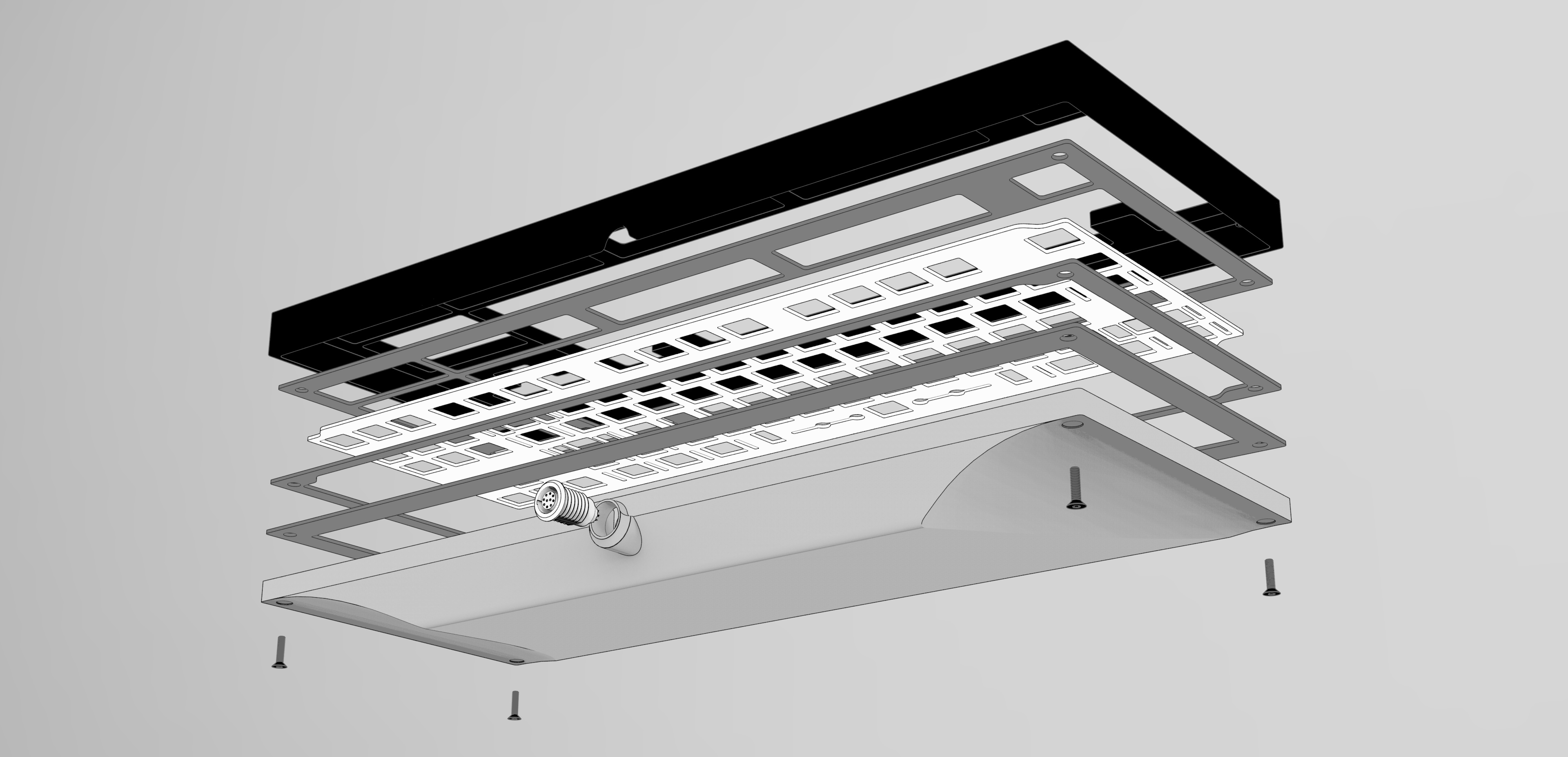

This is an IC for a TKL: Kepler.
Specifications:

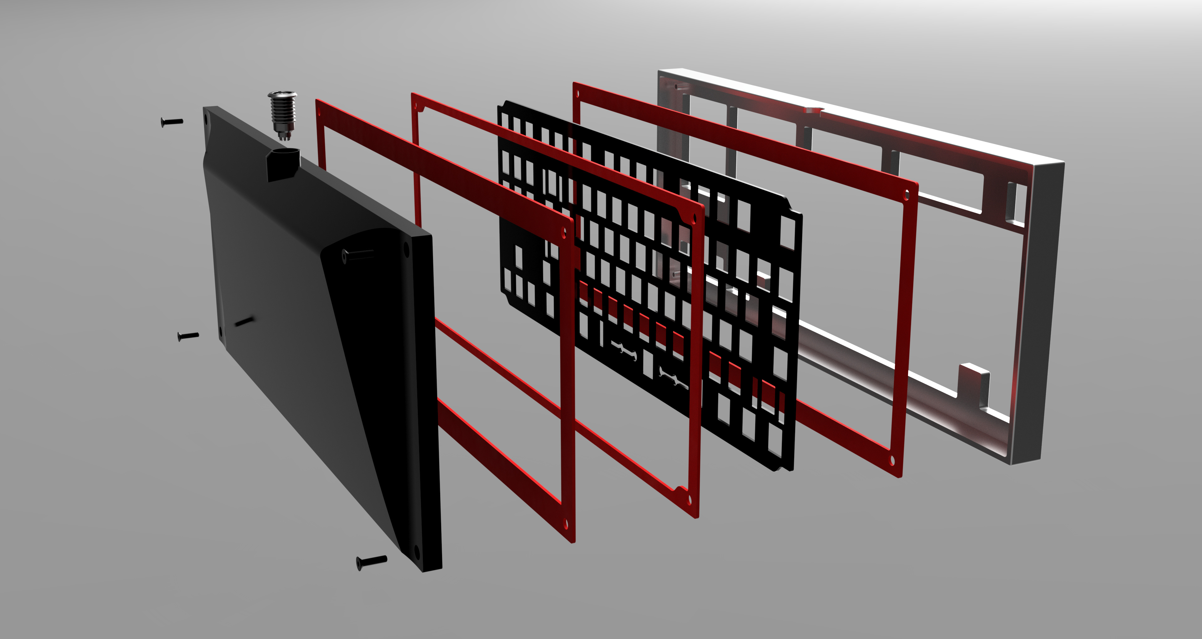

  • Top: Aluminum 6063 (Anodized RAL 9006 or E-Black)
  • Bottom: Brass (PVD Finish)
  • Plate: Brass (PVD Finlish) / Optional: CF, FR4, POM, and PC
  • Layout: WK and WKL
  • Mounting Style: Isolation Mount
  • Typing Angle:
  • Front Height: 19mm
  • Connector: Integrated B-Series LEMO (Socket: EGG.1B.305 & Plug: FGG.1B.305)
  • PCB: Supports H87a or any standard PCB w/ USB breakout
  • Price: TBD
Expanded View:
Renders:
Prototype:

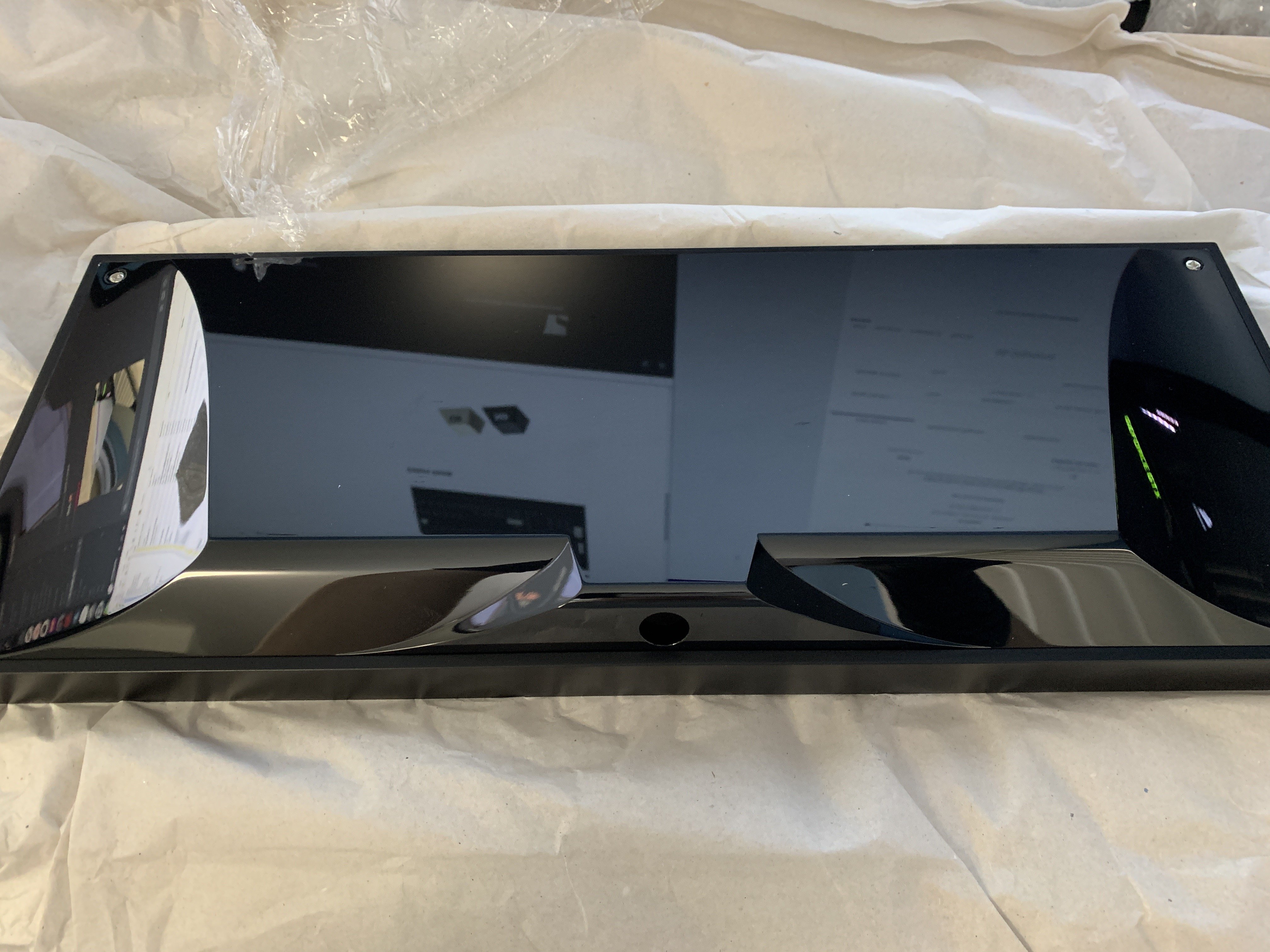

Plus in terms of price I’d be more concerned about that bottom brass piece. That thing is going to be expensive machine. But damn it looks good!
