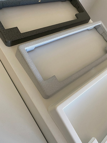

[IC] the Heavy Grail: a Norbauer housing for the HHKB
Wait, are you all wanting the pink plate or a pink case? I want a pink case…
pink case for sure, the prototype one. that is so cute.
I’m hoping for a pink plate. White case is perfection IMO.
Why not both? :grin:
VHS finish :drooling_face: :drooling_face:
Definitely.
Made an account for this project specifically. I am in love with your design, aesthetic and attention to detail. I was wondering if you would you be able to give estimations for battery size potential for a Bluetooth mod? Also, would love to see this in the tactical color.
OH damn that’s so cool. @norbauer would you consider doing a black in a similar finish to the white?
This would look excellent with 9009
You could definitely fit a couple of AA batteries inside the housing (towards the back) due to the angle.
:open_mouth:
Hey Ryan! Glad to see this is finally going forward post-COVID. Any plans to include a polycarbonate resin model like the FC660C?
No plans at present since the factory that is doing the machining on this doesn’t have in-house frosting ability, but perhaps someday eventually.
