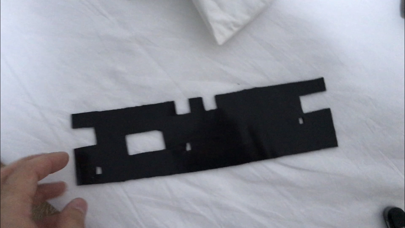

Just to let you know, i made this sorbothane sheet to put it inside, to you have any experience or any picture of what it should look?
I got this 1/10" thick sheet and i did my best to match the top/bottom case but i’m sure there is a better shape for it! A picture of someone who did it will be amazing!
