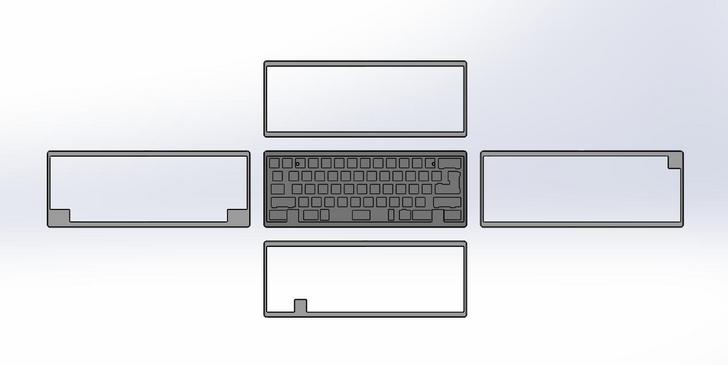

Top case : Five kinds of top case

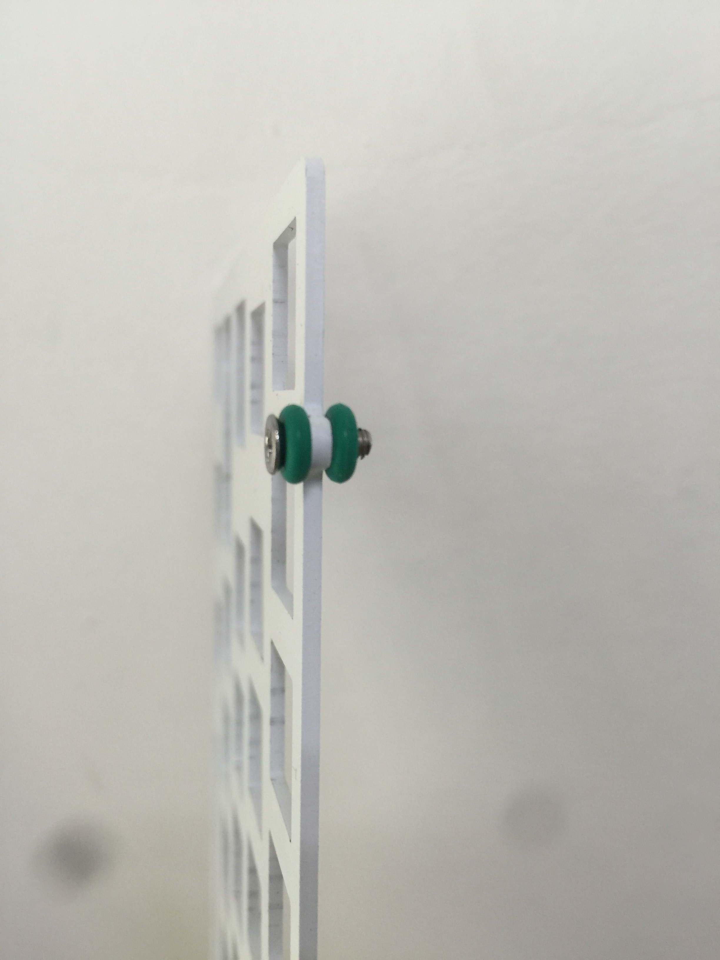

Mounting :
The plate is mounted to the top case with the 'O- rubber 'Do not like “Gasket” mount, we have the ‘O-rubber’ cutout,when the ‘O-rubber’ put on the top & bottom of the case. the plate will experience a stronger or lighter clamping force.When you type through the plate will get fedback from bottom due to the 'O-rubber’get press .

Do you have any details on the plate? I’d like to see how you approach relief cuts on the plate for evenness across the board. I’m also curious about the bottom of the keyboard. Is there a hollow space below the board from the design of the feet? How does that effect the sound of the case?
