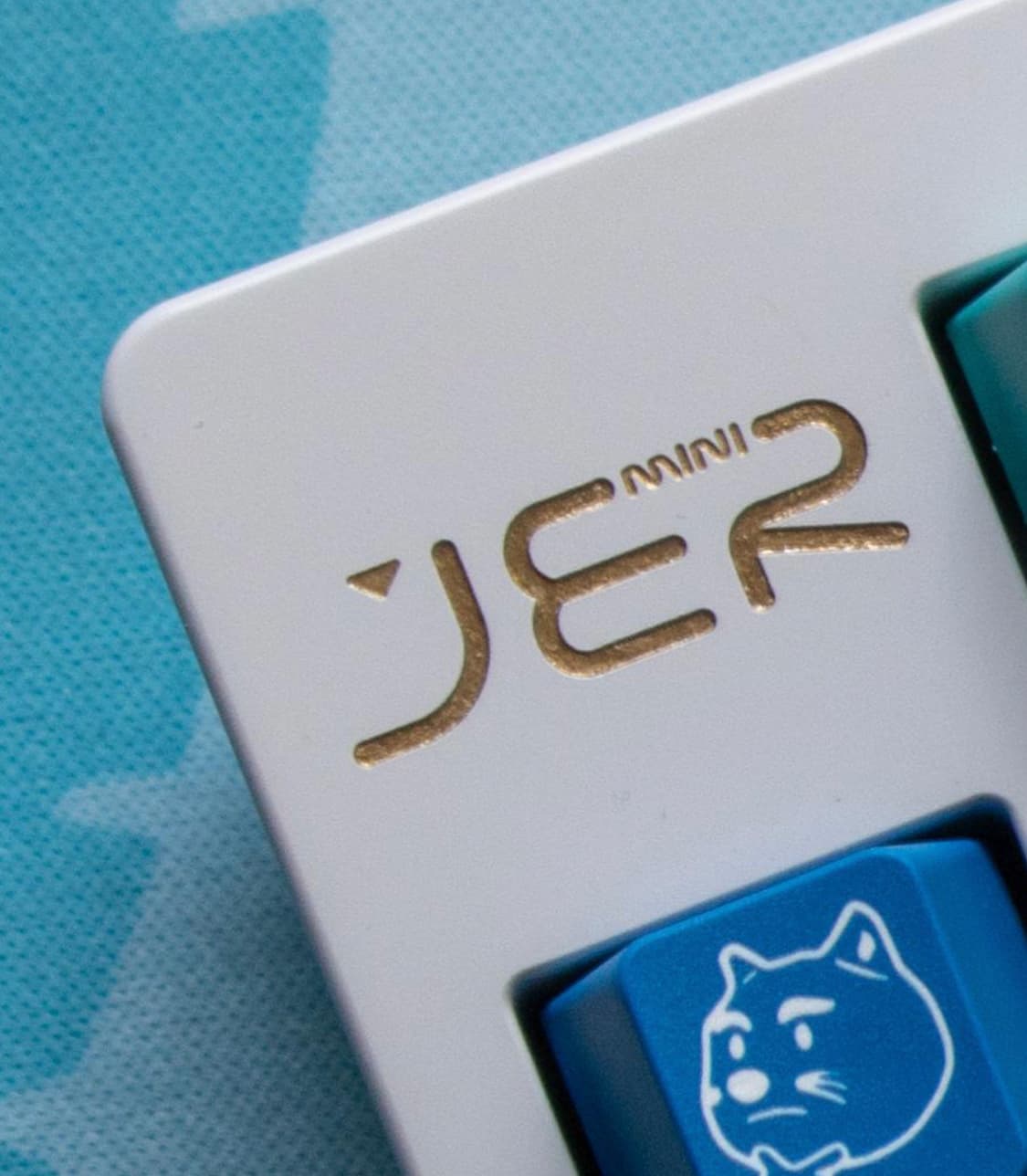

Hey everyone! I have a PC board coming back to me dyed that I wanted to infill the engraving of, similar to this that I did with my Jer Mini.
This was pretty easy to go about doing since the cerakote made wiping off the acrylic paint much easier, allowing me to just kinda slop it on and wipe the edges with an iso soaked qtip. With polycarbonate I imagine it would actually seep in and dye/stain using acrylic paint, unless I’m totally wrong!
Hoping someone has some idea on what could be used to get this done, and any advice. I’d really appreciate it!

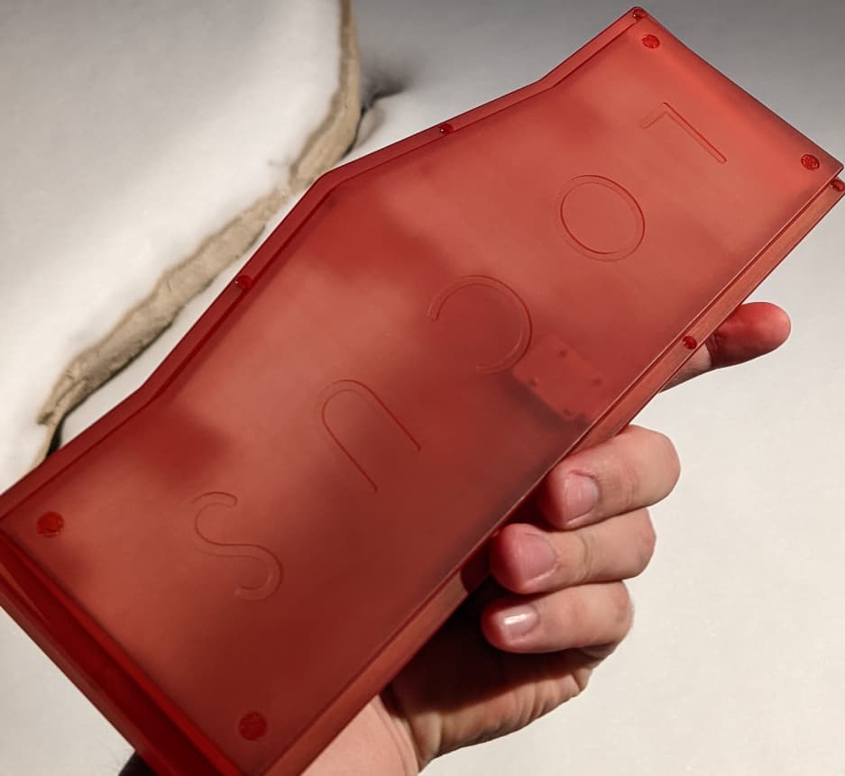

Hey thanks appreciate the response! It’s always comforting to hear that other hobbies do something similar, that’s basically the reassurance I was hoping to find lol. For reference this is what I would be doing, the Locus letterings.
I guess I’m mostly worried that I won’t be able to simply slop on the acrylic paint and wipe it up as I was able to before, unless PC is okay with an iso cleanup? The engraving is big and deep enough to where I should be able to get a brush in there and be precise, so I might just try it out anyways.
