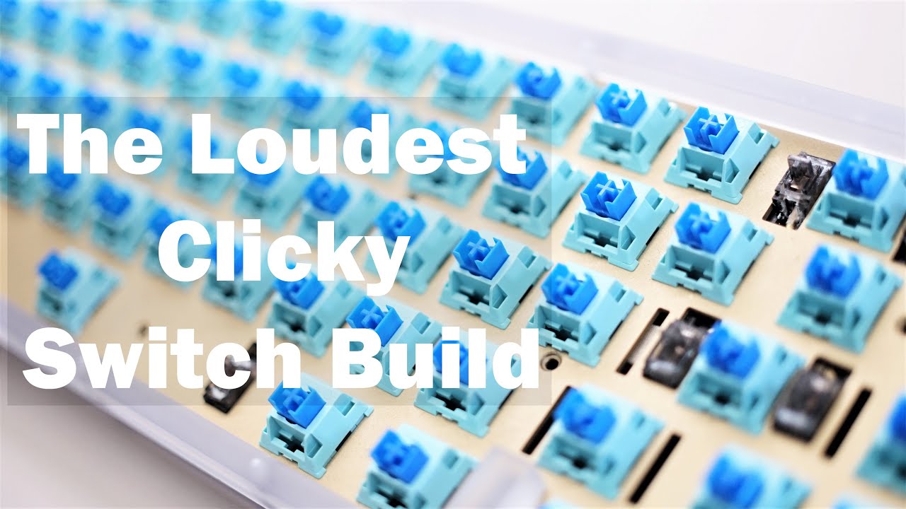

For context here’s the switches Shoobs made:
Is there a difference between Outemu Box Blue and Outemu Dustproof Blue?
Additionally did Shoobs used a box blue rather than a dustproof blue for his build?
