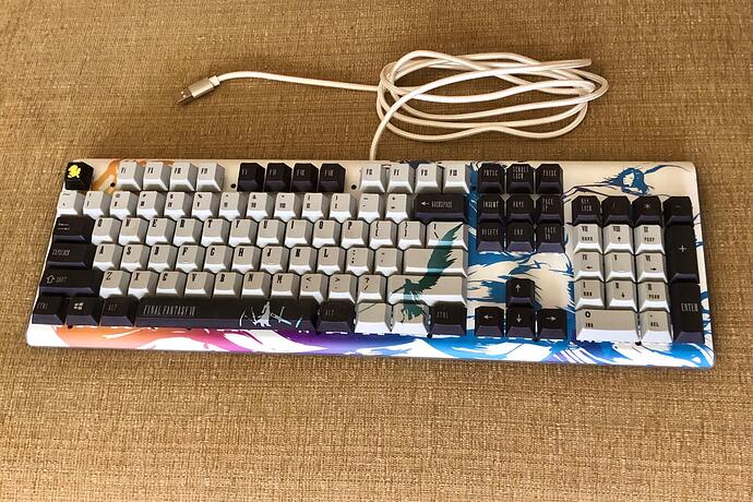

I built this for a friend a couple years ago, and used laminated car wrap material with air release channels in the adhesive.
I got the print from a local sign shop using a file I’d prepared - most sign places also do vehicle wraps, or can at least produce prints with the material. The lamination makes it a bit harder to work with, but also makes it resistant to abrasion and skin oil, so I highly recommend it for keyboards. The air release channels in the adhesive prevent bubbles - vinyl without them is cheaper but not worth it IMO.
As for the wrapping process, it works just like a car - so any given tutorial online for wrapping car parts (say, rear-view mirrors with their curves) should be informative for the process.
The above example is an outboard design; that is, the switch plate is also the top case. That made it easy to wrap, having curves in only one axis and otherwise being flat - but - I had to hand-cut all 104 switch holes after wrapping the plate - and that was not a fast process. Due to the stretchy nature of wrap material, I don’t recommend trying to get it pre-cut like you might see with console skins, which are made of a less stretchy material not intended to wrap around complex curves.
It’s a very manual process that can be pretty challenging, but if applied properly, the wrap will last for years even in pretty harsh conditions - and of course the other bonus is you can print literally whatever you want on the stuff. If you do go to a sign shop to have a wrap printed, I’d let them know the print is intended to be viewed up close and ask them to please use the slow / high-detail setting at 300 dpi - most of the time that material is used it’s printed at a high speed / lower detail because of the large size and intended viewing distance. Fine for a van, but that will look pretty meh on a keyboard.
