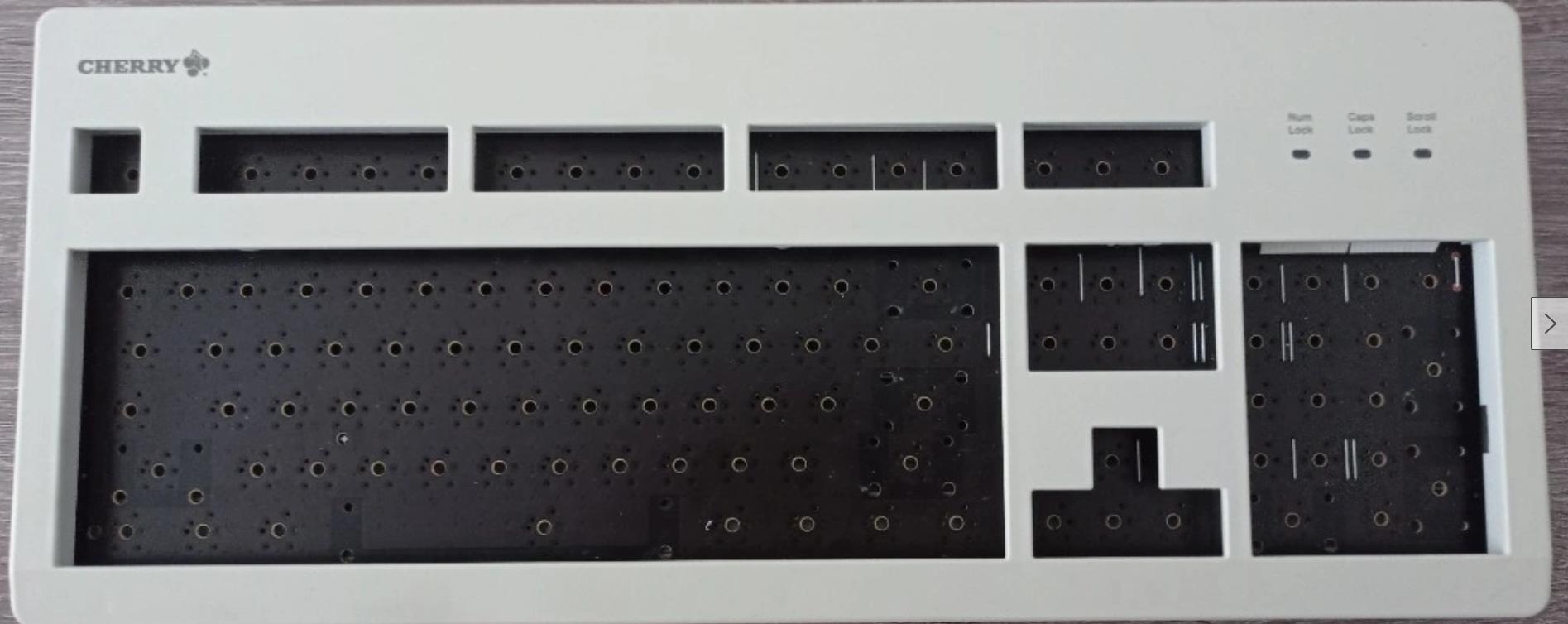

Hello guys,

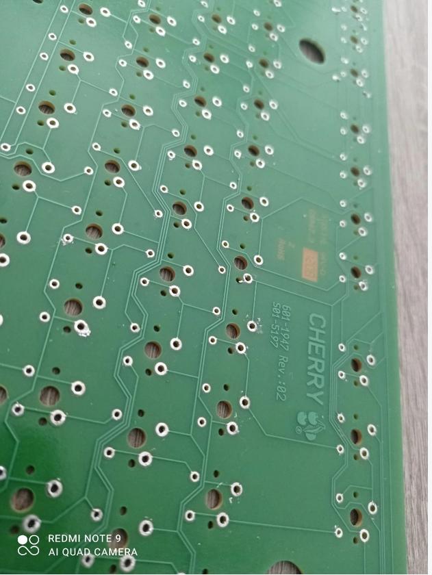

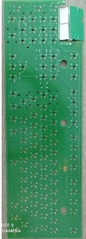

I have stumbled upon a case with dissoldered switches and I was wondering if it is worth buying it and giving it a second life. It’s available localy on sth like craigslist. It’s a cherry G80-3000. No switches but the stock keycaps come with it. Could you guys share your thoughts on this project and provide me with some information about this keyboard.

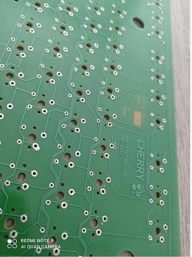

Also are you able to tell if the PCB is working just from these photos?
Can you request that the vendor verify the pcb is in fact working? That would be my biggest concern. Aside from that, it sounds like a fun project!

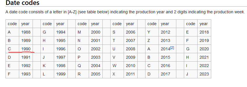

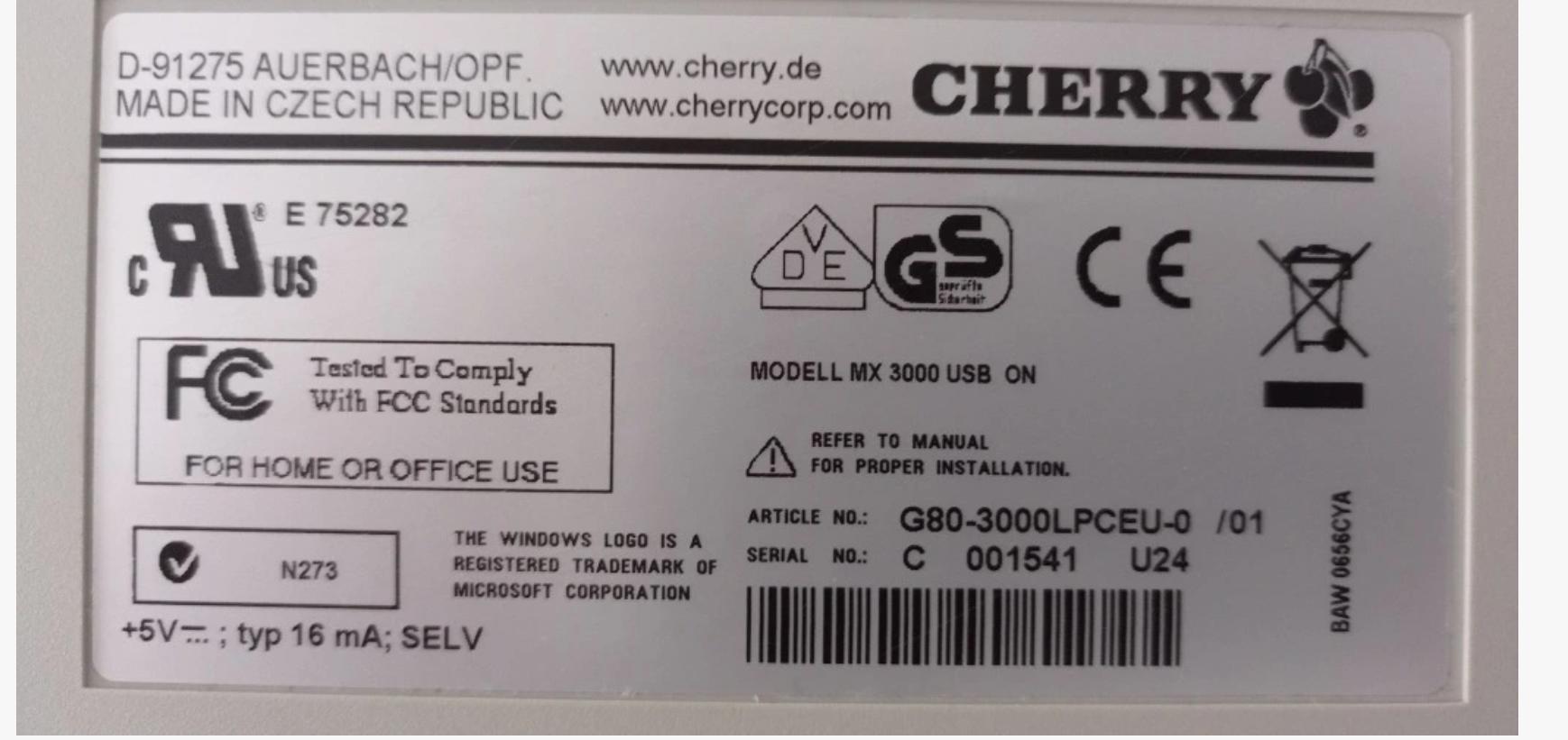

Judging by the serial number (it starts with a “C”
and the information I’ve found I can say its from the 90s. Am I right?
Yep, I second checking with the seller if the PCB is fully functional. And if they say they don’t know, assume it doesn’t work. Also, these are common boards, especially in the vintage keyboard world, so if you really wanted one, there’s probably a deal out there.
It’s from 2008 and has cheap lasered keycaps. So not doubleshot keycaps. If you can get it for $20 it might be worth it as a fun project, but don’t except any resell value more than the value of the switches

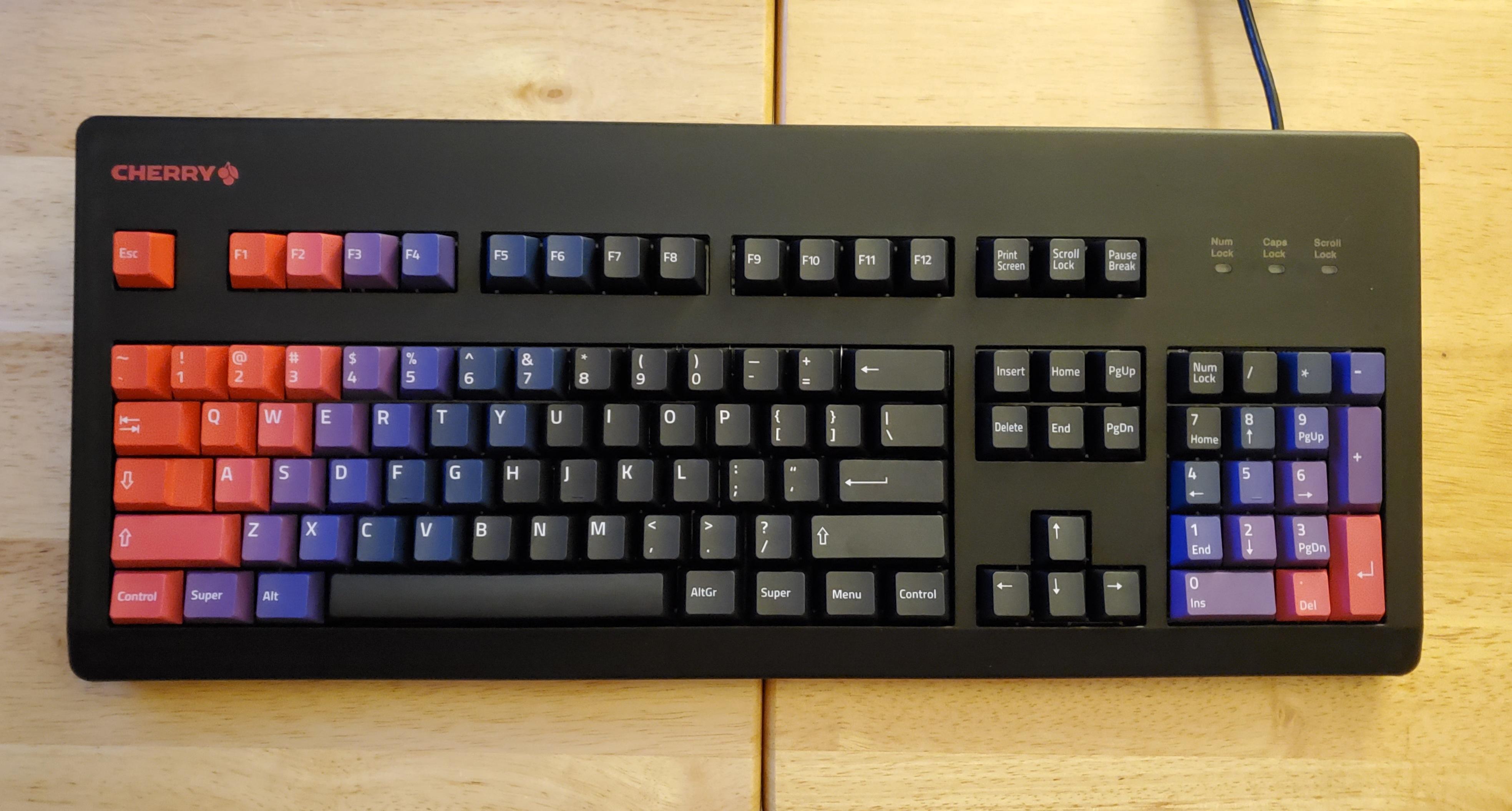

If the seller can confirm the PCB is working & the price isn’t outrageous I’d say it’s worth grabbing. Like was said before it isn’t an OG Cherry board, but that would only be a let down if you were specifically searching for vint blacks & OG doubleshots/dyesubs TBH. IME these boards make for a very nice typing experience & actually sound pretty decent with tuned switches, stabs, & a piece of shelf liner under the PCB to wedge it better between the case halves. Here is a pic of a very similar project I did awhile back.
It was a modern G80 that came with silent blacks. I swapped the springs & stems to make them a light normal linear, lubed & filmed the switches, replaced the stabs with Durock V1s, & put a piece of shelf liner under the PCB. Turned out great!
Here’s what the Deskthority wiki says about it: Cherry G80-3000 - Deskthority wiki

Offhand, I wouldn’t think it’s worthwhile. The PCB’s desoldering doesn’t look the cleanest and the most valuable component would’ve been the switches that are no longer available. If you’re keen on the retro look, a kit like NCR 80 would be a better option
Oh ok. I’ve made my mind up and I’m not going to take up this project. The guy is asking way too much for the keeb and also thanks a lot for the recommendation! I’ll defo have a look at it. Cheers!
