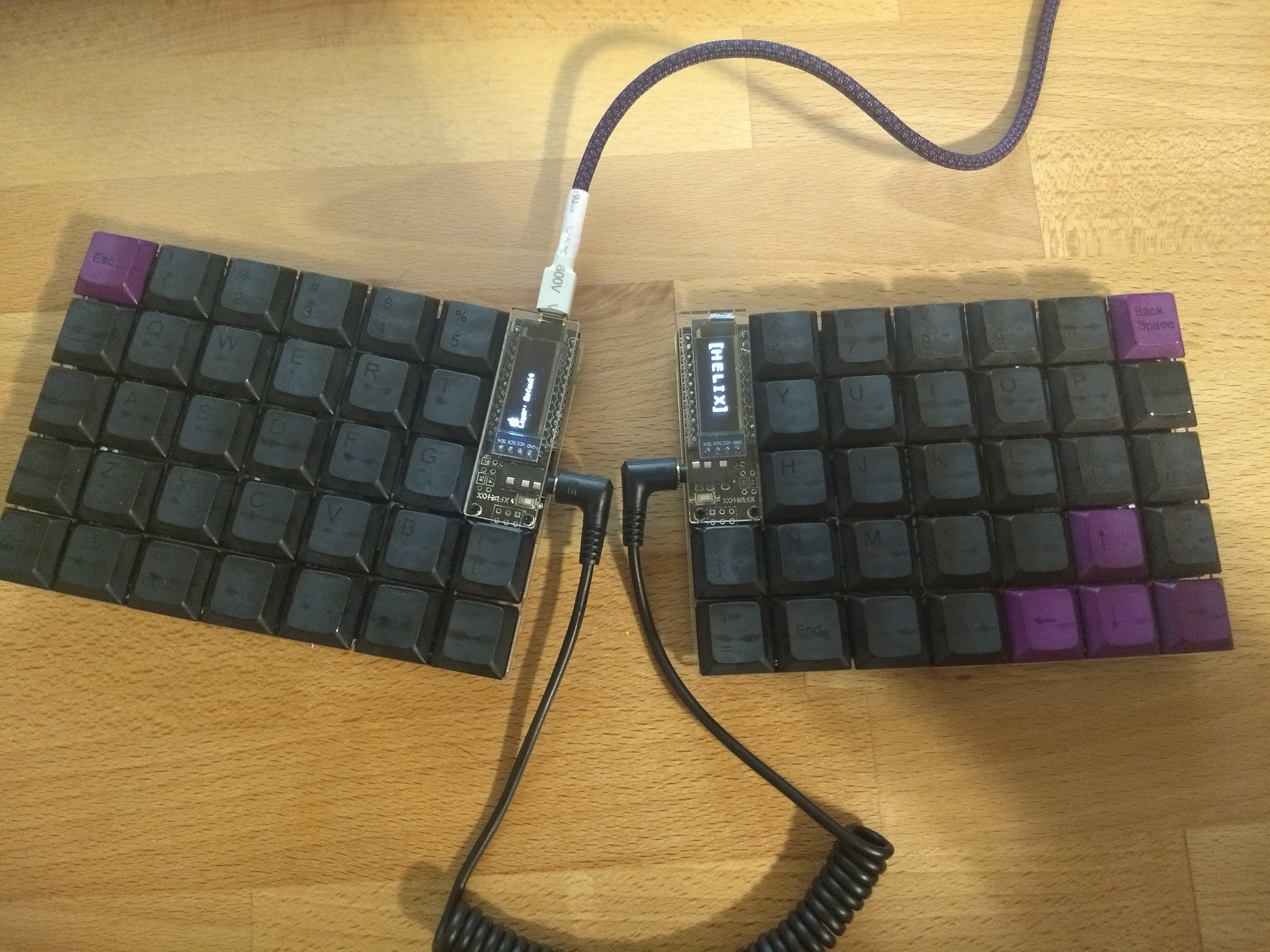

Wanted to thank @woodkeys for the plum cap idea, here’s a potato pic of my Helix with dyed plums, will take a better pic when I get my custom cable completed.
Are you using Kailh Blues or Reds?
Blues, really interested in trying reds though, I wonder if the low profile only works because of the click.
Hi! What low keycaps are those? Do you have a link? Or what keyboard? Are you using the chocs or the low-low profile ones (mini chocs)? Thanks. I have been unable to find keycaps like the ones that you are showing.
Thanks!
