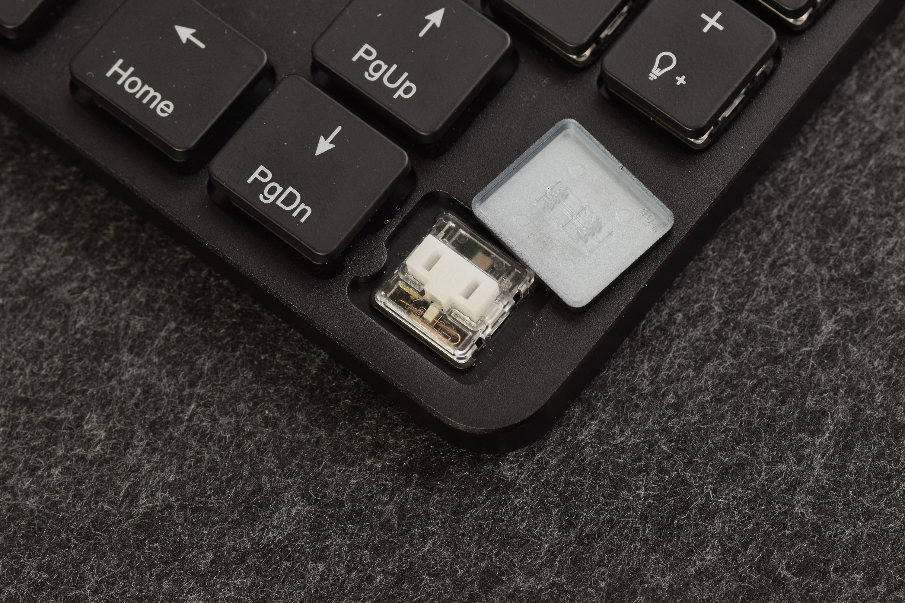

June 30th, I won a coupon code to try out the Havit Low Profile keyboard for a hefty price of $6. At this point I’ve only own a keyboard with MX Browns, and what I didn’t expect to happen is to love these low profile switches so much that I lost all ambition to even look at MX keyboards anymore.
So far, the keycap legends haven’t shown any sign of wear, but the keycaps are in the early stages of developing a shine. I really wish we could get some funds together to create molds for PBT, I think the upstroke resonates better due to the double stem keycap design, and its has wonderfully simple stabs that are very silent and from what I can tell the only sound difference comes from the upstroke with larger keys having a lower pitch. I really wonder if the stabs are special for Havit/Dareu because oddly enough there have a special top house just for the switches with stabs that have a slot to snap the stab into. Seems odd to me that Kailh has made two separate molds instead of just putting the stab slot on every switch. I just love how I don’t need a keypuller to take the keys of, its so simple and easy to clean the keyboard.

Kailh Choc low-profile switches use a different stem, and generally when you’re using low switches you want low caps too. Here’s an image of the stem:

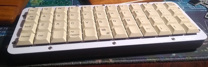

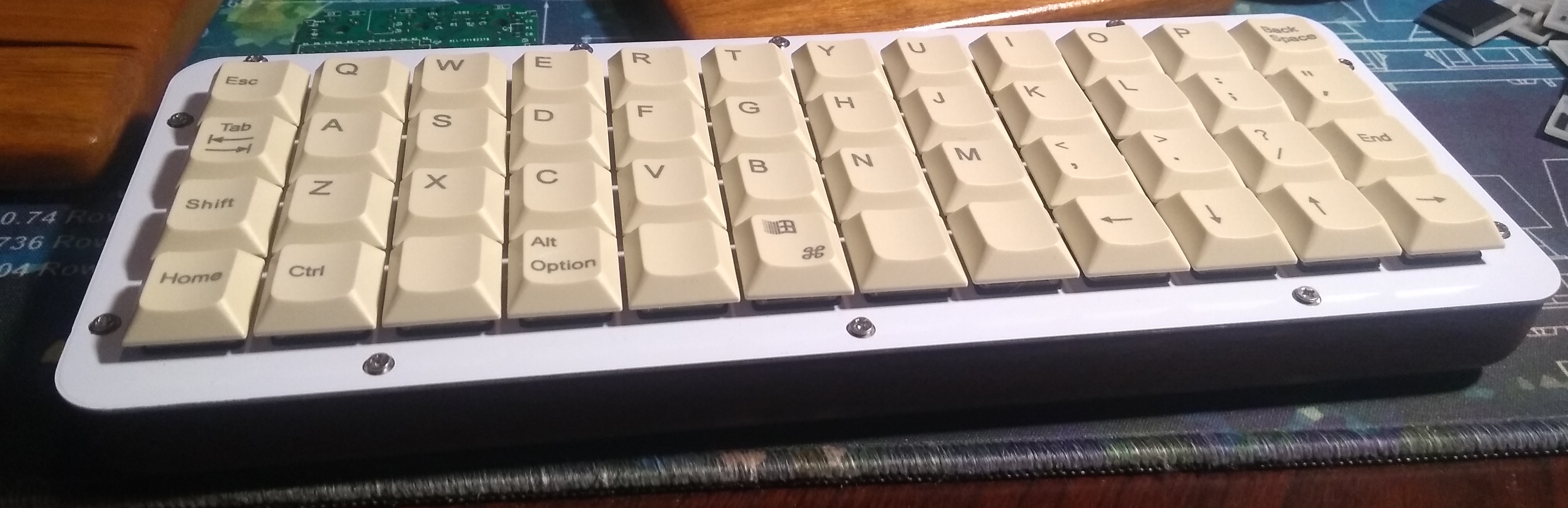

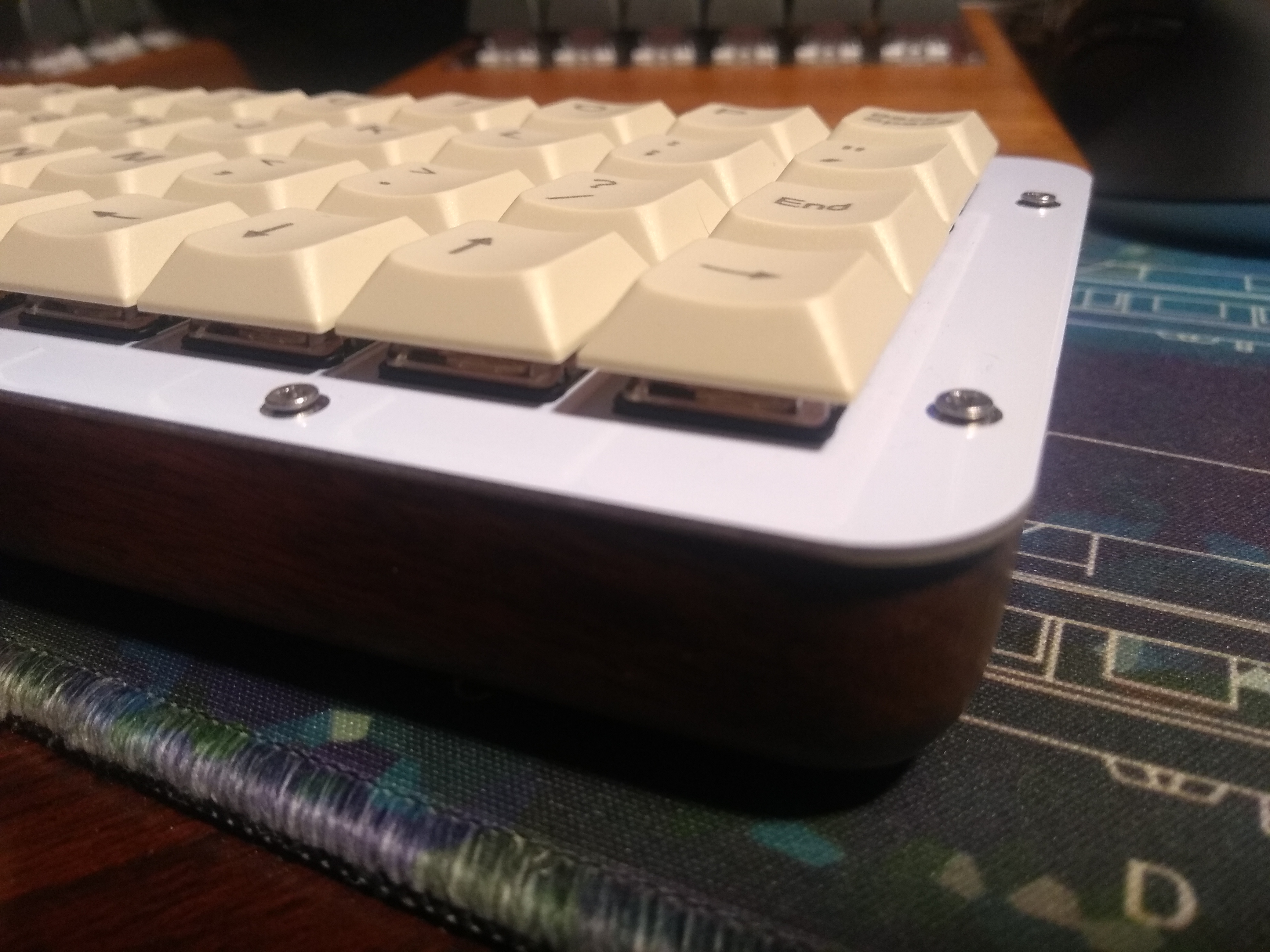

I have used some keycaps from a plum ortholinear keyboard that uses Cherry ML switches. They are some variant that has a centered stem and fits the chocs. The typing experience is so much better than the keycaps that kailh makes. I would love to see some cylindrical or spherical keycaps made for them. They don’t need to be sculpted, I think it makes more sense to have them all the same height, but having something other than flat would be preferable.
Do you have any photos? I’m curious about what they look like. My partner and I have been discussing custom low profile switch caps for a while, and I’d love to see more options.
Not the greatest pics, but it gives you an idea. You can pick up the plum boards for pretty cheap on ebay.
