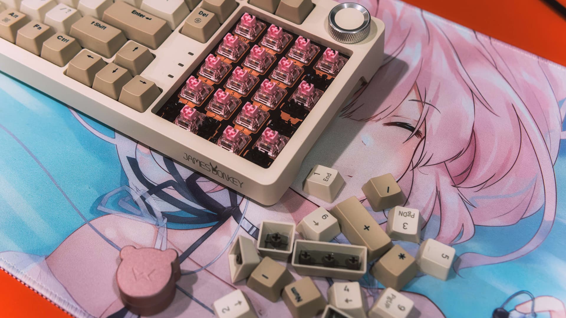

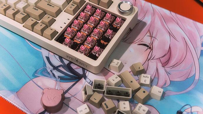

Thankfully, the RS2 is a hot-swap-capable keyboard. The RS2 also has an FR4 plate, which is conveniently labeled with the locations of keys. This makes reassembly of the board much easier and is something I would love to see on more keyboards. I replaced the Gateron Pro Browns with Akko CS Jelly Pinks, of which I jar-lubed the stems and bag-lubed the springs. The board is moderately loud with both types of switches I tried in it.
