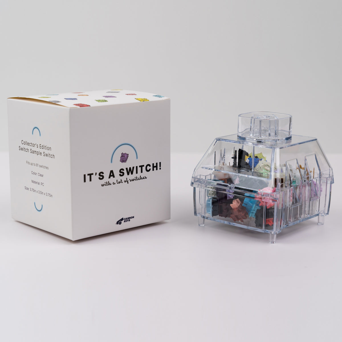

Just learned you can purchase a switch test kit! That seems like a no brainer for me.
Now, can I get a tester with silent switches from different brands?
And does a specific brand tie me to certain case brands?
Where to go to get a tester with different brands?

CannonKeys also has switch sample packs if you want to give those a try and they happen to have a Haimu specific one as well.
Thank you for this. Without having any idea what a tactile or linear switch feels like, it seems like I need to start with some switches to press.
