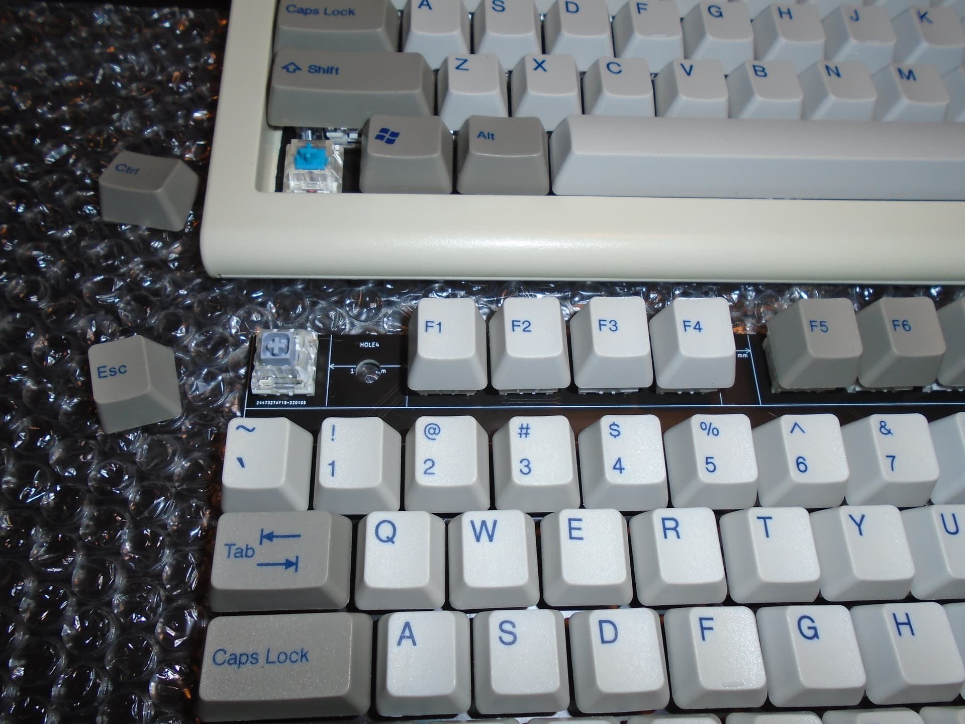

So, my Mute Jade switches from NovelKeys came in and I installed them into one of my QuietKey retrofit PCBS (example of one installed above). Here is my experience so far with them:
First off, there is a tolerance issue with the plastic pins, they are way too small to secure/align the switch properly. The footprint I used holds Gateron and Cherry switches very snugly but these BOX switches just fall out. I used some hot glue to stick the switches to the PCB before I soldered them. It’s so bad that some of the keycaps look wonky since the switches aren’t aligned perfectly. Also I don’t know why they got rid of the drain holes on the bottom of the switch.
The tactility and weight are NOT anything like normal BOX Jades. These remind me more of MX Clear but slightly lighter and more tactile. Not a bad feeling but misleading name. I like the quiet clicky sound too. There is a problem however, some of the switches are inconsistent and feel less tactile than the others.
So Kailh needs to increase the pin size slightly, get rid of the stupid name, and fix the inconsistency issue and these will be great switches.

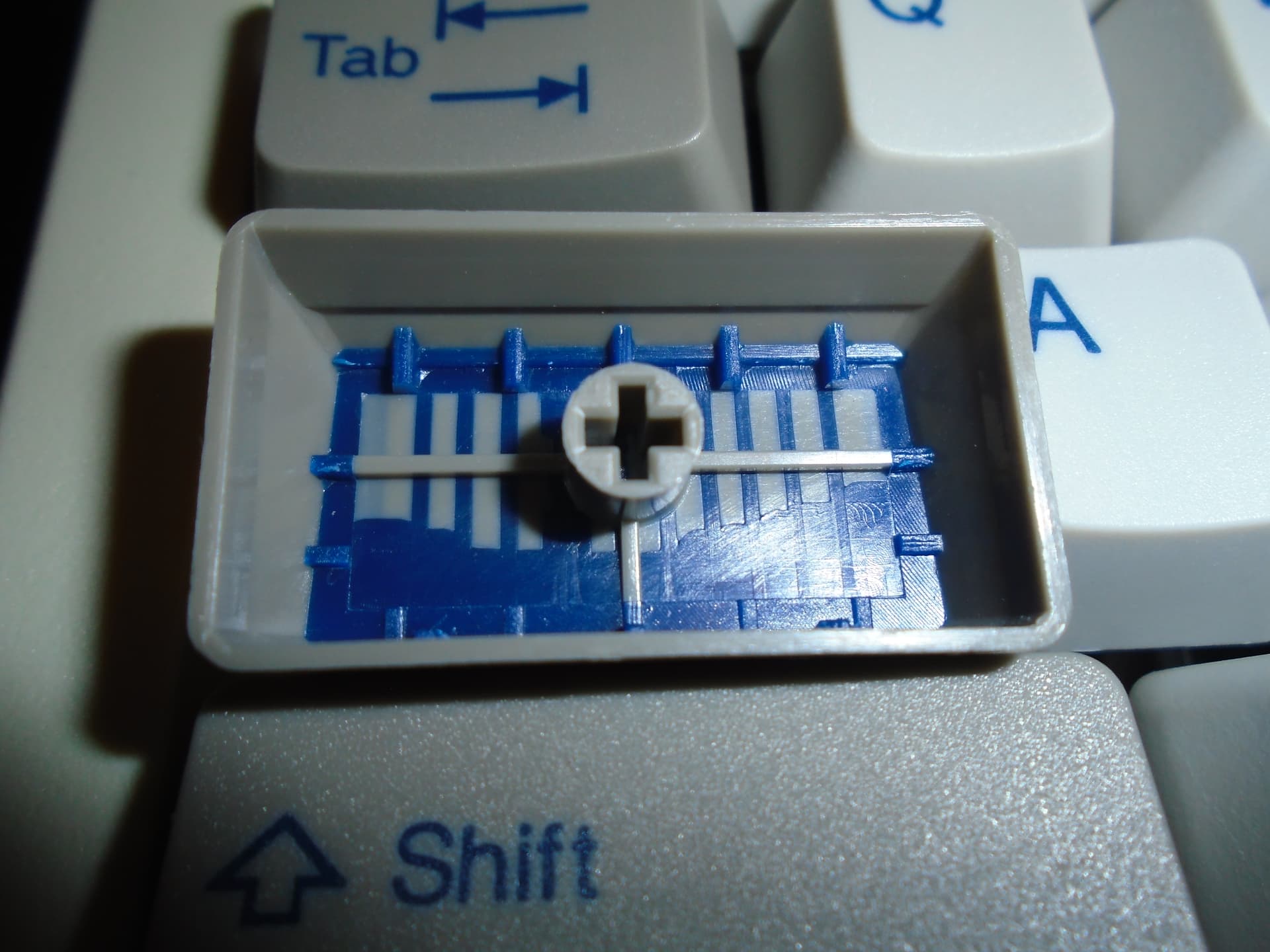

There are some noticeable stretch marks on some of the keys too. Will post photo later.
The stretch marks are very tiny compared to pre-retool BOX switches, but still there. No such marks with other switches on same keycap set.

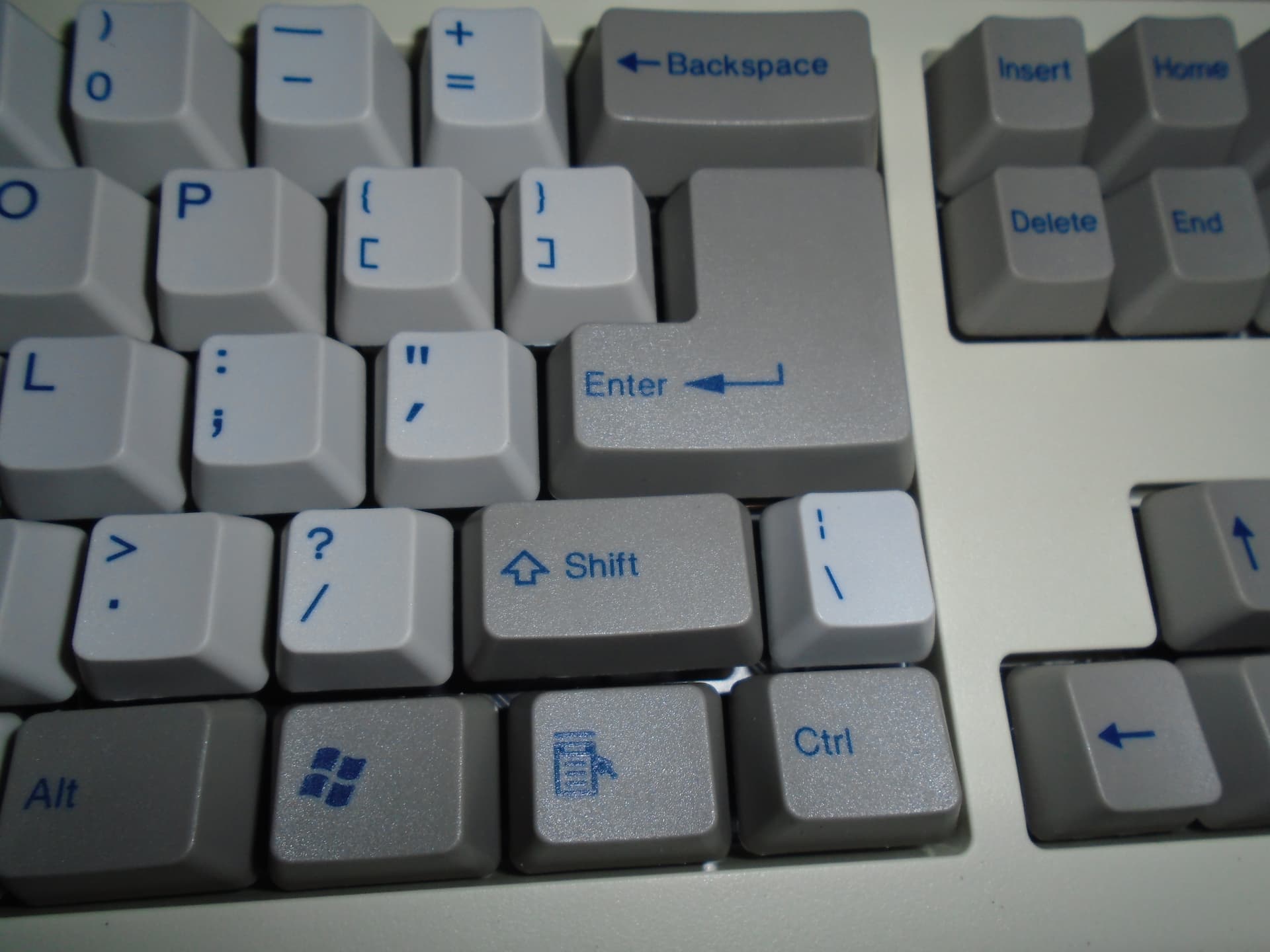

I am using this keyboard right now, it feels pretty good. But not “jade” at all. Reminds me more of MX Clear but more tactile (I sold my MX Clear board so I can’t compare the two right now).
Focus enter is lovely.
