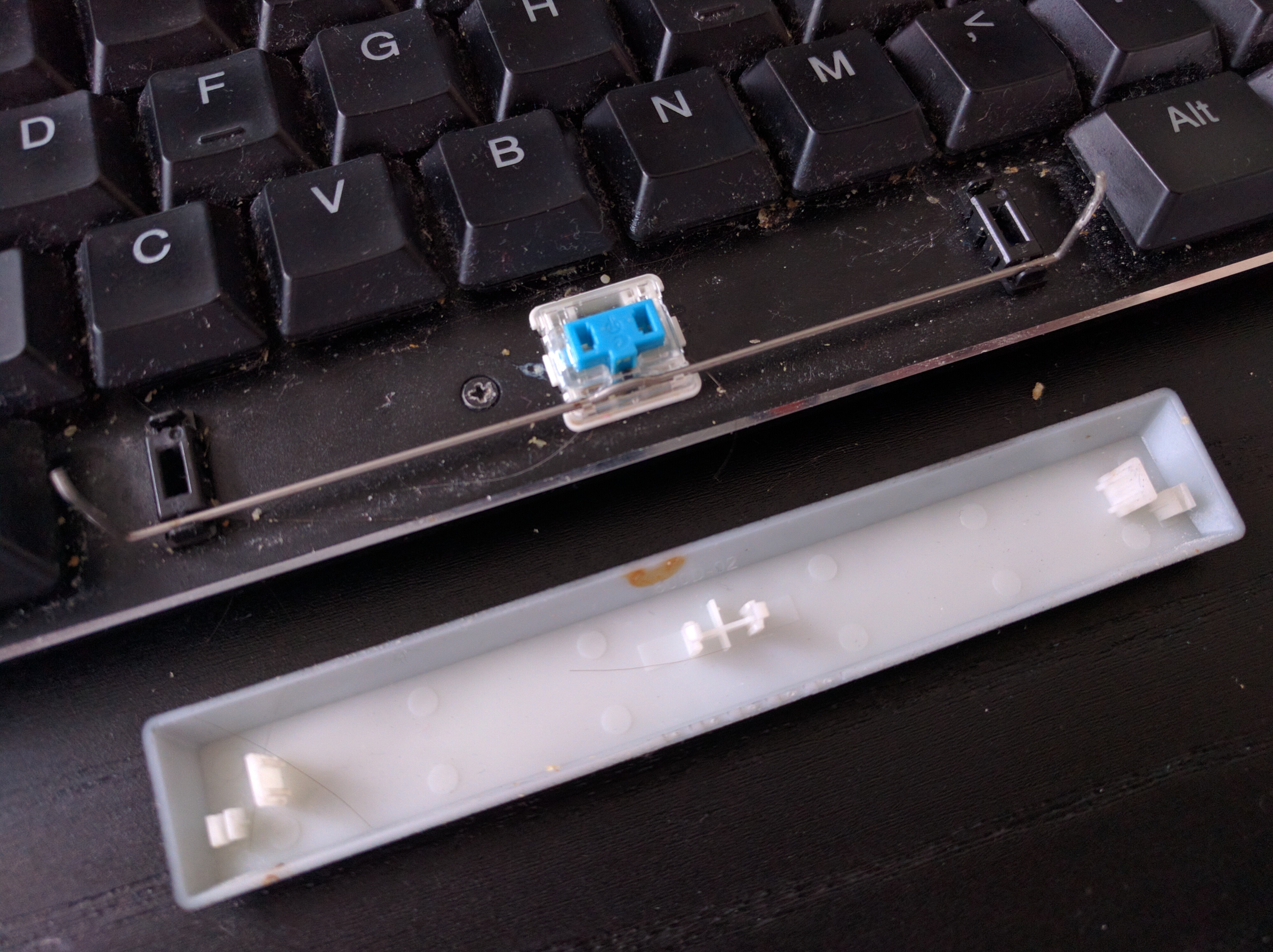

The OEM keyboards use something that I consider incredibly cool: stabilizers built into the body of the switch:
Unfortunately I have no idea how you could acquire the modified switch body or the special caps that this uses.

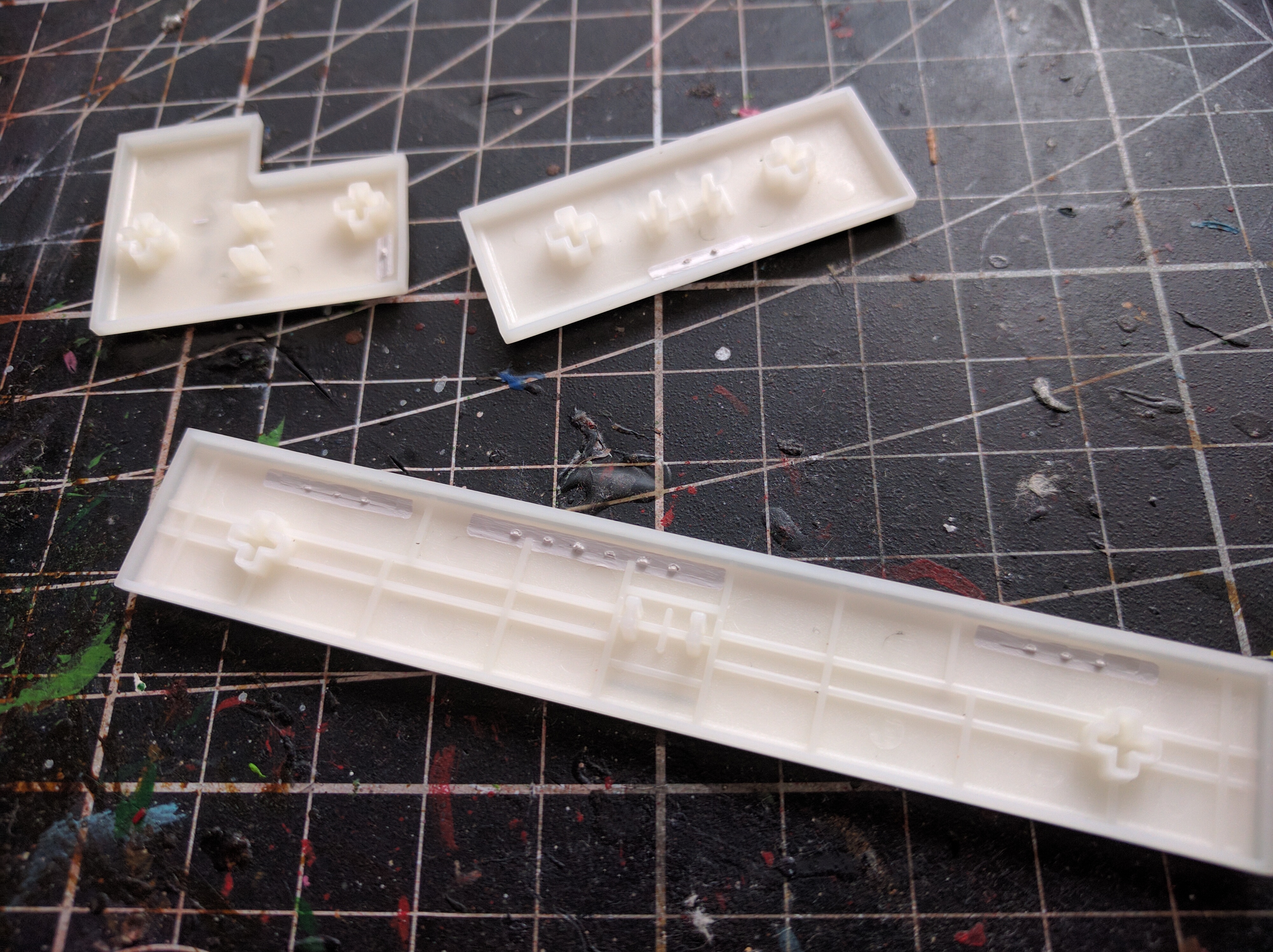

You can always go homebrew like I did with my Flounder keyboard:

Thanks. It does the job. I couldn’t use their stabilizers, because the goal was to be as flat as possible, and the back of the PCB was supposed to be empty.
