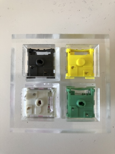

Also, the Noble yellow doesn’t seem to have the hole at the bottom the other BOX switches have. I only have the one switch so it might be a manufacturing defect, though:
They no longer have the bottom hole - it’s a change in the BOX switch design.
