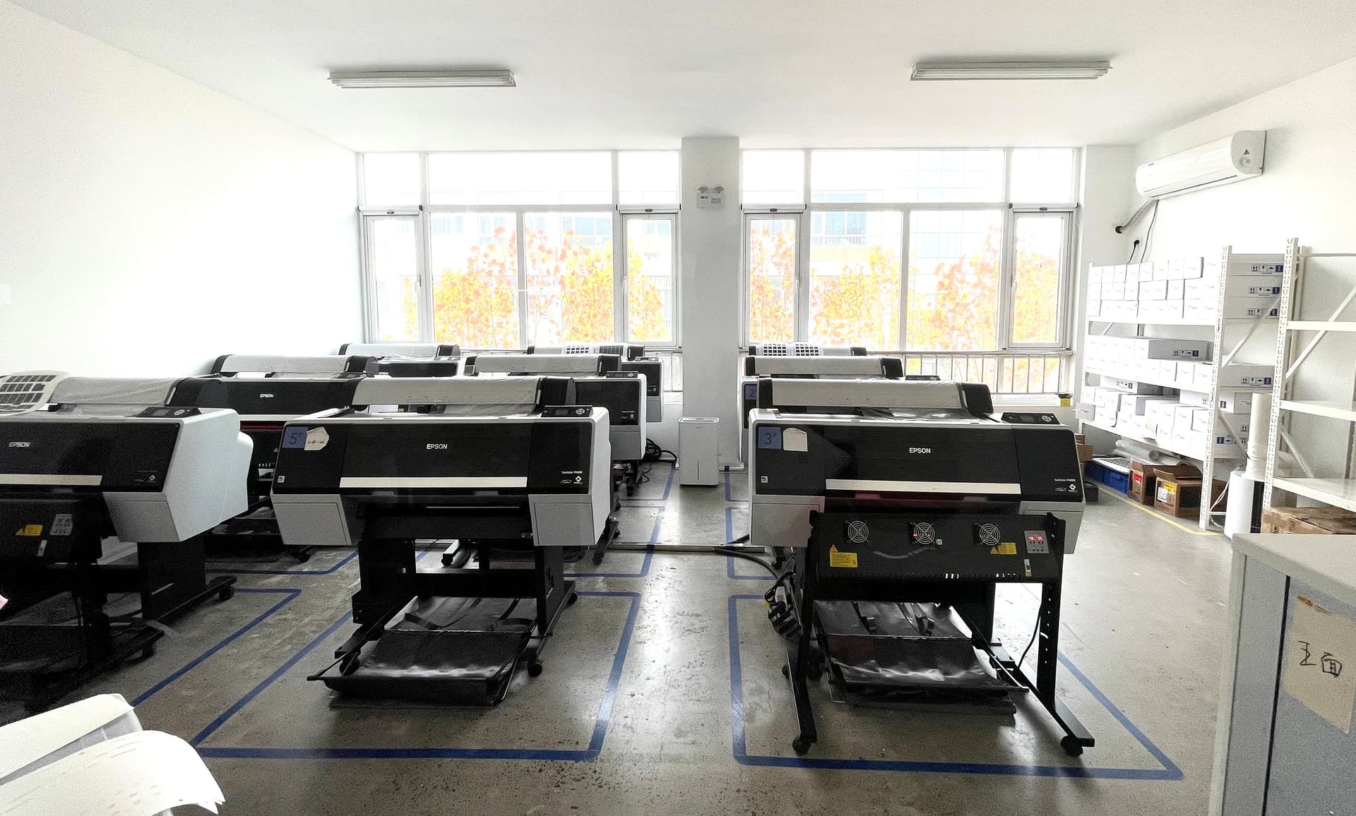

Firstly, we use a piezo inkjet printer to print the dispersion ink (the drawings or legends on the keycap) onto the film;

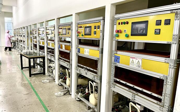

And secondly, we use specialized jigs to secure the film and treat the film at high temperature with our machines to allow the dispersion ink to transfer into the keycap.
There are many variables and uncontrollable factors in play during the whole process.
Although we are using the same model of printers and maintaining a constant room temperature and humidity for the workshop, the printed films would still have some minor color difference.

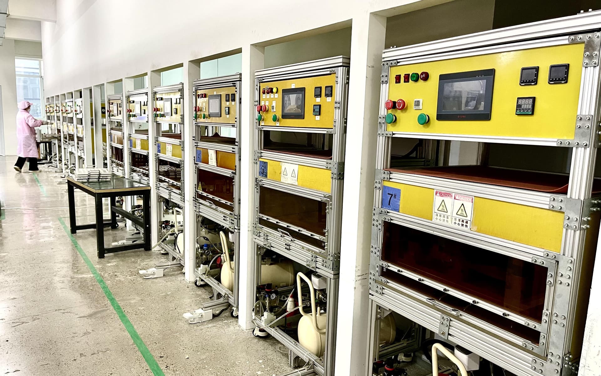

The reverse dye-sub equipment is designed and developed by ourselves. We are able to use PLC to achieve a close loop process to monitor the variables during the heat transfer process. However, tiny deviations will still be magnified as we go through more and more production steps.
Fading and stretching are often observed on the side walls of a reverse dyed keycap. And the follow GIF should help better understand the process. The flat film is heated and sealed onto the keycaps by vacuum. It is stretched 2 to 3 times vertically, and the ink in this area is inevitably pulled apart. Even if we compensate for the ink loss during the pull with computer calculation, it is impossible to bypass this physical process.
And why there often are alignment issues in reverse dye-sub products? It is a complex issue: how tightly sealed is the jig, whether the film can be softened evenly, the flow of vacuum, and other factors will have a great impact on the final alignment.
