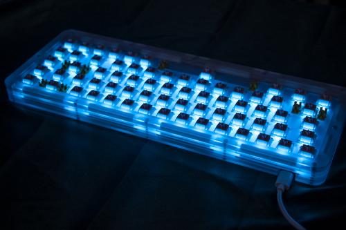

I just saw this from an email. 68 dollars for a Gasket mount Keeb? What are your thoughts? ![]()

At minimum, I’m glad to see manufacturers trying to lower the cost of features like this.
Stacked acrylic does seem like it would be the cheapest way to execute this - does make me wonder how good it would be. The tall-but-flat form factor is one I probably couldn’t get into, but it seems like it at least has some potential.
