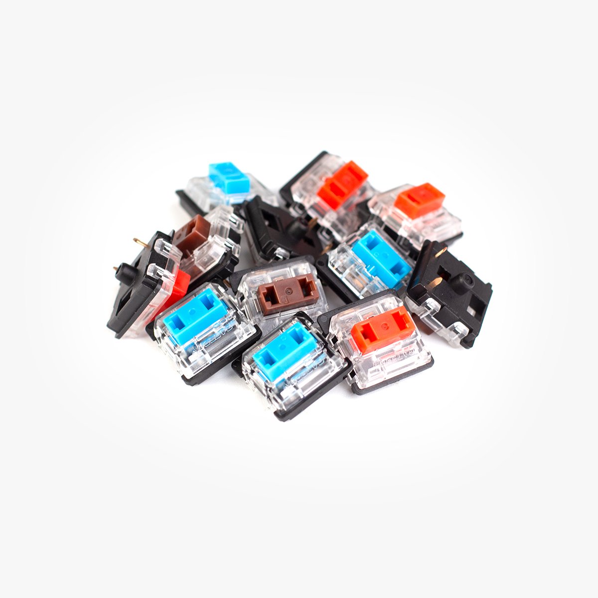

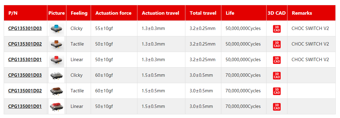

Looks like the V2 switches are going MX compatible.
Source
Hmm, I wonder with which profiles though? I think some stems/keycaps might hit the plate from being too tall and not having enough travel space downwards :thinking:
But if they all work, that would also be hunky dory.
Yes, and I’m not very happy about it, because that makes the whole much higher, which kinda defeats the whole purpose of a low-profile switch.

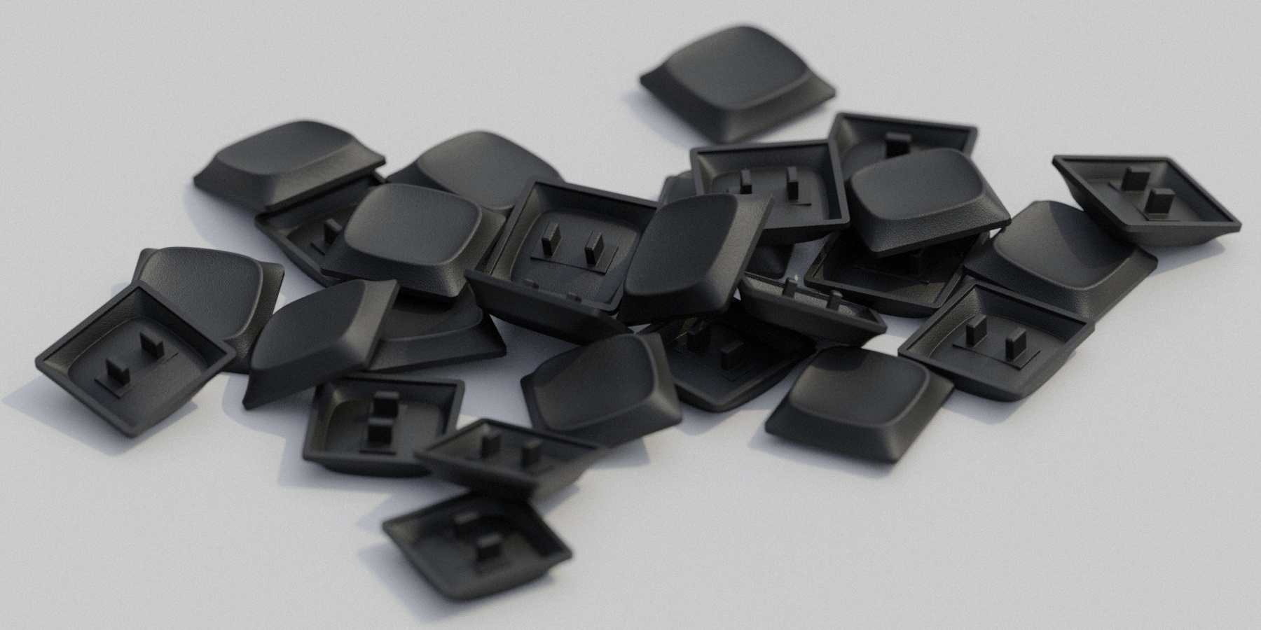

I mean the one thing on my radar in that regard is the Bamboo which is gonna come with the fancy TEA profile caps that are only going to be choc-compatible.
Interesting, looks like the scoop more aggressive then ADA… Not sure I could type on that for an extended period of time.

While the mainstream keyboard media may not be aware of it, this lack of choc keycaps is simply fake news. For quite some time now, MBK profile has been available at my website as well as others. It is very comfortable spherical/flat PBT in black or white, and soon to be, colors. I also stock dyed color options for the flat Kailh caps and clear scooped caps, with more colors coming soon.
I currently have 6 switch options listed and another 2 shipping to me, as well as another 2 in development. This is not counting the heavy options that NK_ created with exclusive rights, or I’d be carrying those as well.
Choc is growing up quickly and besides TEA, there are at least 2 other profiles in the works that I am aware of that we should see soon. That critical mass/catch-22 issue is a bump in the road, now in the rear view mirror.

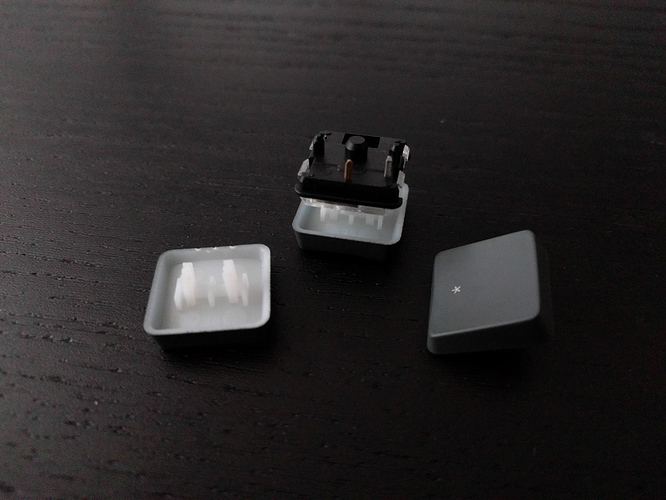

I’m happy to report that the keychron K1 keycaps do fit the Kailh switches:
Phew. Show us a Flatreus with those keycaps!
So there is an interesting thing. I tried to put those keycaps in my HV-KB390L with blue switches, and they don’t fit there - the holes in the switches are too close together. But they do fit perfectly well with the white switches I have in my flatreus. So it seems even the Kailh is not compatible with itself?
Here’s the Flatreus:
Compared to Kailh’s own keycaps, and the TEA ones, those caps are about 1.5mm higher, because the stem doesn’t go all the way up inside the cap, and they are considerably smaller, at 16×16mm, compared to 17.8×17.4mm of the Kailh transparent key caps.
