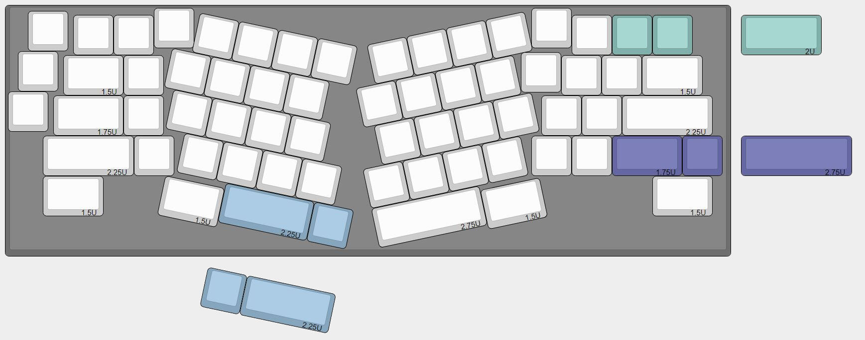

The keycap configurator can be found here.
