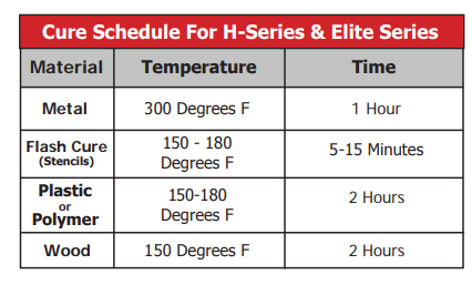

Isn’t the Dell AT 101 plastic or are you talking about doing a Cerakote on the plate? I’m pretty sure the Cerakote process involves baking at high temperature which might melt the plastic case. Metal plate should be fine though.

From what I understand, ABS melts around 210F and PBT around 221F
H-series can cure for 2 hours at 150-180F, so you can use it on plastics.
There was a post a few years back of someone who cerakoted a model M. It looked great. Granted, that is PVC plastic, but the melting point is in the same range.
