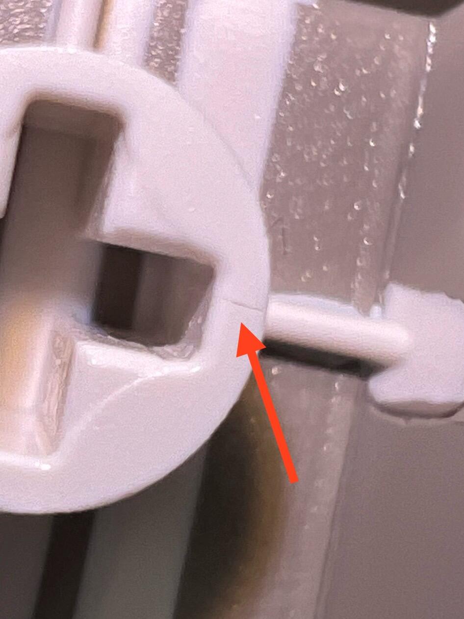

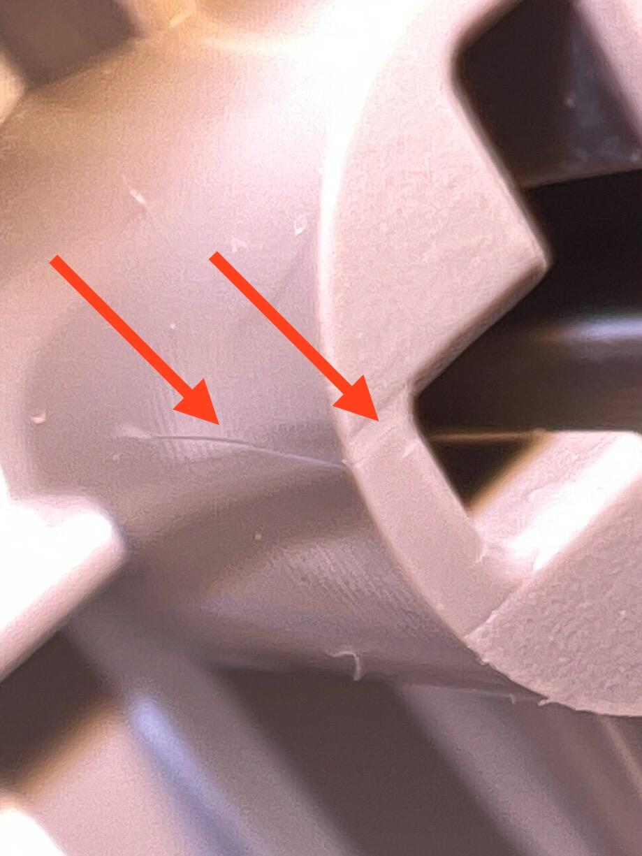

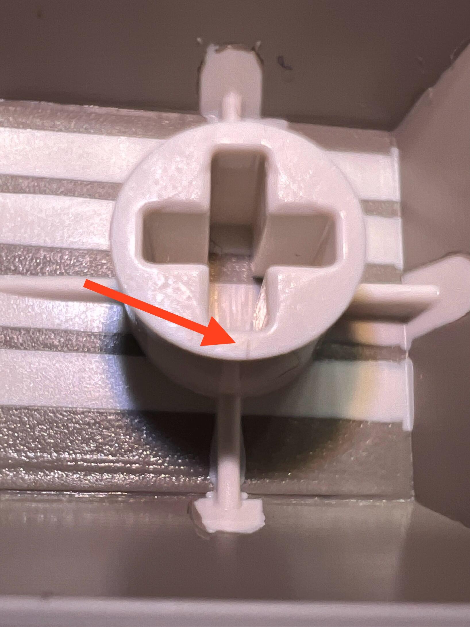

Believe it or not, these cracked about 80% of my GMK Foundation caps. I can only see the crack on a few of them, and they are still fairly tight on other switches, but they’re abnormal. I’m not sure which version I have. I suspect they are the V2 lubed ones.
And the thing that makes me mad is that I’m dumb. I heard them crack, I knew what was happening. But I thought, well, the switches sound good and I like these keycaps so what will be will be.
BUT I OWN A DAMN STEM TRIMMER!
I could have just trimmed them when I noticed (which was after like the 3rd keycap)
I’ve used these switches before but I had PBT caps on them. Oops. They’re almost perfect, but I hear a noise when tying that Im not 100% on what’s causing it. It’s either a spring rattle here and there or just from a wiggle of the stem (fixable usually by more lube on top housing)
I pulled them all back off and used the stem trimmer. Maybe I saved them from being stretched more? lol

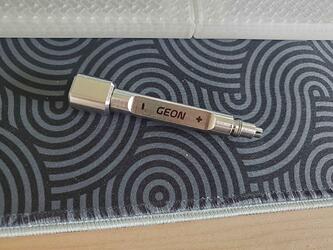

Buying the Geon Stem Trimmer was the best thing I’ve done for this hobby in a while.
No more stretched out caps. I’ve needed to trim all my Gateron and Cherry switches, and some Gats have thicker stems/legs too that make them tough to stick in PCBs and Mill Max sockets (Gat Beers, Gat Baby Kangaroos–had to trim the thicker pins on Kangaroos to fit in the sockets).
HMXs and Oil Kings don’t need any trimming in my experience.
I pretty much run the trimmer on every batch of switches I use anyway now. I just use the trimmer for my gauge on what’s over-tolerance and needs trimming lol.
