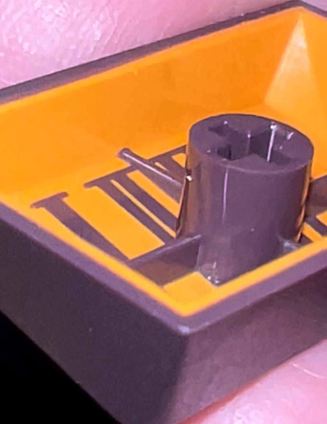

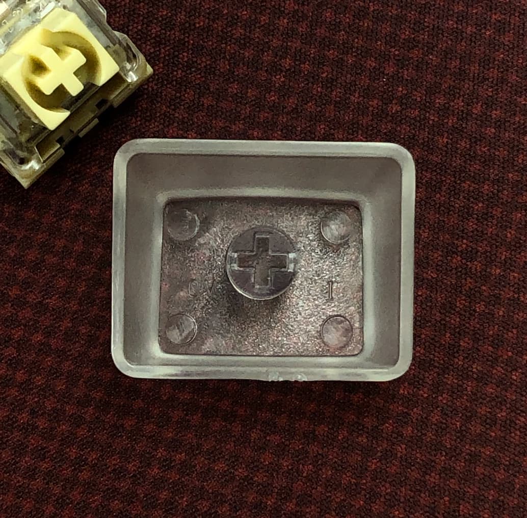

Long story short: I got some BBN Linears in the mail today. These will break GMK keycaps.
Longer explaination. I’m excited to try out these BBN linears. They are those weird ones with a PC bottom and Nylon top. You know… reverse of what you usually see. But I thought I would like them because I detest the high pitch noise on most switches top-out. They are really nice. Nothing ground-breaking, but a nice smooth linear with a decent sound profile out of the box.
So, I put them in my Frog TKL (hotswap) with a PC plate. Got a chance to use my new Geonworks plate fork. It works as intended and helped me get the switches in without issue.
Then I go to install keycaps. I have GMK Thai Tea sitting beside me, so that’s the one I went for. I was about 14 caps in. I kept hearing a sound like they were possibly breaking on about every other switch, but they didn’t feel overly tight. I thought… surely that’s the switches snapping into plate or something. Right? RIGHT??? Get out my iphone and turn on the 3x zoom with the flash on to inspect… yep. Broken stems.

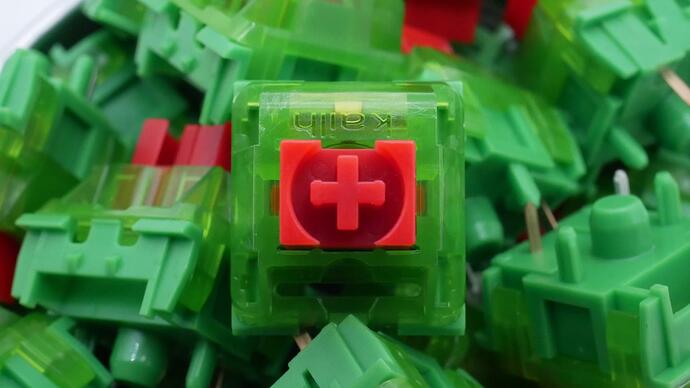

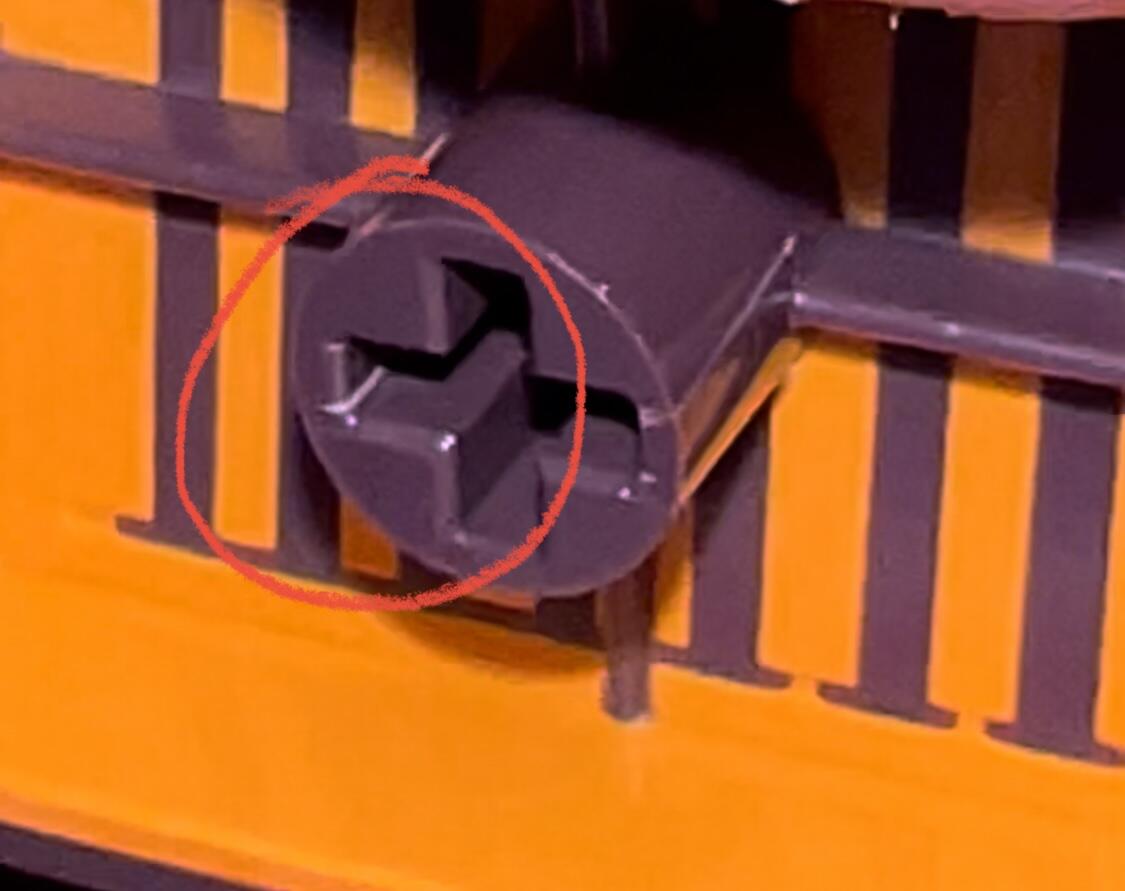

I’d add any Kailh switch with the same shaped stem at least to a “sus” list; I haven’t confirmed it with actual GMK, but I have damaged some cheap cap stems with the FLCMMK Ice Mint and Christmas Tree switches. Great switches, by the way - but sus.

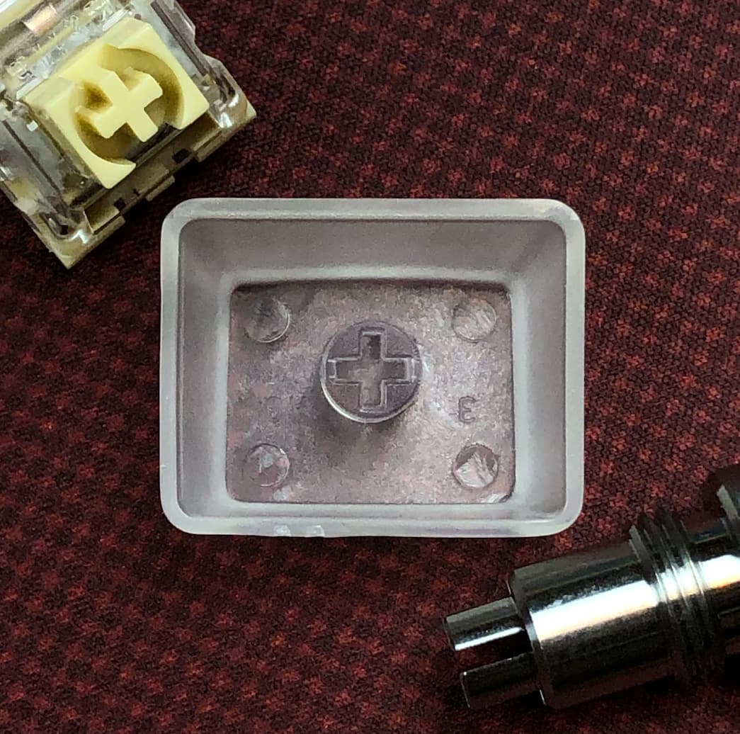

Here’s a close-up of a Christmas Tree by ThereminGoat, straight-on one of those stems:

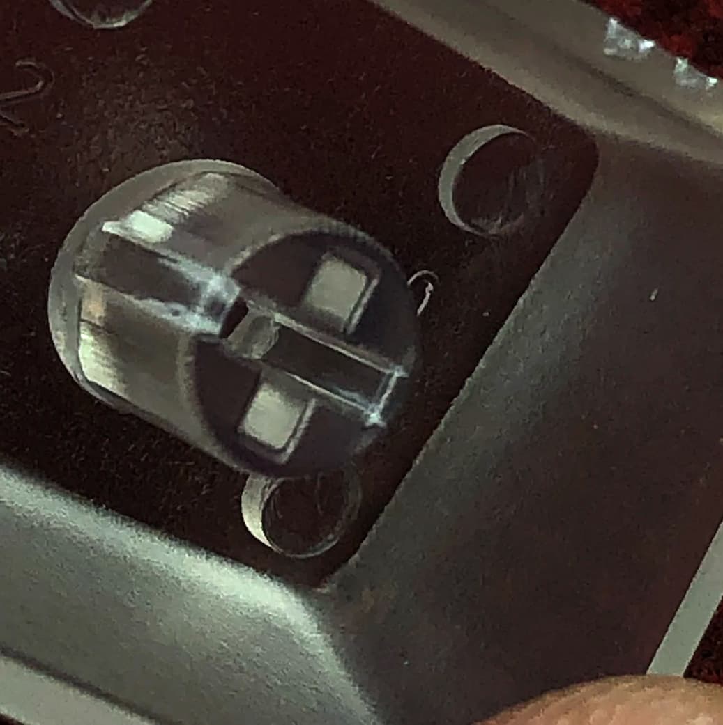

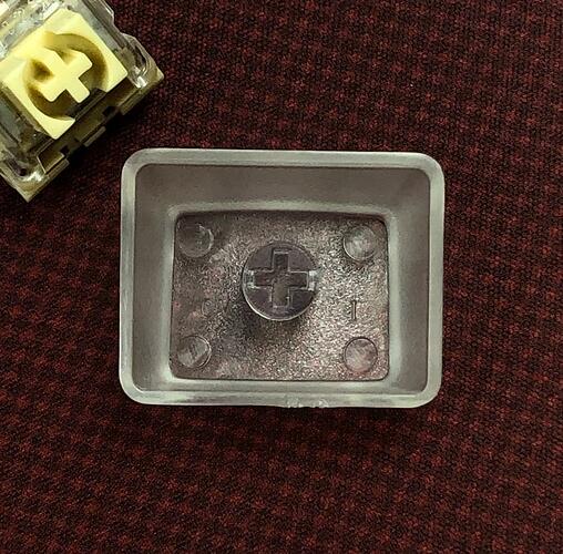

Now here’s one after being mounted on the same switch, but after it’s been run through a specialized tool called the Geon Trimmer a few times (a couple links in the next summary):
Still some light stress marks, but nothing scary. You might be able to see the plastic forced out of the way by the tool at the base of the switch stem. (Caps aren’t likely to touch that; just to show the tool has in-fact moved some material out of the way.)

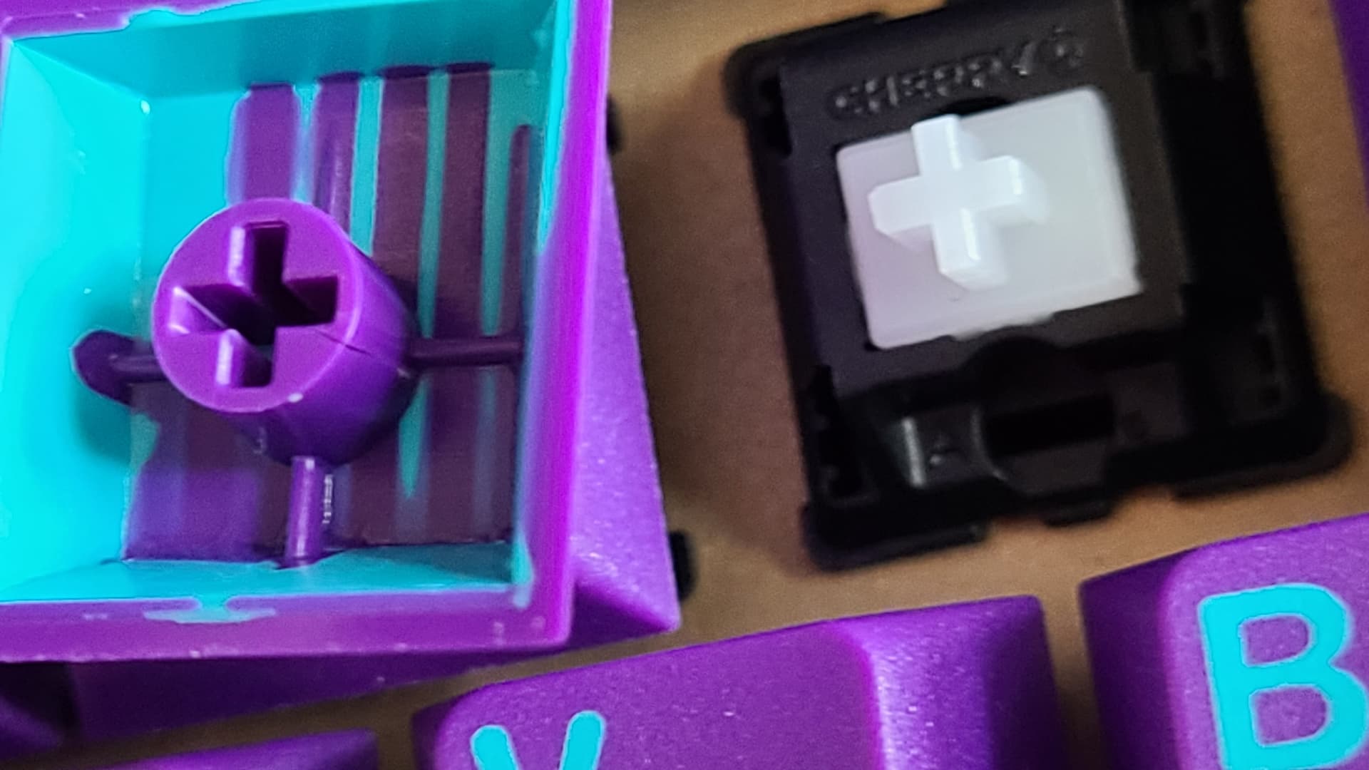

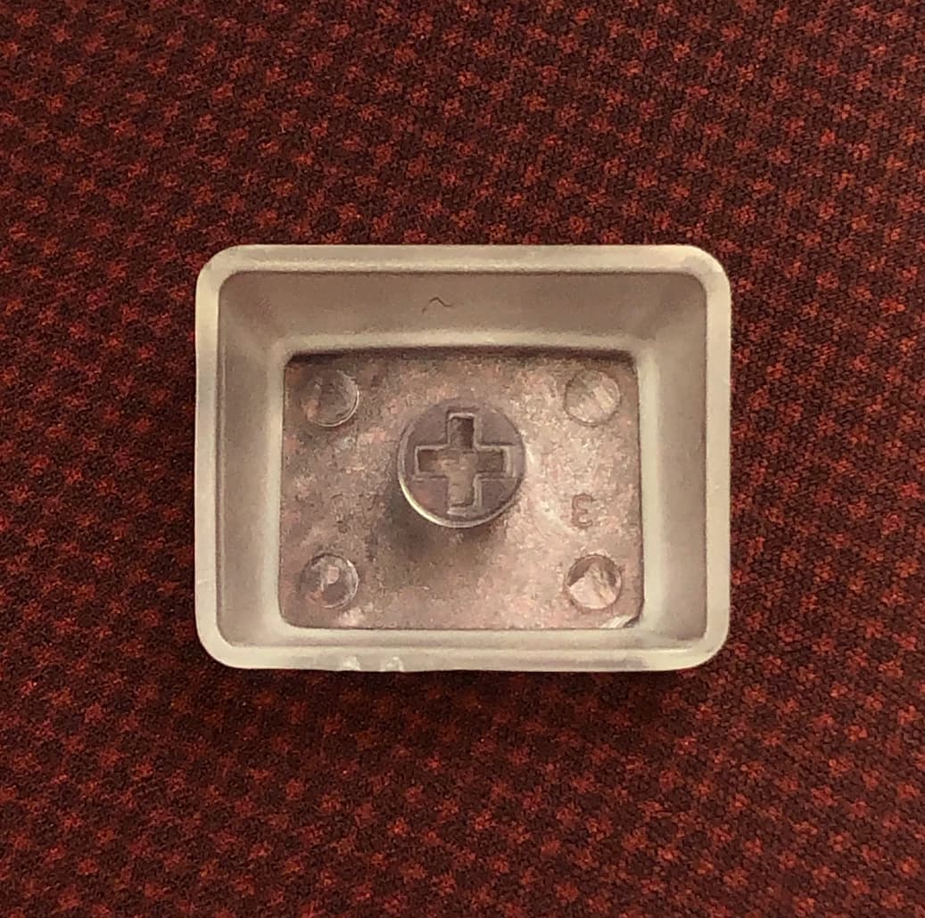

Official Cherry MX Ergo Clears cracked one of my GMK keycap stems and stretched a few others out. I put GMK Mitolet on Mekanisk Ultramarine Switches v1 without a problem, but as soon as I put them on Ergo Clears I heard cracking noises. I know original Clears have been known to crack keycap stems but I was surprised the new ones did as well. I did however put SA Oblivion v2 keycaps on the Ergo Clears and there did not seem to be an issue.

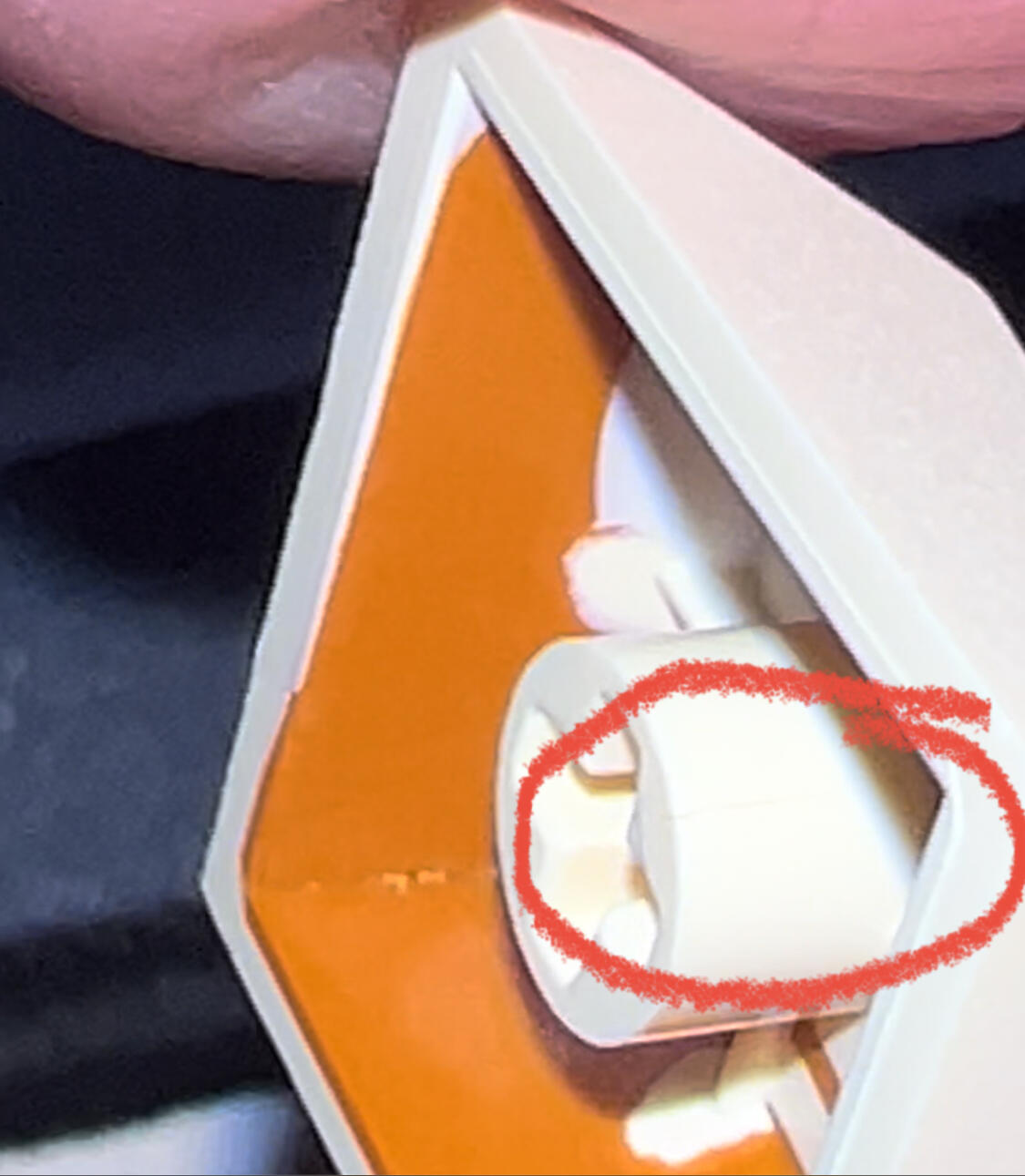

Tecsee Blue Sky tactiles for the sus list. They aren’t as bad as MX Clears, but they still have enough of a death grip that I’m not getting them near good caps.
Kind of a shame since they’re otherwise good tactiles with a nice feeling 2 stage spring.
