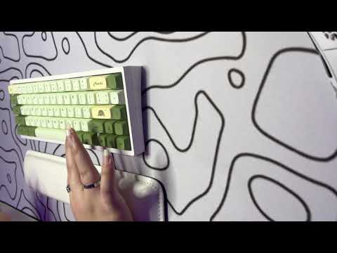

Okay, there are a few sound tests on the internet:
unlubed
lubed
lubed with 205g0
https://www.reddit.com/r/MechanicalKeyboards/comments/s1vk07/new_build/
The last video, 205g0, is from 10 days ago. Videos only started to become available around late December or so.
Anyone, I only know about 205g0 as a confirmed lube so far. Comments from users suggest that leaf ping is the culprit for some of the weird noises. So it’s looking like lubing around the leaf area. I don’t have experience with that, though. Are there any suggestions that can guide me?
