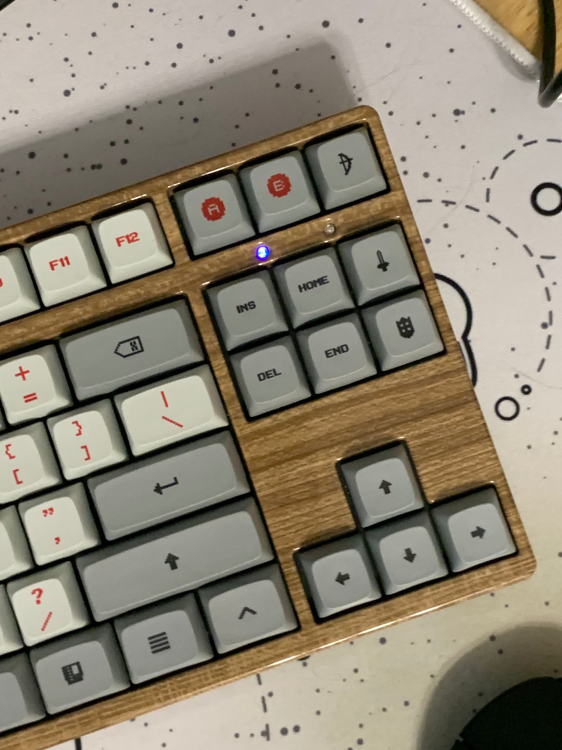

I put purple LEDs in mine a few years back and just did an LED swap (didn’t change the resistors).
granted, this photo makes them look blue still, but it’s a much more pleasant and softer purple. Red would look a lot better with the current setup, but it is what it is.
